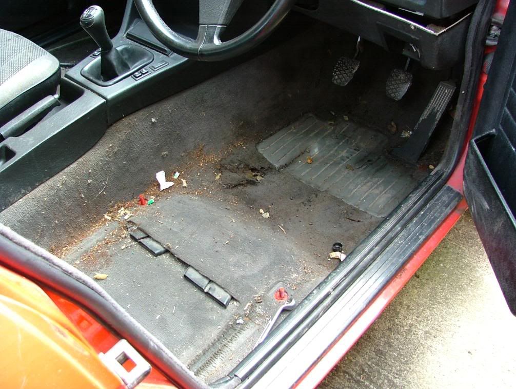

So, knowing the interior is utterly minging, I thought I would get the front seats out and the carpet, which I am replacing as it is utter scum and I will be needing to get up behind the glovebox area to get the servo and master cylinder off, so I got stuck in.
First of all, out come the fart blast driver seat
Now you can see the state of the carpet and the years of filth, found £2.72, so now the car cost me less than £130 and also found 4 brand new Bosch spark plugs in the glovebox :)
Notice the "wet" appearance of the carpet which never ever dried out, I suspected some other fluid leak.
Once I started pulling the carpet up, my suspicions were confirmed, clutch fluid :-x This had been nicely soaked up by the foam backing and the paint on the floor was bubbling up in places, grrr. So I started attacking it with a scotchpad.
But the result is undoubtedly that the floor of the car is very very sound, no signs of rot, apart from some minor surface rust where the clutch fluid had started attacking the driver footwell
