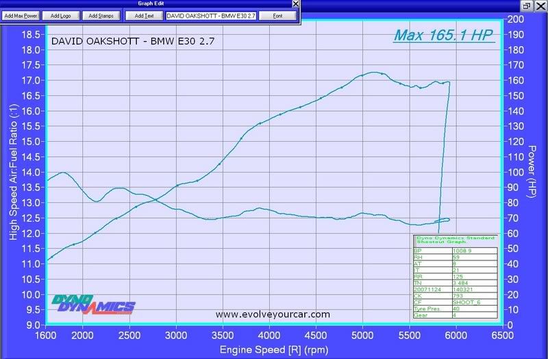

I'm pretty sure Oakeys car won't be far off 250hp.
Bexleys built with M/S and ITB's.

but isnt oakeys an eta bottom end?
kinda confussed as to what builds what best etc.
