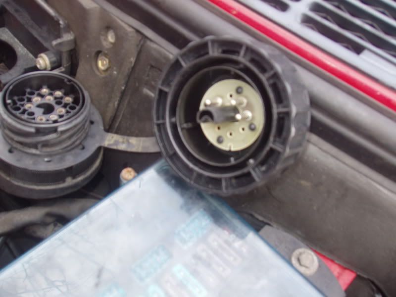

Do I also need a 325 one of these (I think I do lol) or will the 3.5 one do? Is this a coding plug? I presume so

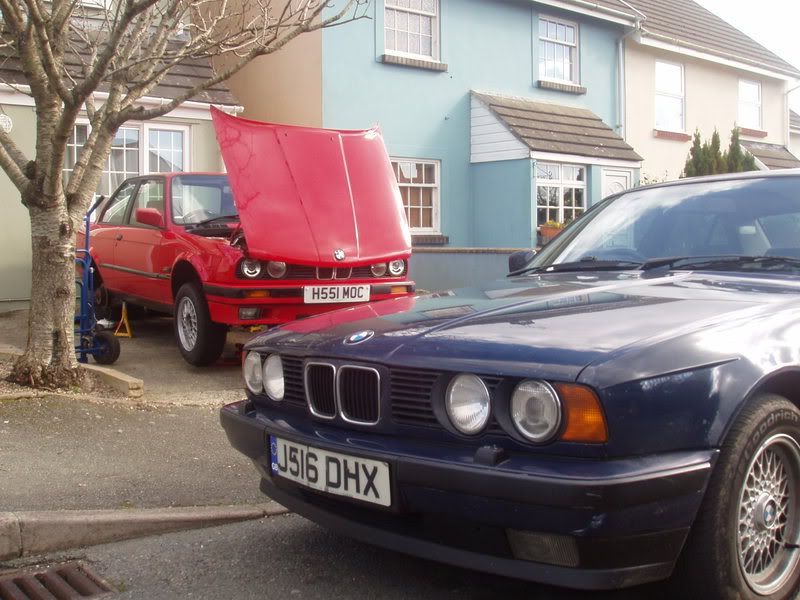

also a pic of them, the 5 is my daily drive until the weekend I swap the engine then the 3 will be.

E30drifto wrote:Do I also need a 325 one of these (I think I do lol) or will the 3.5 one do? Is this a coding plug? I presume so
This is the engine diagnostic connector and cap, and should have remained attached to your iS engine and have been removed with it! It's part of the engine loom.
Only coding plug you need is a small white plug that fits into the front of the instrument cluster. Normally hidden behind a piece of trim.

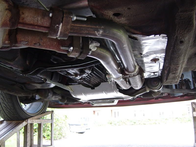

With regards to the exhaust, I'm currently using a full 325 system with the M30B35 downpipes chopped a little.
Chopped M30B35 downpipes
Chopped 325 downpipes
I've had no problems at all.

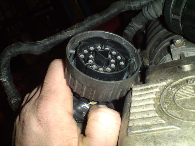

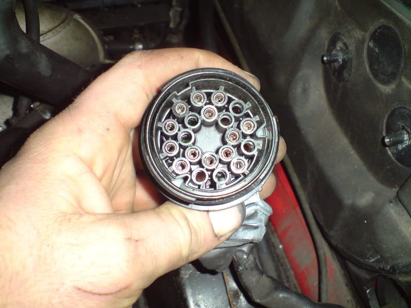

Fitted the 3.5 today everything went to plan except the wirring :-x
The plug that comes of the body of my e30 Is a female and the plug on the engine loom is female,
I really need this thing running tommorow has anyone come accross this?

318is Body loom
e34 engine harness plug
everyones build that I have read says they are plug and play, so whats going on here?????????

there are 2 similar plugs and your trying to plug wrong 1 in thats the diagnostic plug. try the other 1

Im 99.9% certain I cant plug the wrong one in because the diagnostic one Is also female!

Both mine and my friends m30 looms, didnt plug into our e30's loom, we had to chop the plug off the m30 engine loom and wired it into and e30 engine loom plug, we robbed off our old engines.... I got all the wire colours and pinouts off the net, abit of a pain but no too hard...
We put this down to our engines been out of late spec e34/32's 92>
