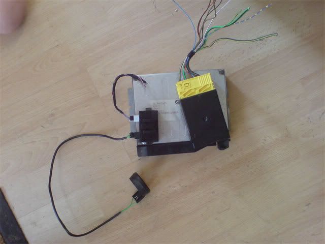

You need the EWS unit itself plus all the plugs, transponder unit, loop and key. I think that's it.
No idea where the EWS is, I guess N/S, whereas the transponder and loop are in or near the column shroud.

Well, on mine the EWS ecu connector (X1659) pin 4 connects via the X20 to the Motronic pin 66 (enable signal). Also (X1659) pin 13 goes to (X1660) transponder unit pin 1. The other wires to connect to the X1659 are perm live to pin 5 and ground to pin 7.

You need the following parts:
EWS module (see below)
Main engine ECU
Small transmit/receive module (size of a match box)
Key
Loop aerial
The EWS module on an E36 is found behind the glovebox.
The transmit receive module is found on the other end of the green wires running from the loop aerial on the end of the ignition barrel.

The only bits that need to be matched are the key, ECU and EWS module. The other parts can come from any E36.

You need the chip that's coded to that EWS module, or you need another EWS module that comes with a matching chip. You really need the matching ECU, although it is possible to align an ECU to a different EWS module. I've yet to get this to work though. You would really need to fit the parts in an E36 328, and then do it.
If you are on very good terms with your dealer, you may be able to get them to order you a replacement key (complete with chip) for the EWS module you have already. The VIN number on the ECU is enough info to get the correct one. They usually want to see a V5 and proof of ID though, so not always possible on a converted car.

Does anyone have a picture of all things including the loom, EWS related please?

There is a pic of the parts on the first page tomson, everything except the key, I think the loom is part of the main harness so just snipped a decent length as there are only three or four wires needed to unlock the ECU and start the engine
