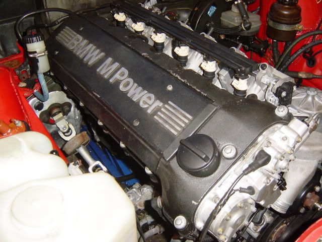

Well, best laid plans and all that. I took the head off yesterday and to cut a long story short, the engine was beyond help. So I couldn't just look at it could I?

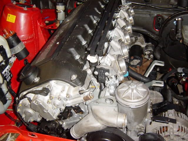

I bought an S50B30 engine and gearbox a couple of weeks ago 'just in case' this moment should arise! The engine came with the gearbox attached and on a pallet. So I whipped the M20 out of the touring this morning, dropped the prop and ancillaries and prepped the S50 for fitting.
I gave the engine bay and the new S0 a serious treat with the steam cleaner first.
I had to remove the S50 sump, fit a new M50 E34 item with E34 pickup, remove the baffles and refit the whole thing. I also removed the oil pickup bracket from No. 3 main cap, removed and welded the oil pump sprocket and tightened the oil pump bolts.
All was going well until I dropped one of the sump bolts into the gearbox :banghead: so, off with the gearbox, remove bolt and refit gearbox.

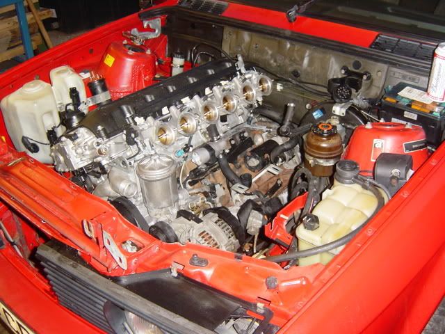

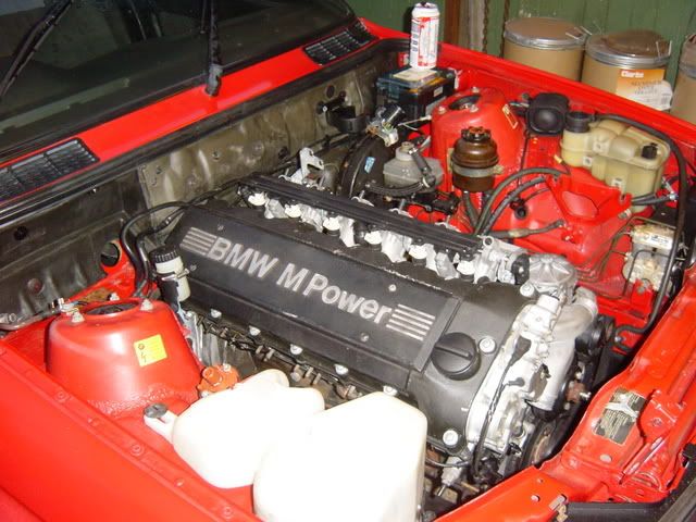

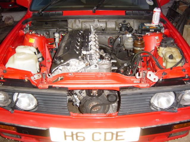

After a lot more prodding and pushing, refitting this and that. This is how it stands tonight:
Not bad for twelve hours work eh? My aim is to see just how long and how much an S50 conversion can cost, so I'll be logging all the time spent on it and also the total cost.

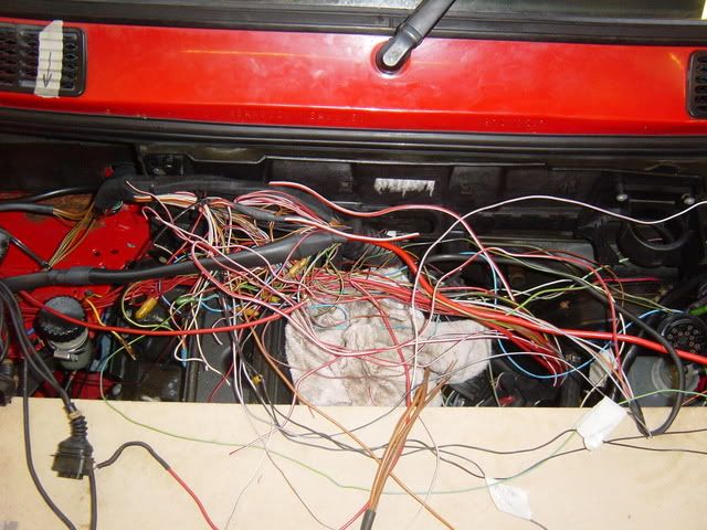

Right then. Tuesday was spent getting the oil cooler pipework finished off and starting the wiring.
The first wiring job I had to do was to refit the wiring loom to the engine as it had been removed when they took the engine out of the car :( Still, it was a chance to explore where everything goes I suppose! If the engine is taken out by anyone "in the know" then the loom is left on and the ECU and the X69 and X20 plugs disconnected.
So, the wiring....... Well, where do I start. It's not a five minute job.

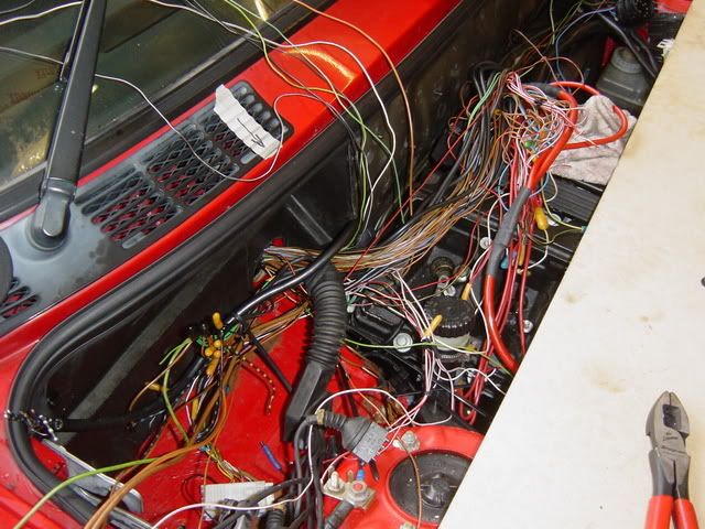

I had decided to use the 4 cylinder wiring covers to get my hand in for the main event, my blue restoration project. I can definitely say now after exploring all the options that this is the harder route; or it was for me anyway. If you are afraid of a soldering iron then don't even think about it either way. One thing was for sure, I was desperate to try to keep the ECu and Vanos controller on the drivers side of the car and that meant a bit more work.

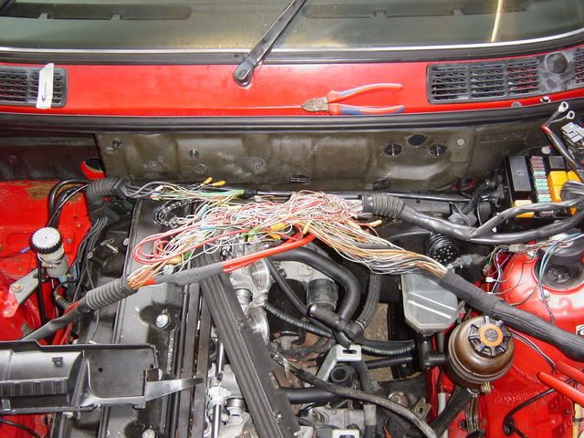

I started by picking the loom out of the E36 wiring box and generally getting a feel for where it all goes. When these looms were originally assembled they were done by building the loom in layers; I came to the conclusion that there was a lot of wiring that was redundant by means of duplicate lives and earths so I could save some space there with some careful trimming and soldering.
This is the loom as it comes, still in it's E36 state:
And:

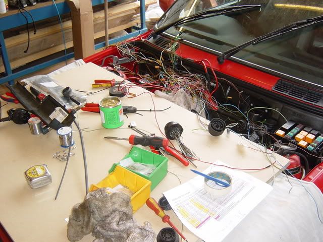

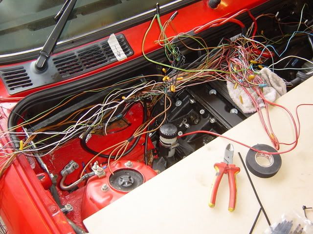

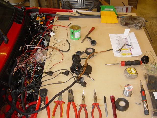

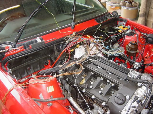

This is how it progressed:
The board over the engine bay was a great idea. It kept all the kit level and was more comfortable to lean on than the engine. It also kept things tidier.

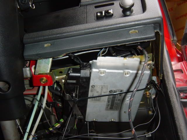

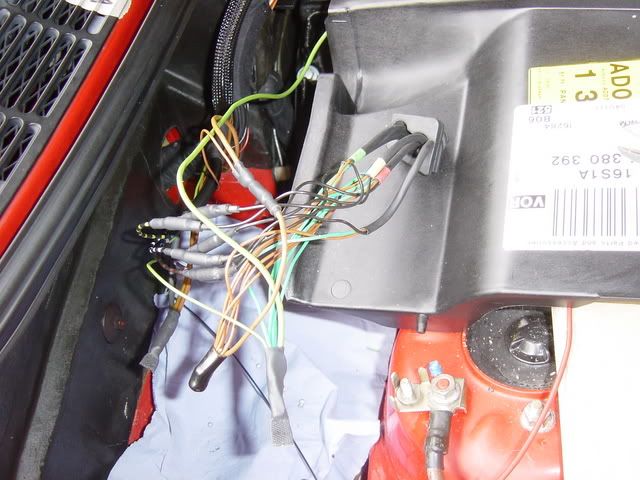

Now here, I was in trouble :mad: I had to cut and rearrange the trigger wiring for the coils to gain the movement to get the ECU into place.
Coil wiring drilled through the back of the 4 Cylinder battery tray/bulkhead cover:

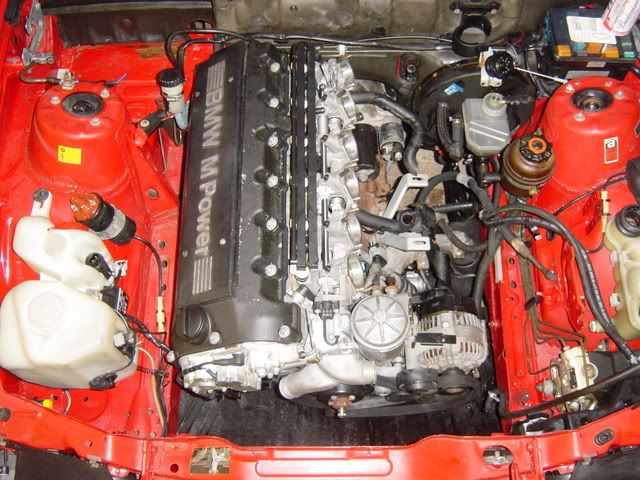

Engine ECU roughly held in place. I have enough slack to pull this around so that the plug is facing forwards with no strain on the wiring. The vanos controller will go in here as well. The EWS module will go elsewhere.
Well. the wiring has driven the job time up. The nect one will take half this amount of time though.
So far I have spent an additional 22 hours on it. Bringing the job total to 47 hours. Hopefully I will completely finish the wiring to the engine plugs etc. tomorrow. The only wiring left then will be the Air Con integration into the ECU that I pray ian332isport is going to advise me on :D
