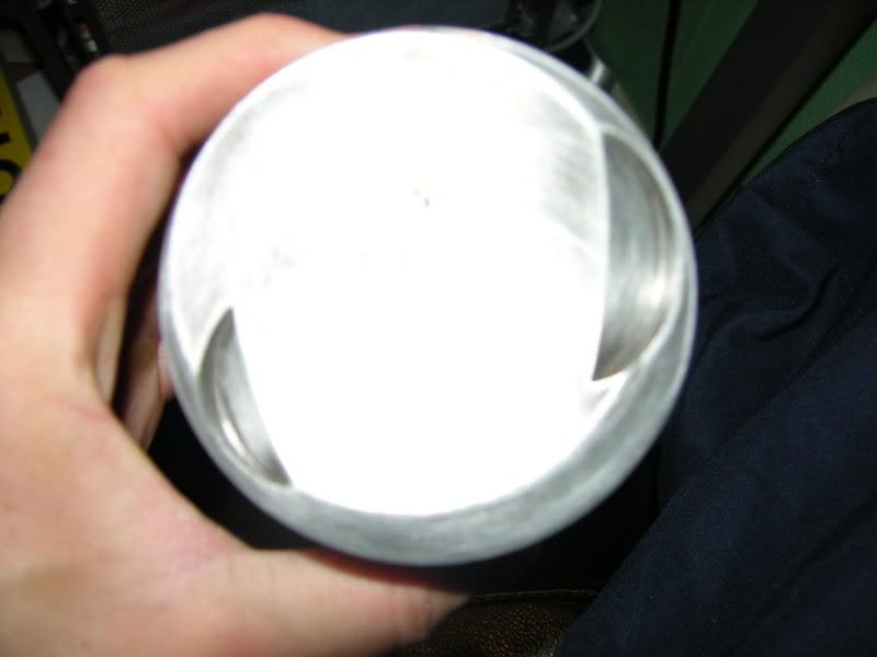

Is this a early high compression piston ?

from the valve cutout depth I'd say yes, but the skirt is shorter than normal.
KS or Mahle ??

ed325i
- Posts: 4146
Mahle.
Its got + 83.98 stamped on the top

Hi
Could the skirt be mmodifed to clear the rods in an early 2.7 conversion

ed325i
- Posts: 4146
The engine is not a 2.7 as it has the longer 2.5 conrods.

That looks like a low compression piston to me..........
Is the top of the piston "dished" in ?
ed325i
- Posts: 4146
Yes its dished, is the high compression not ?kam-325i wrote:That looks like a low compression piston to me..........

My 325i engine is marked as the "Low Compresion" engine, and it has those type (the dished) of pistions fitted.
AFAIK the higher compresion pistons have a flat top.
Like this......

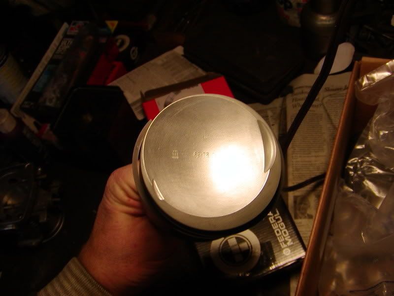

- Posts: 22697
i've got some late 8.8 pistons and Alpina pistons also, and the one pictured looks different to them

Is this Fact ?
Flat top Pistions = High Compression.
Dished Pistions = Low Compression.
Pic below is of my Low Compression 2.5, you can see the dish in the pistons.

Mine has got a bigger cut out for the valves.

top pic is a high comp piston
lower is a post 88 8.8:1 CR jobbie.
KS/Mahle pistons do vary but all M20B25 pistons are the same basic shape, flat tops in B20 and ETA/323 only
THAT, is a fact
THAT, is a fact

Thats a low compression piston. The same as fitted into my block.ed325i wrote:Mine has got a bigger cut out for the valves.
ed325i
- Posts: 4146
The piston with the bigger cut outs runs closer to the valve making it high compression. Thats what I think ?

given that were looking @ pix, not dimentions,I still vote higher CR, reasoning...... the deeper cutouts are there because the piston crown height is taller on the High CR pistons, and thus relieved more to clear the valve on full lift.
the lower CR pistons have less of a beak on the frontside, the overall shape is similar though, with a corresponding reduction in the valve pockets, the head is unchanged High or Low comp, all have same dims and valve sizes.
the only surefire way is get the part number from inside the skirt and match it up.
the 885 heads are oddball to the B25( and super Eta) because its a hemispherical combustion chamber shape, the piston "bowl" completes the shape.

So, could there be high comp pistions in my block ?

ed325i
- Posts: 4146
What is the engine number on the block ?So, could there be high comp pistions in my block ?
84B25E is the 9.75:1 CR variant 84B25K for 8.8:1

mines defo stamped as the low comp block....... B256K
