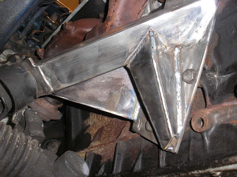

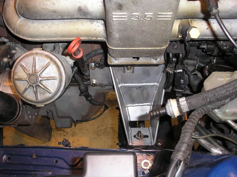

Heres my over engineered ones :D
Bit OTT I know. the Inlet side is easy, exhaust side was a real pain
john

they are very sweet!very good quality welding, I hope mine end up somthing like that!Alex

Cheers mate ,to be honest its the best bit on the Turd :D

I like johnl320's ones too. Some tidy welding there! :cool:
