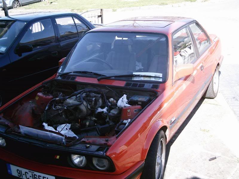

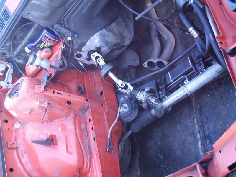

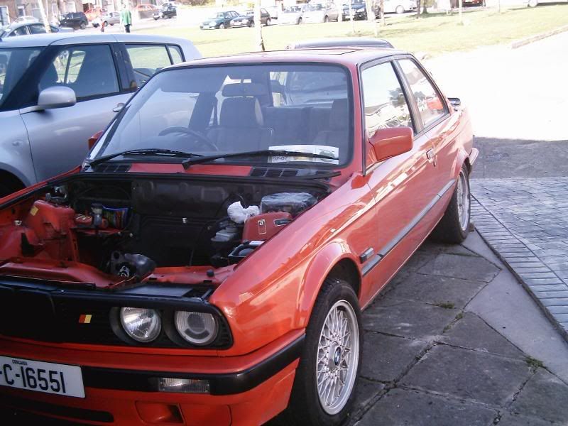

heres some pics..absolutely no rust..except for the little mount that holds the gearlinkage..just a little bit on it..

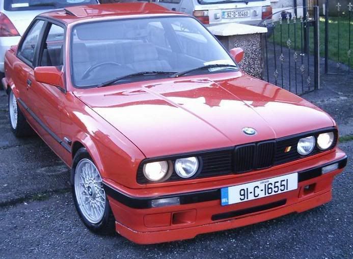

plan for outside it se sideskirts mtec I rear spoiler..318is front lip mtecII rear bumper..and fogs

The propshaft will depend on the gearbox output flange, why dont you fit an E36 rack at the same time? You will need to take the rad cowling out aswell :wink:

Now would be the time to put an E36 rack in, so that you can modify the M52 manifolds to suit.
Looks a nice clean shell!

shell is spot on..bm really done proper job makin e30 shells..no rust ..i have looked everywhere..under battery inner arches boot under battery shock mounts etc etc..clean evrywhere winkeye

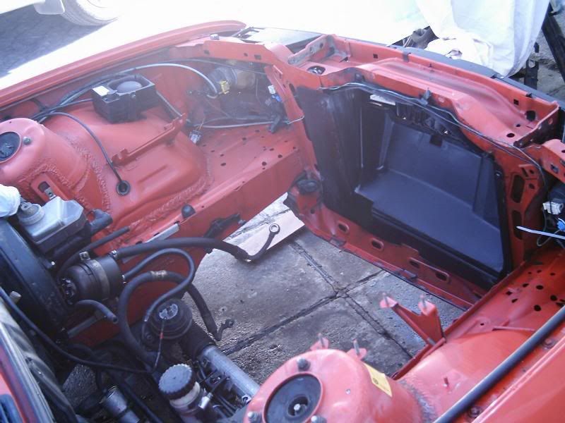

i will get pics up later on tonight of the engine and engine bay..its just sitting on floor next to car :D
