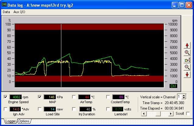

Have had a chance to play with that map you sent me (cheers again :D ) i cut,n,pasted your ignition map over the top of mine
And it knocked like fukc at anything over 3.5krpm but that was probly a week spot in my fuel map as a few logs on a flat road showed.
Ive also replaced a suspect TPS and given myself full throttle at last!
Ive never had it above 3/4 throttle :eek: forgot i limited it for runing in :oops:
Got intercooler being piped in tomoro. will see how much the temps drop :cool:

:lol: just had a look at that map, it's running up to 45degrees advance in places!
Can you cut and paste your MAP corrections in here? Just wonder how they compare to mine, although mine's only knocking about 8degrees out at 7psi.
Just spotted a glitch in the new software though, it's got the pressures listed going 0,10,20....100,110...120,130,171,170.... most bizarre!
