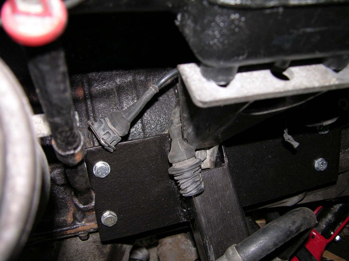

Hi, Found another one, where does this one go ? its the round plug under the inlet. cant find anything this plugs into
ED

bigdek
- E30 Zone Camper
- Posts: 1115
- Joined: Thu Feb 10, 2005 11:00 pm
- Location: Fife Scotland
there should be an end that screws onto that and a small fixing on the side of the engine for it near the starter
No idea what it does but i'm sure brianmoooore will have an idea

Hi, I cant find anything to plug into it. I have got the ones that go to the starter and the other one in the pic goes to the oil level sensor its just this round one that I cant see what it plugs into. It could be it doesnt go anywhere.
ED

Don't quote me on it but i think its some thing to do with an auto gear box, my old manual E34 had one i think ?
Brianmoooore
- Posts: 49360
As I said further up the thread, I don't know the M30 loom.bigdek wrote:there should be an end that screws onto that and a small fixing on the side of the engine for it near the starter
How old is this engine? Any chance it had a cat? Theres a plug about there on an E36 loom for the lamda sensor.

Ed is it definetly a manual loom? my engine came still attached to the auto box and all my connectors (inc round plug near oil sensor connector) look identical..

will get a photo of mine tomorow
it doesnt connect to anymore wires it just stops .
no idea what the part is called but it screws on and terminates the wires

Not sure where this plugs into but i can tell you that i have the loom that plugs into the fuel injectors from an m20 with the same plug on the end. Maybe this will help with locating?

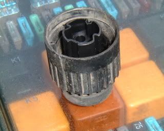

Are you saying it's got a blanking plug that screws into it to seal it off? If so, it's definitely for a lambda sensor. You can find a similar one clipped to the underside of the front battery tray on E30s.bigdek wrote:will get a photo of mine tomorow

yes m8 it just blanks off
this is the bad boy
located just below the starter
this is the bad boy

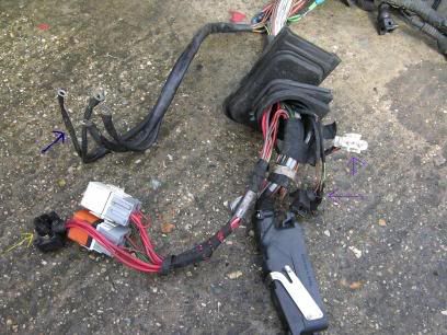

Update on the black/green unloader relay wire, and the lack of connector for same on the M30 starter.
Been stripping down an old carburettor 318 M10 today. The car body loom is the same as newer E30s, complete with unloader relays and the black/green wire to pin 15 of the C101.
When taking out the engine loom, I noticed there was only one small (black/yellow) wire to the starter motor; the same as the M30.
Decided to see how BMW got over this problem, so had a look inside the C101 of the engine loom. All that had been done was to fit a small wire linking pin 15 to pin 18 where the black/yellow connects.
If this works for the M10, it should work for your M30s as well.

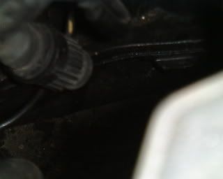

Not much use as it is but i will try to add the wire colours to this picture tomorrow.
Hard to see on the picture but theres actually two smaller terminals,the hard to spot one is under the left hand big nut.

Thought yor M30 lot had told me that the M30 starter motor only had three terminals?
Andy335Touring
- Posts: 7144
- Location: Long Eaton,Nottingham
Two little ones and the main big one, the other big nut is the starter to solnoid earth i think ?

Other big nut on the solenoid is certainly not an earth. It's the switched 12V+ to the starter motor.Andy335Touring wrote:Two little ones and the main big one, the other big nut is the starter to solenoid earth i think ?
If your solenoids have two small terminals, what is the problem you have with the unloader relays?
