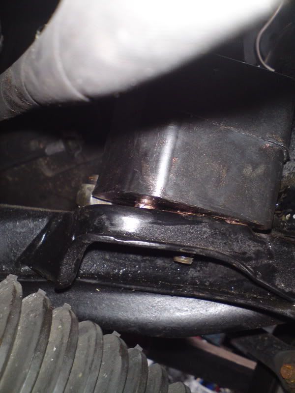

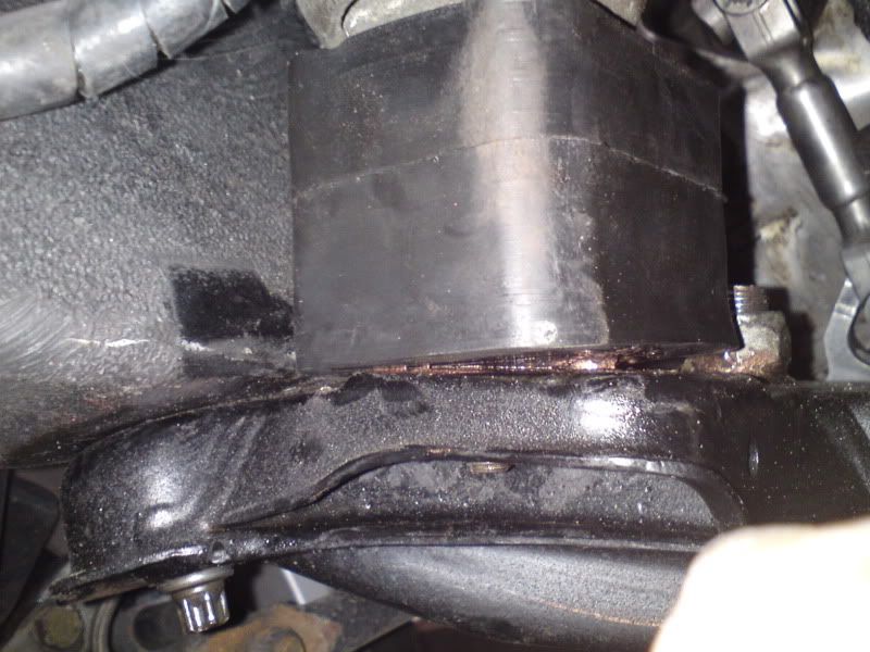

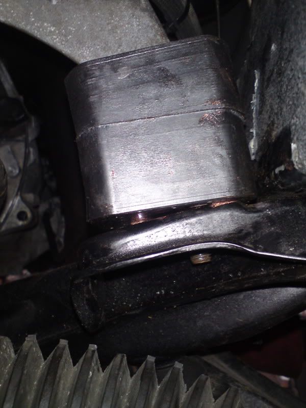

I know a few have these fitted so thought id make a thread, I fitted mine this morning and im not exactly over the moon...
The gap is bigger with the nuts loose, they are tightened right up. Im hoping they will reshape a bit with heat and use but im not holding my breath :?

Looks to me they might split Dan, as they are a 2 piece, and the way you drive won't help them :mad:

Is there any movement on the engine with these done up tight?
Look a bit poor to me
Thu Apr 07, 2011 5:44 pm
I cant get any movement at the moment while its up on the lift, will see what its like when on the ground.
I dont think they will split, but its not what I was expecting from £200 mounts :roll:

They fit worse than my m5 ones :eek: I am sure Jhonno's akg's did not fit like that, i removed them myself and they seemed to fit perfect.

penton08 wrote:They fit worse than my m5 ones :eek: I am sure Jhonno's akg's did not fit like that, i removed them myself and they seemed to fit perfect.
This.. Mine fitted perfectly. Bad batch? Dodgy subframe?
Thu Apr 07, 2011 6:54 pm
Nothing wrong with the subframe, I did think this myself but therer is a gap above the welds also, its not just the corner that has a gap

Not put any thought into it, but if you can take some relevant check dims I can measure mine up as they are in a box atm..

i wouldn't be very happy with them either dan, especially after shelling out 200 notes for them 8O

they look too tall to me :s have u tried swapping side over?

They are actually shorter than M5 type mounts

Mine fit spot on, you sure they are all in the right way etc??
Thu Apr 07, 2011 9:58 pm
I think yours are the wrong way around?

Well they fit perfect :D
Thu Apr 07, 2011 10:11 pm
Well in that case mine are the wrong way round. :mad:
Thank fook for that!!! :D

I think mine fitted better than those too. You may well have them the wrong way around. :D
