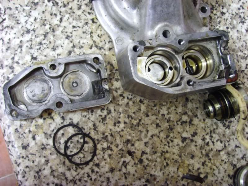

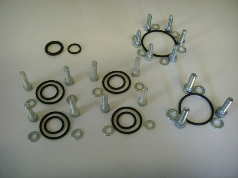

Pretty picture =

Can you send me a pm on the seal lit in the pic too Dan, Are the bolts part of the kit or are they dealer only too?

Everything in the pic is what you get, the bolts are 12.9 BMW will supply you 10.9 so they are slightly better. Seals are made from Viton which is the best material available, BMW supply you with standard low quality rubber O rings at a massive mark up. The internal seals are Nitrile which is the next grade down from Viton, you wouldnt want to be messing with these anyway as its a strip down/timing job, best to leave it to the specialists.
Generally you should be replacing the solenoid seals anyway, as they are low grade rubber they are destined to fail and will start to leak sooner or later.

- Posts: 28646
- Location: Staffs
Pretty much everything in this picture can be changed without removing/disturbing the unit/timing
99% of vanos problems are due to the seals, the solenoid cover bolts can stretch also
The above kit is £40 posted to zoners
