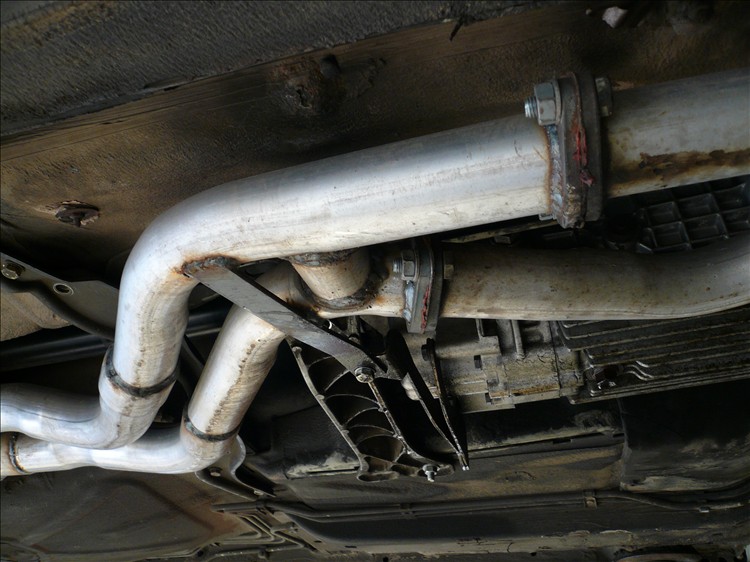

Sadly I didnt make any photos when the engine was in the car. But now it is in parts waiting for rebuild, so I cant make any interesting photos. However I have some that show some details, but are in low quality because of the phone camera.S38B38 wrote:NICE mods,, would like to see pics,,

PHOTOS
Some of the things I forgot to mention. Because of the position and modified oil pan, I dont have to lower the subframe so it doesnt affect the suspension geometry. The other good thing is that the engine clears the hood, not by much, but it does
I dont know if it is exactly 15cm, but somwhere in that region. It was a compromise with the oil pump pickup and the size of the gearbox tunnel and the size of the prop shaft. The shaft is from E36 automatic, which is just the right length, so only the middle bearing must be changed.
I did most of the things last year, so the memory is not fresh anymore and I dont remember all the problems I had to overcome and all compromises to make.
