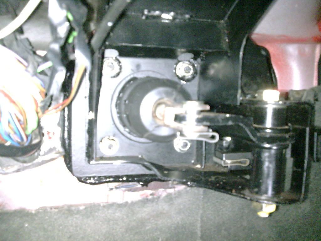

First thing to tackle was the brakes, since im swapping a euro motor i need loads of space on the intake side, i decided to go with the golf servo and standard e30 master cylinder. To move the booster closer to the strut tower, i drilled and cut the firewall to accomodate the booster more to the side. For the purpose of support and strengh i made up 2 plates of steel to really keep the booster in its place and not let it break through the firewall....
Plates and booster sprayed and ready to be fitted
i obviously need to lenghthen the rod from the pedal to the booster so i used the e34 rod with a little shortening and re-threading.......
the finished product (inside)
and outside....

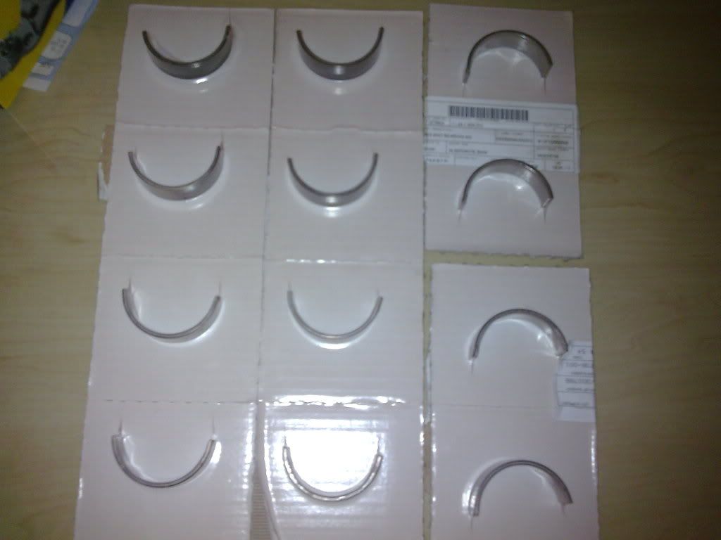

Received the bearings from the dealer, expensive buggers , had to wait 2 weeks to get them from Germany...
