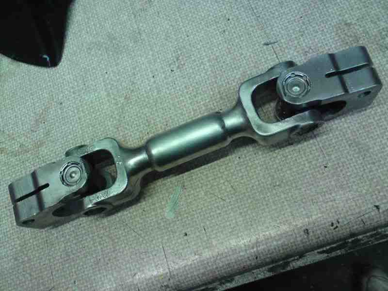

How about this

as im doing this atm can you use the e30 uj on the e36 rack ? are the splines the same?
Posts: 28646
Post Tue Apr 21, 2009 8:07 pm
Yes they are, unless the E30 rack is a manual

Well put it like this, I havnt had to cut the rear M52 manifold, it is quite close though so strong mounts are required.
I rebuilt the UJ's myself but paid to have it welded, the welding comes with a 12 month guarantee which is reassuring :)

DanThe wrote:How about this
this will be an MOT failure tho! but if you know the right people :)it will be ok.
That is exactly what I have in mind,I am getting worried about heat transfer from my manifold...Can we arrange a small production run to get the cost reasonable,a 'grope buy' sort of thing?

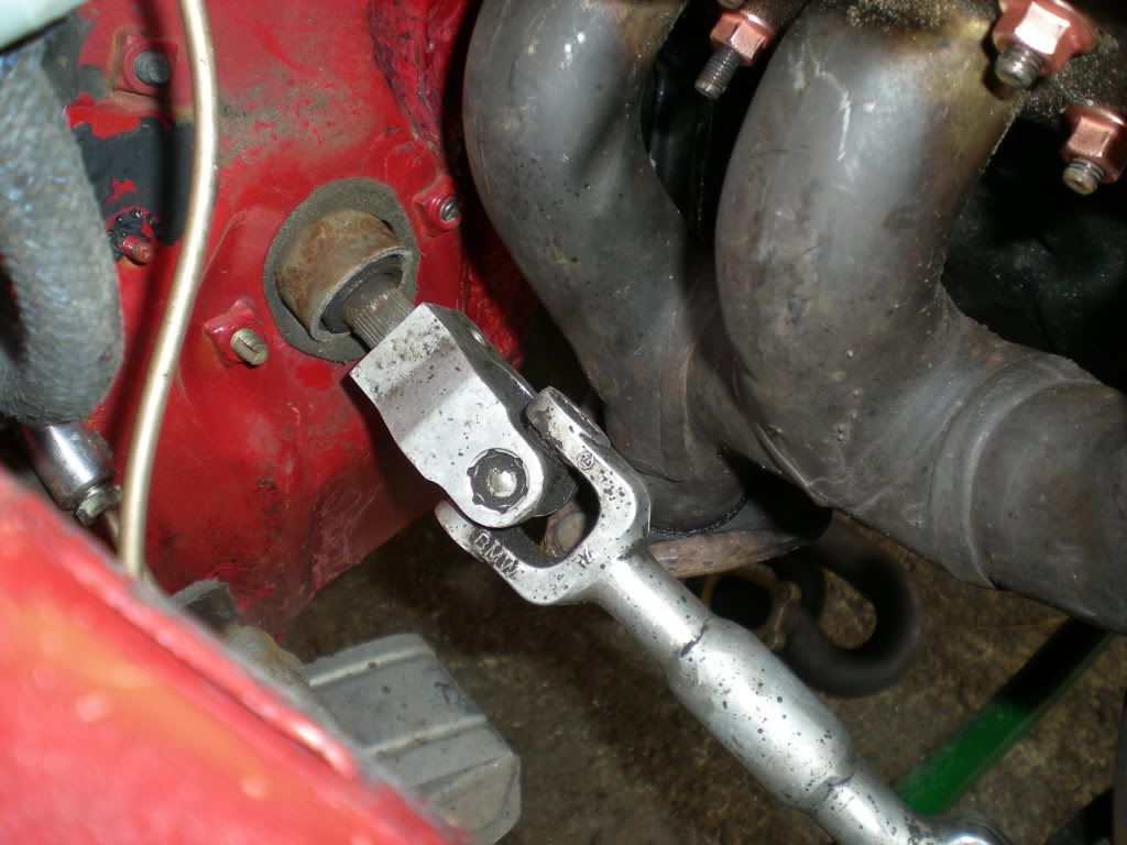

Here is an M52 manifold without the top flanges butchered with a modded steering column UJ arrangement like Dan has. This is with an E30 rack.
Post Wed Apr 22, 2009 6:37 pm
Explain? :?

Ive no problem taking a few of these to my local reconditioning place, id rather have a company reassemble the bearings than do it myself, its very easy to f*ck them up.
Also the different lengths need to be taken into consideration, E30 rack, E36 rack, front or rear mounting holes on the subframe etc.
I will give them a tester next week and post this up in the group buys when a price has been worked out 8)
Is this just an E30 linkage with the rubber donut and mounts chopped out and rewelded? Is this all that's needed to clear the M52 manifolds? Also what and how do the downpipes fit onto the manifolds?
Sorry for all the questions! Cheers
Posts: 28646
Post Wed Apr 22, 2009 9:51 pm
No its not, its made from 2 lower linkages, one has had the UJ rebuilt as the column splines are different to the rack splines. Down pipes do not bolt up, the one flange points towards the cross member and interferes with the rack

DanThe wrote:No its not, its made from 2 lower linkages, one has had the UJ rebuilt as the column splines are different to the rack splines. Down pipes do not bolt up, the one flange points towards the cross member and interferes with the rack
Dan have you got any info on swapping the ujs ? I cant see how they come apart!
Posts: 28646
Post Thu Apr 23, 2009 12:58 pm
They are not meant to come apart, you have to cut them up!
