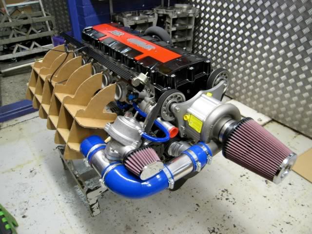

Heres a Current pic of the car for anyone who's intrested :D
I'm still going to be sticking to the Superchargers and not swopping to turbos as i love the whine and the way theres instant boost with the superchargers.

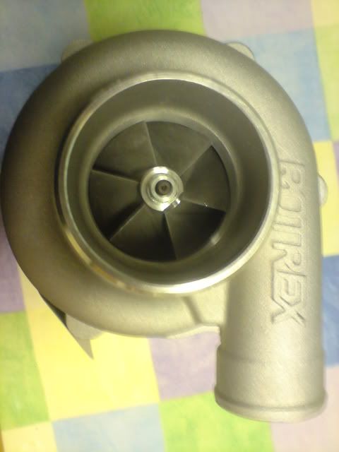

So far i've been gathering a few bits togeather ready to start doing things when i take the car off the road in winter, so far ive bought two iner coolers, one saab and one Volvo type, both simular but with different porting.
Unfortunatly neither of them will be able to satnd the high boost pressure with out balloning and then blowing the end atnks off so i'm going to use them to mock up the set up and then get an ally one made to the sime size so i know it will fit in with out having to modify the carsfront pannels.

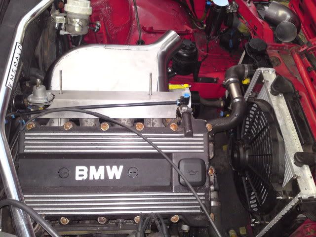

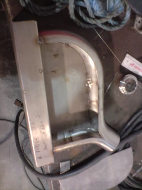

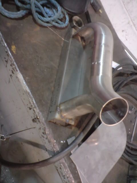

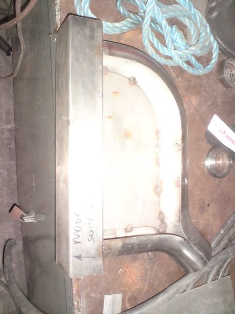

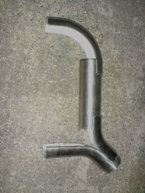

Heres a few pics of the inlet maifold i've started making up
First cut up some3" 45 and 90 degree pipe bend to make half sections using an angle grider and then a flap pad to finish the edge off, heres them just mocked up.
next thing was to tack them togeather and stich weld the bottom of the pipe work to a big section of box to make sure it keeps it shape when welding and doesnt distort. then i tacked the middle section in the top to joint the 45 and the 90 bend to geather :D
And heres a pic of it nearly ready for welding, just got to tack in the other plate. Making the top and bottom plates was a pain in the ass but i think the patiants has pain off as they fit realy well and will make welding them in easyer :D

Manifold is taking a nice shape.

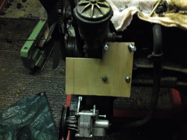

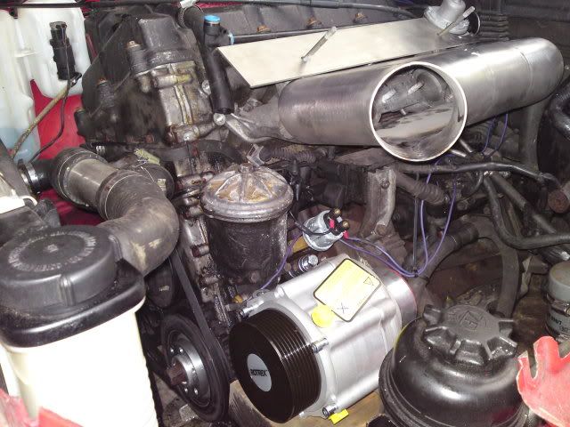

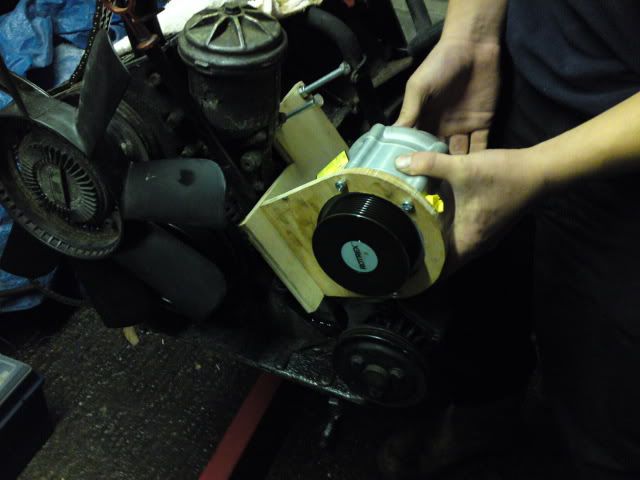

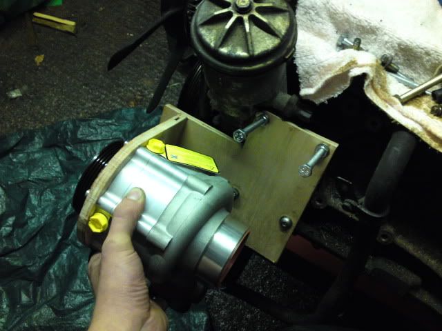

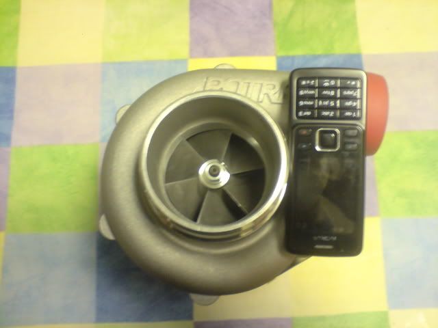

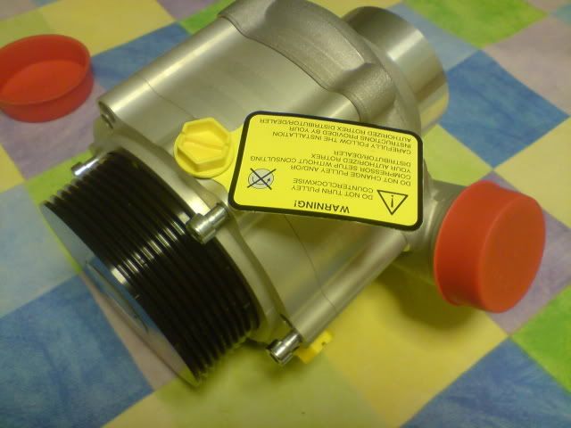

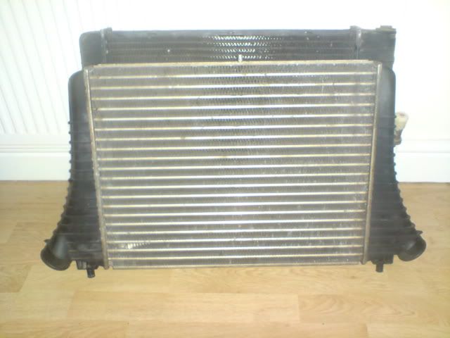

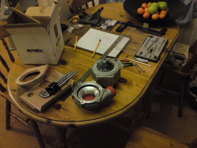

look what turned up at work when i got back from site today!
Looks a a realy nice bit of kit, only thing that i would change on it is to have bigger bolts than 4 M6's to hold it on to the bracket.
heres the pics, very compact, its a c30-94 the biggest they do in the c30 range 250-400bhp

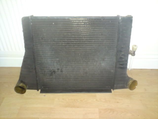

the two intercoolers i bought off ebay also came ones from a saab and has 45degree doward inlet and outlets and the others a Volvo one with 90degree inlet and outlets.
The Volvo one
The Saab one, larger flow channels ( if thats what there called) but smaller in depth and has slightly smaller inlets.
Lastly the two togeather the Saab one in front.

are you getting a full ally one made...as those stock plastic end tanked ones can be dodgy at higher boost.
theres plenty of cheapies on ebay :cool:

Best i can do is give you the link to the rotrex data sheet on there web site.
Direct link to the sheet in PDF mine is the last graph C30-94
http://www.rotrex.com/pdfs/Rotrex_Techn ... e_V4.0.pdf
My pressure ratio is around 2.2 which gives me around 74-76% effiecency.
As regards the internals the crank is forged anyway and ive bought some forged rods from australia, and Ant is going to be building the bottom end up for me with some low comp pistons, yet to speeck with him but i think it will be around 9:1 using what ever company he uses for his pistons.
The only other thing i want to look at is the soidium cooled valves the engine has i think it might be worth swopping these for solid ones given the power goals i'am aming for :D Dont want them to get hot and drop off. :cry:
The idea with the intercoolers is to use them to use them to mock everything up then if they fit get a firm to make one up in ally.

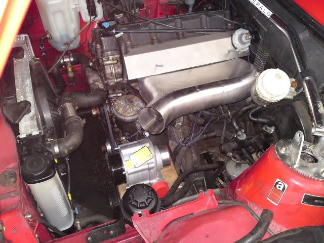

Only thing is now looking at the size of the charger its looking like its going to have to go on the pass side of the engine as its alittle big which is a pain as it means the flow of the charge cant go from one side of the bay to the other throught the intercooler, instead it will have to go in at the bottom the the intercooler and the come out on the top both on the pass side which wont be great for flow and not that easy to pipe to as i will have do some clever pipeing not to have to cut up the body.
Going to wait and see what Ant comes up with as he is also working on a bracket also, although i dont know what size of charger he is using :D

Done a bit more to the plenum at the weekend and managed to get it welded up, had to cut the large opening of it to make it fit correctly as the angle was all wrong and made the inlet point to the fop of theinner wing, it alot better now but i still think it could do with a 45d bend pionting down to make it line through :D
A rough idea as to how the inlet will fit and were the supercharger will go :D
had abit of spare time to day so set up a "work bench" much to the girlfreinds dislike :evil: and stripped the housing off the charger to rotate it as the oil in-out has to be at the top of the gearbox.
Inside the rotrex
With a bit of space to draw things out and work on another spare IS engine ( i now have 4, cheers Kedge) i was able to start making a mock up of the mount from ply-wood.
The motor mount
Afew pics of how it will al sit, the mount will be made of two parts which will be bolted togeather at the 90d bend.
And alittle bit of engine porn for you this is an engine my freinds having built to go in a TVR segaris! :twisted: :cool: nothing like a bit of inspiration :D

That inlet manifold looks really good, top work :cool:

inlet looks brilliant. good work
