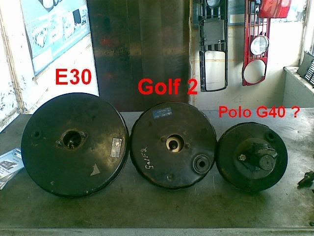

After I popped in last week I called in at Whitehouse VW on the way back (armed with my E30 servo). Had a look at what they had......
E30 on the left Golf mk2 in the middle Polo G40? on the right

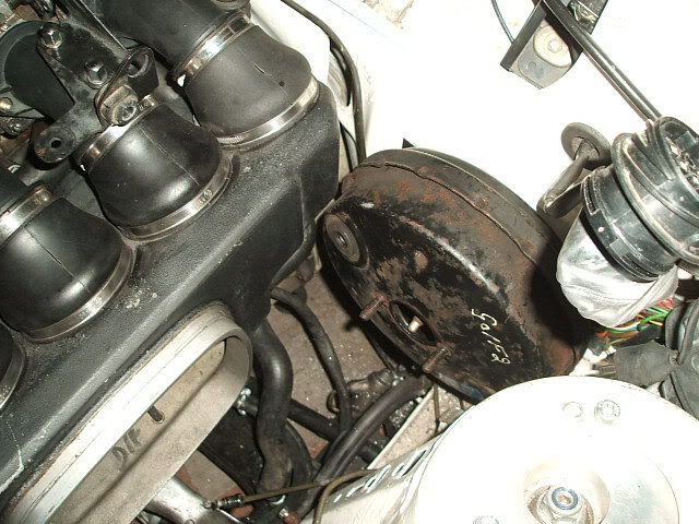

I bought the Golf mk2 (middle) one and installed it a few days ago.
I made my own plates up in the end and moved it over 55mm
I've just measured the Golf mk2 servo i'm using and it is 225/230mm
So as long as you move it 55mm or more you should be ok. It's tight getting the air collector on and off but never mind. :D

that servo is too close for my likeing, will cause problems on hard right cornering I'd imagine?
I'm moving my servo over the same as Dameon did on his, which looks very similar to yours but his servo is definately smaller,
http://www.e30zone.net/modules.php?name ... c&start=50
scroll almost halfway down that page and you will see the difference. I might pop up Whitehouse for the other servo in your picture as that looks about the right size!
How much did they rush you for the 16v servo mate?
