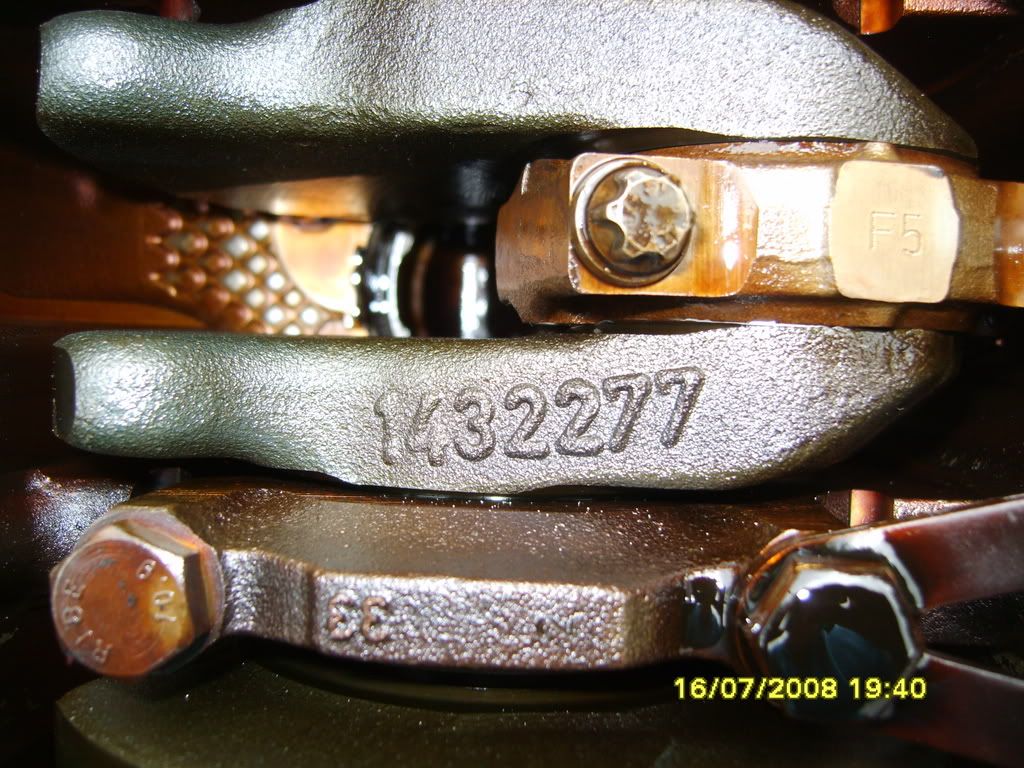

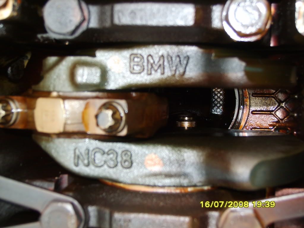

Hi guys
I'm wondering if any of you guys can tell me if this crank is a later TU one or an earlier non TU??
Here's a few pics
markings on the 6th counerbalance
On the 2nd counterbalance
On the 1st counterbalance
Underside of 1st counterbalance
I'd be most grateful if anyone can shed some light on this

Looks like a TU crank to me mate.
2 things that identify it, the blue hue to the casting and the smaller counterweight with a machined flange at the flywheel end (top picture). Also the NC38 is only on the TU cranks from memory.
