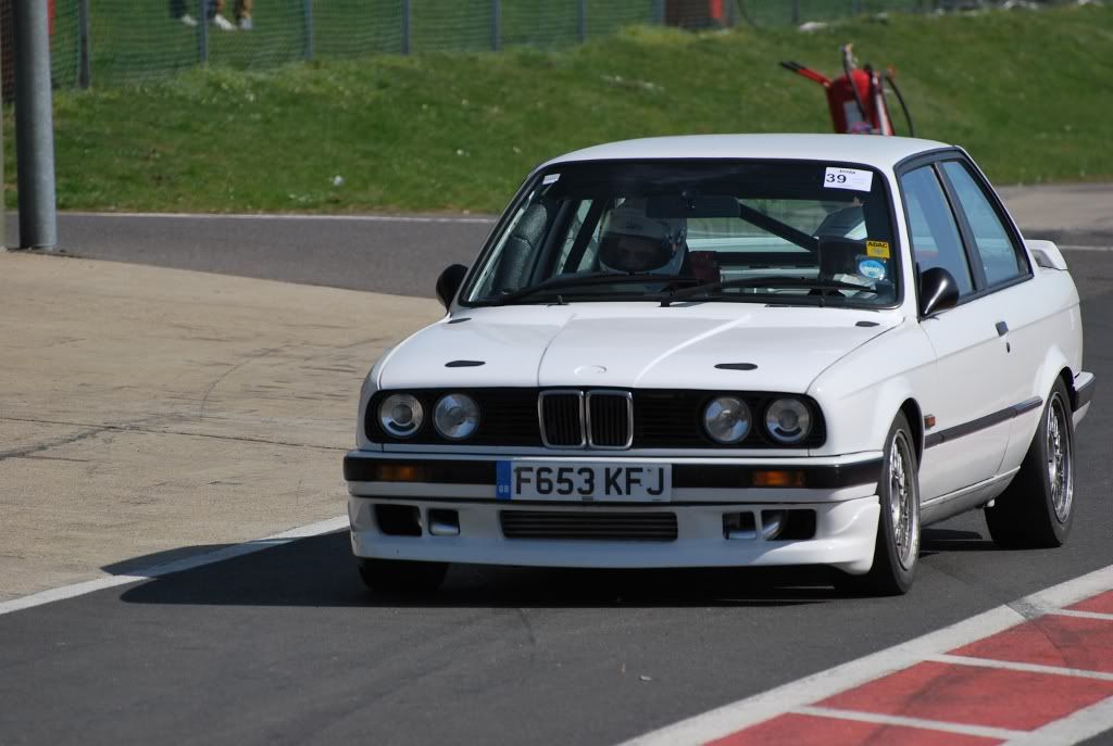

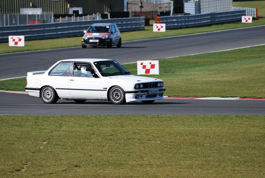

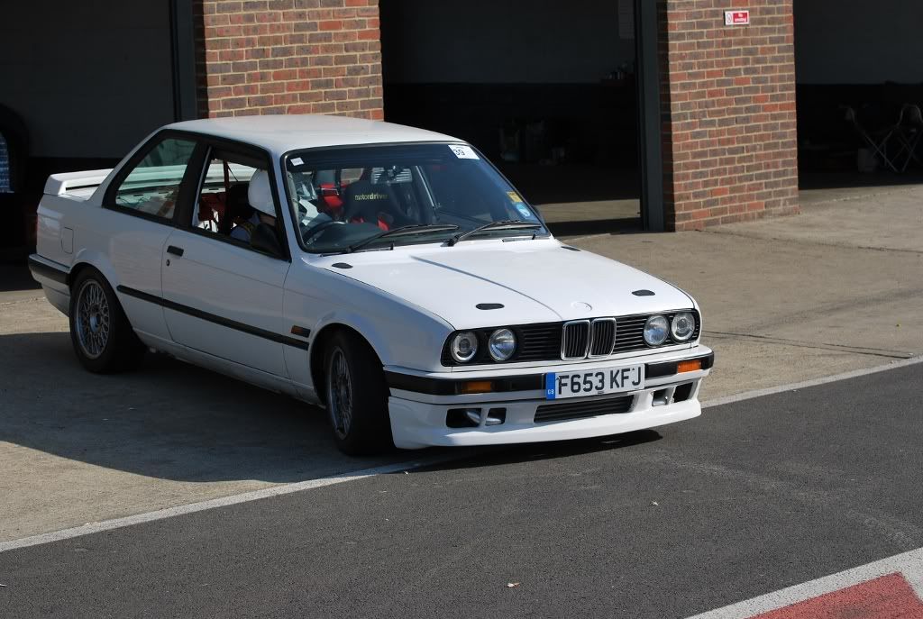

Had another great day at Snetterton on Sunday, car was entertaining on old slicks which took alot of warming up - I will hopefully have a video soon to demonstrate how bad they were cold!
Found the car to be quite oversteery mid corner so I decided to crank the front anti-roll bar from soft to hard (bypassing the middle setting!) and it really improved the balance, quite why I haven't done this before I don't know. Actually that's a lie - it's because I'm really lazy.
Some random pics; (yes, that's my ugly mug in the second photo)

Sweet! Not sure what line that Renault is taking?!!
Theo
- Old Skooler
- Posts: 10735
- Joined: Wed Jun 01, 2005 11:00 pm
- Location: Kent
He probably saw how wayward my driving is and got well out of the way!

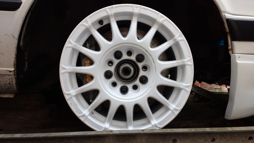

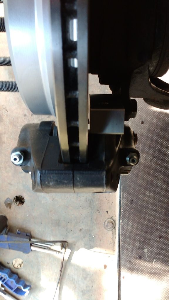

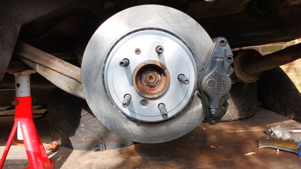

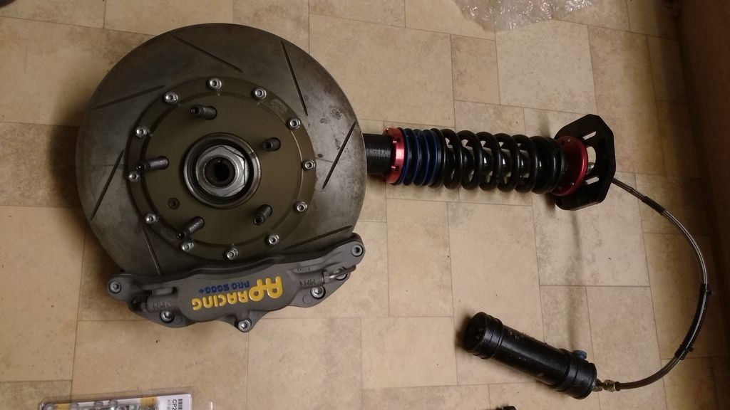

Time for a thread revival!
I've hardly used the car in the last few years, last outing was October 2014 at Silverstone (which was awesome in the drizzle). In a bid to renew enthusiasm for the car I decided to spend some money on it - man logic at its best.

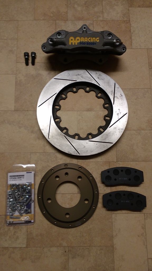

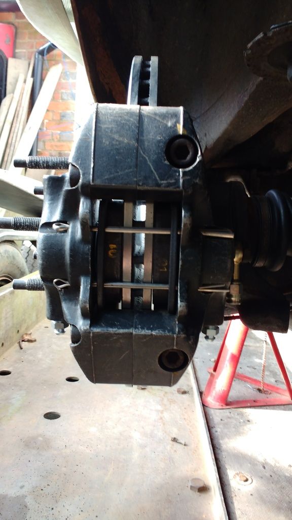

First up, I've changed to E30 M3 5 stud suspension. I've got for AVO coilover suspension which uses a mono tube damper with 3 way adjustment on the fronts and 2 way on the rear.
Changing the suspension necessitated new brakes and I thought I would splash out on some AP Racing parts. There are no off the shelf kits available so I contacted BG Developments and they came up with a design which would enable me to run 304mm discs with the CP5040 caliper inside 15" wheels. Discs are 304x28 and fully floating through use of bobbins. I have increased the bell offset to move the disc inboard, the net result is that I'm only increasing the front track by about 6mm either side.

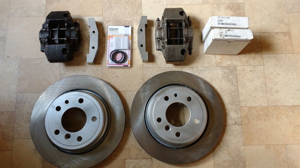

The rears were much more straight forward so I designed the brackets myself and had them made by a mate. I'm running 2 pot 'CP5111 family' calipers originally from a TVR Cerbera I think. The discs are 300x22 and come from an E34 M5/540i. I've done away with the mechanical handbrake mechanism as the car is no longer used on the road so I can make do with a hydraulic handbrake instead. I'm using Performance Friction 01 compound pads front and rear, like I did with my previous brakes.

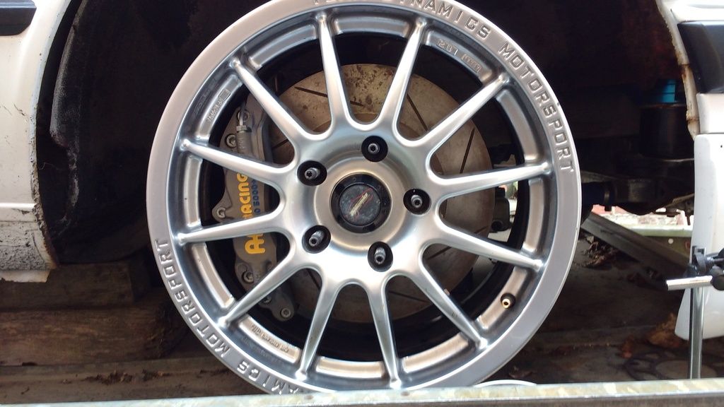

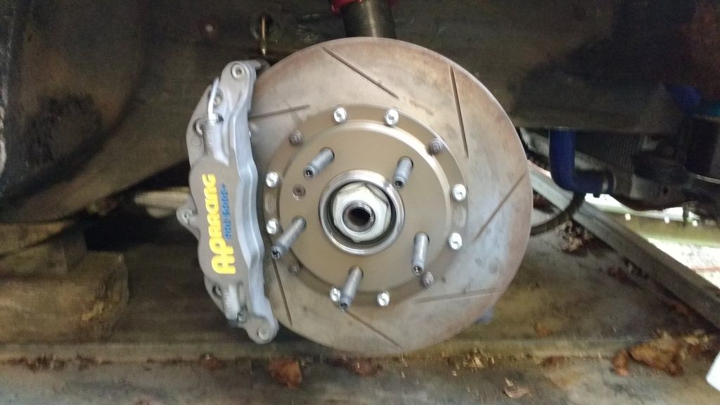

I've posted a few pics, I'm currently in the process of fitting everything and these were taken during the mock up so you may notice bridge pipes and bleed nipples missing/in the wrong orientation etc.
Inside 15" ATS Rallye wheels
Inside 16" Team Dynamics Pro Race 1.2
Currently in the process of ordering the parts for the new brake hoses and generally fitting everything and recommissioning the car for some track action.
