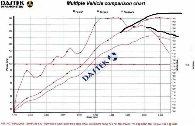

dude, you don't understand. I could set my rev limit to 20,000revs, and it wouldn't make the car any faster. to get any m20 to hold it's power to 7k would take quite a bit of work!!!
your car makes peak power at 5,9k, after which the power drops off. basically our engines are idential up to 4k (give or take a few hp) but after that mine makes more power til it's peak power of 183bhp at 6,600rpm or so, whereas yours increases at a lower rate until it's max of 170bhp at under 6k rpm, then it tails off. With a stronger inlet cam in mine I'm hoping from about 3k upwards to make more power and keep the power all the way to past 7k.
here's a rough pic to show what i mean - obv just for illustration and hardly very accurate
actually it's a bit conservative for mine, it makes more power than the line I've drawn in. note how yours is starting to tail off at the end of the graph.
anyway all that's beside the point. if it was just about power i'd have chucked in an m52. I've been trying to show that there's more to it than just power - economy, reliability etc. that's before even bringing in the fact that an IS shell weighs 1125kgs, so it's not just a lighter engine/box etc but a lighter car

right.......... well we shall see what the differences are with the chip.... tbh im not expecting allot for the £30 i paid but it feels more responsive and torque and power has improved im sure of it!
