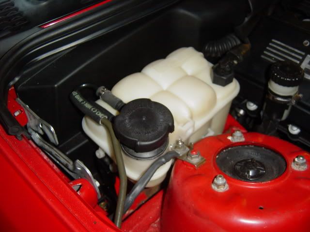

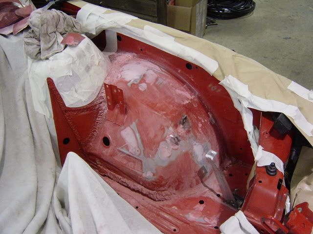

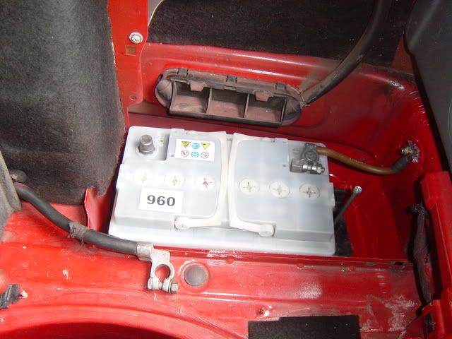

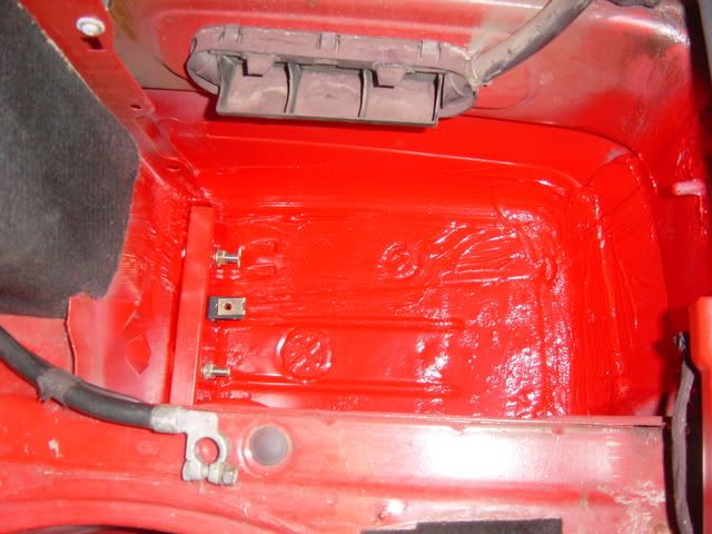

The battery relocation to the boot is not as easy as I had first hoped. The battery tray from the coupe works perfectly but unfortunately the boot/cubby doors will not close. So I removed the support metalwork in the floor and made some new supports about 60mm lower down. I also took the opportunity to clean up the well and reseal and paint it.
There is no earth tab in the boot so I welded a stud into a metal plate and then Mig welded it into place. The boot locker now works perfectly :D

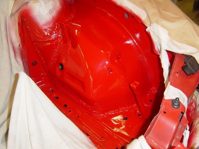

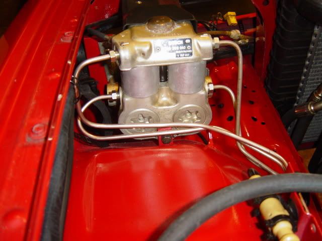

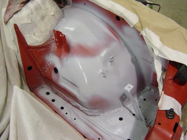

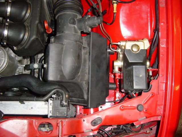

I had to remove all of the supports for the E30 coolant tank and ABS, then weld in new for the relocation of the ABS servo and E36 air box. By the time this was done It needed a coat of paint:

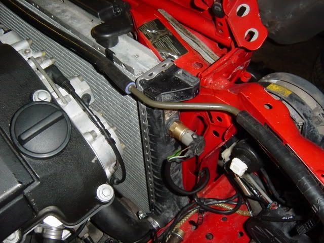

Coolant tank in the same position as a LHD E36 M3, thanks Ian for the tip. I used a LHD M3 coolant transfer pipe with a little modification. Putting the coolant tank here allowed me to use the M3 airbox and retain the ABS inside the engine bay.

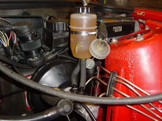

Pipework:

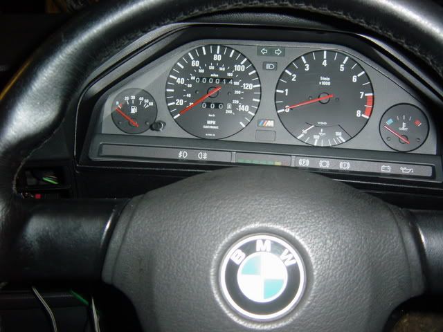

Newly assembled M3 clocks with oil temp gauge :D

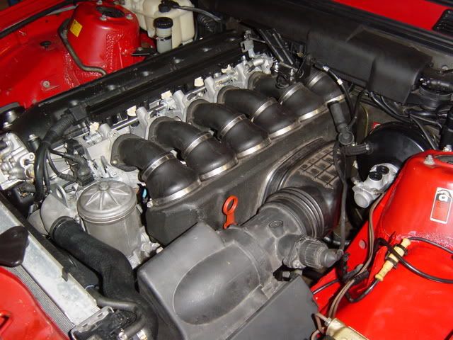

I had a few problems with the EWS that resulted in having to find another full EWS setup today but now all is well. Everything powers up (nearly) as it should and well…
A few jobs left to do yet but it runs!

Puts a bit of a damper on my battery relocation though, no MIG :(
Posts: 28649
Post Wed Jun 20, 2007 11:21 pm
Just use the bumper strut stud for the earth lead.
Thats what I did with mine, rub the paint off then bolt the lead on with a load of grease or vaseline 8)

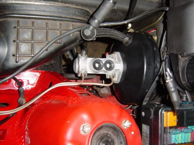

I can't begin to remember every single job I've done - it's been a long week! I have been over everything at least twice; Documented, photographed it, checked it's tight. You name it, I've done it.

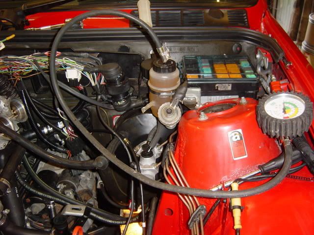

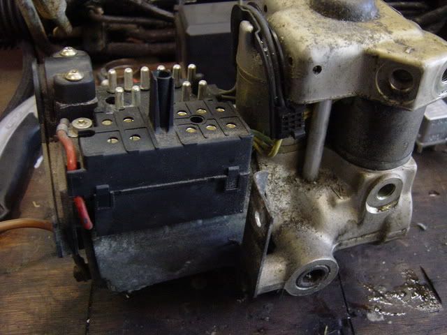

The biggest problem I had was bleeding the brakes after the ABS servo had been sat. Bearing in mind that every brake component in the car was completely dry including the servo itself. I could not get the servo to bleed. I could bleed the master cylinder to the servo but that was it. So I did a little research and looked into various methods. The dealer was suggesting that they could put it on their scanner and put the system into bleed mode etc. Bugger that.
So, I grabbed a spare ABS servo and stripped it down to see what made it tick.
Looking at the way it was wired over a coffee revealed a method of triggering the three servos and running the ABS motor in sequence . So I chopped another ABS plug off a spare car and set to work making a wiring loom. With a few simple modifications I was able to energise the motor and servos which did the trick. This enabled me to pressure bleed the system effectively. The dealer can stick their ABS scanner :)
Pressure bleeding the system for the first time. I re bled the system after this as I was afraid that the fluid would cavitate from the compressed air.

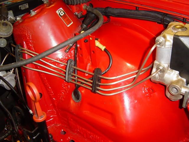

A few shots of the brake system:

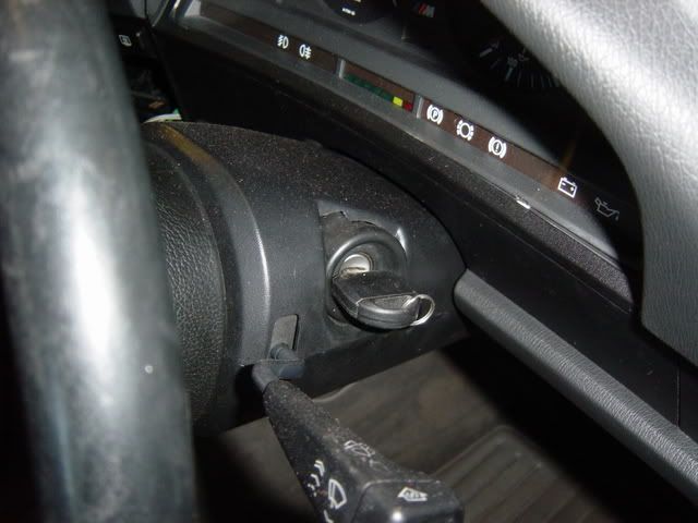

I also spent a great deal of time making the EWS system work utilising the E30 key. I won't go into too much detail now as there is a whole page full of info regarding this.
Pic of E36 transponder loop fitted into E30, the micrchip/transmitter is inside the E30 key:

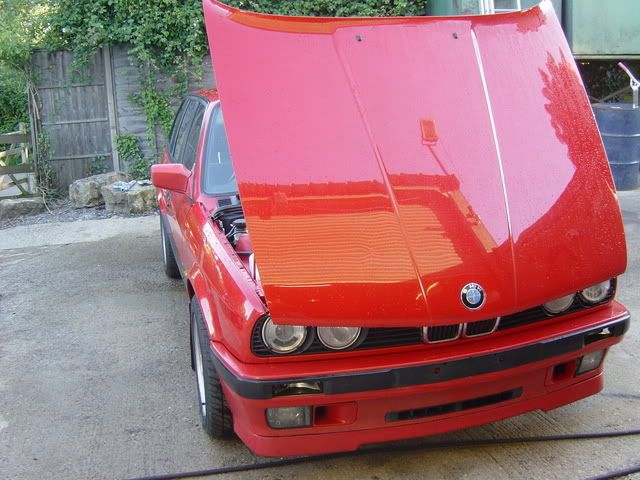

A few pics of the finished (nearly) article:
Ride height looks to be the same as standard 325 (for now)
^^ It's me in the reflection!!
