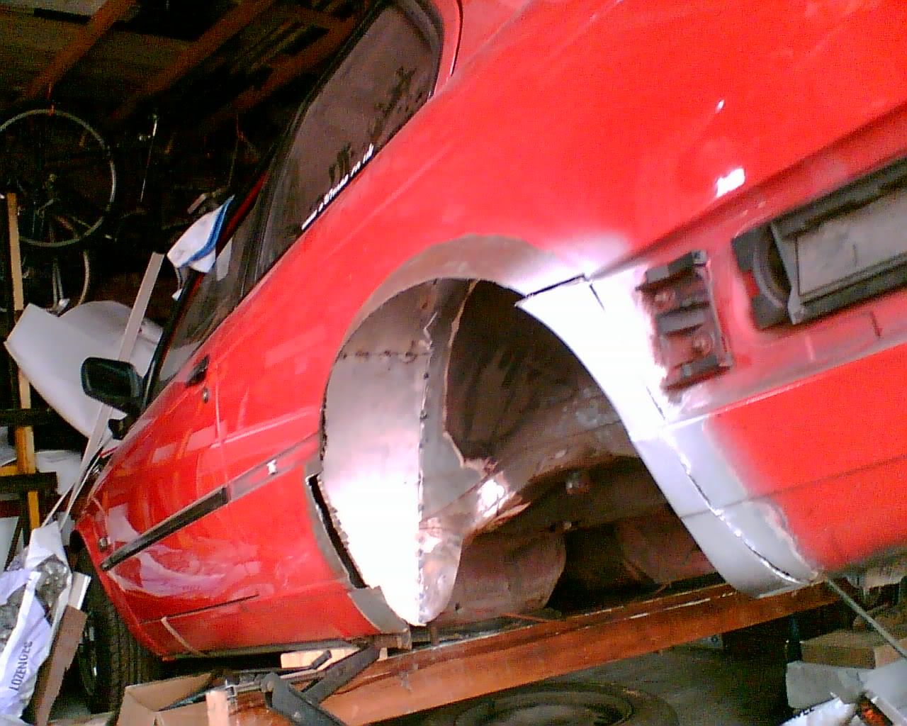

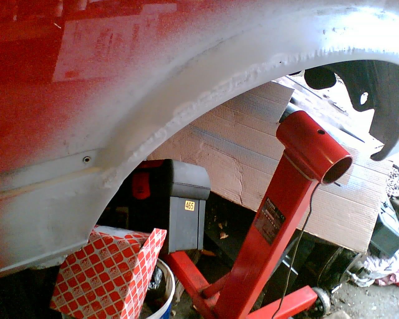

Sun Mar 12, 2006 2:28 pm
UPDATE!

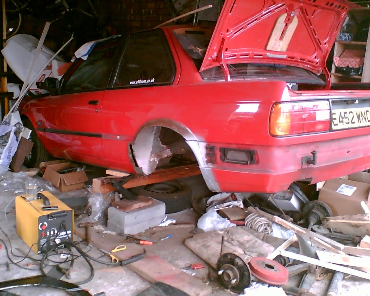

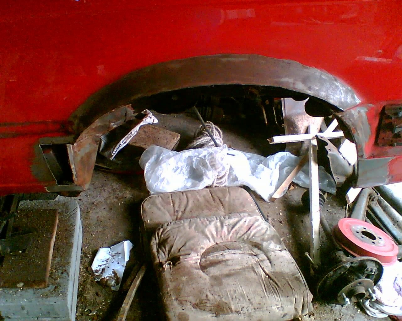

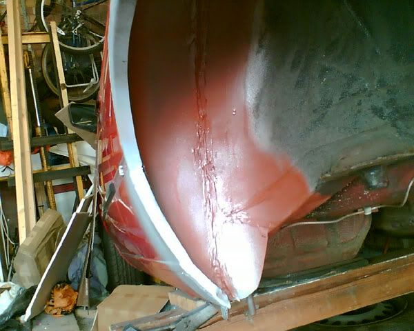

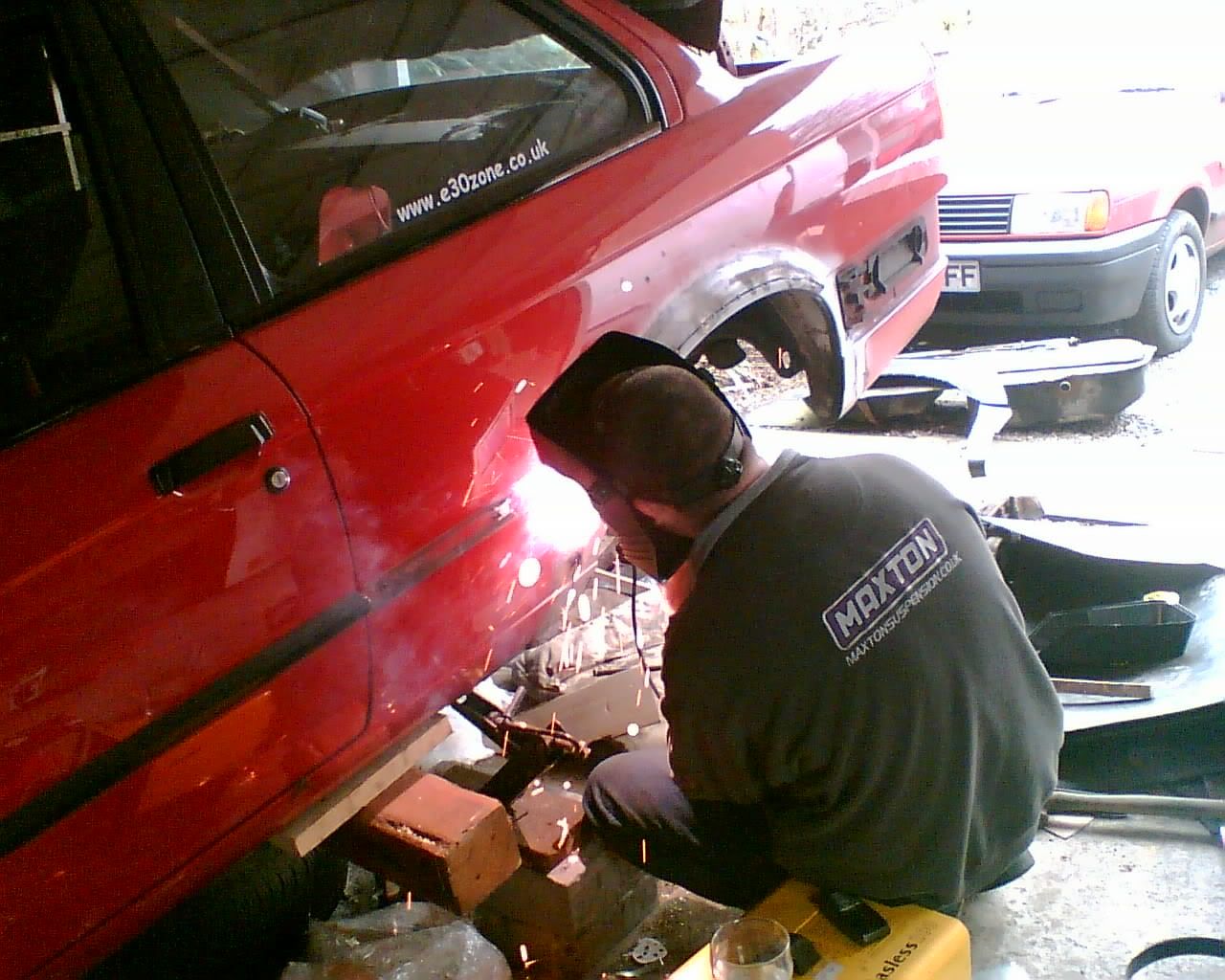

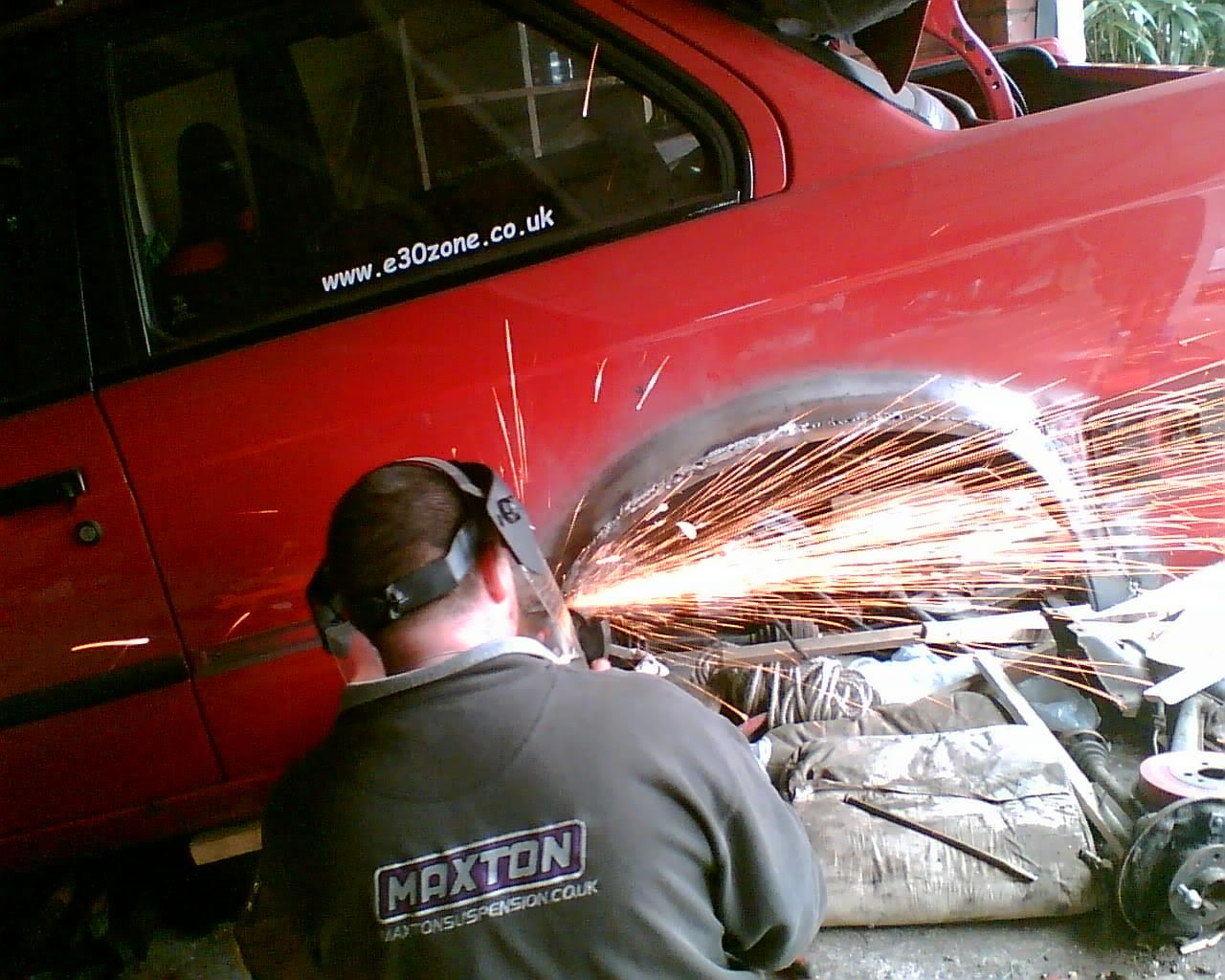

ive finaly got the wleding most of the way done on the rear arch now! we ran out of welding wire to finish off the inner arch but its all spot welded in place so its just a case of joining the dots!
heres afew pics.
this one made me cry abit seeing my cousin cop all this out!
first few pieces on the outer, all the inner done
abit of welding
abit of grinding
the final result ready for lead loading!
got the trailing arms ready aswell so there off to be shot blasted later in the week :cool:

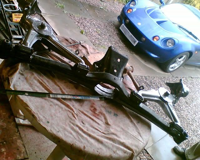

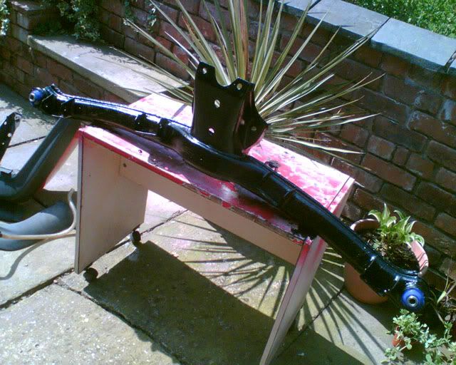

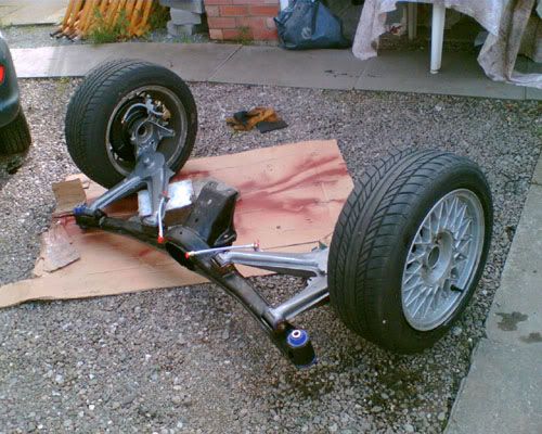

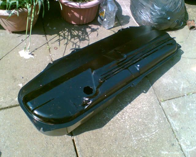

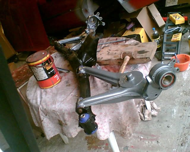

Some more progress on this.

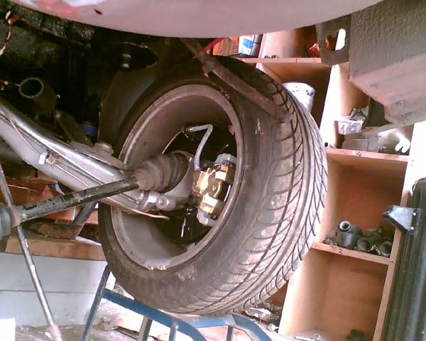

Got my new inner wheel arch through so that is being fitted instead of the plated rear inner arch that was being done. Its taking abit more time but at least its a proper job this way.
Rear beam and new tank painted up ready to go on in the week.
Whole rear axel has been polybushed and painted. This is also gonna be goin on soon.

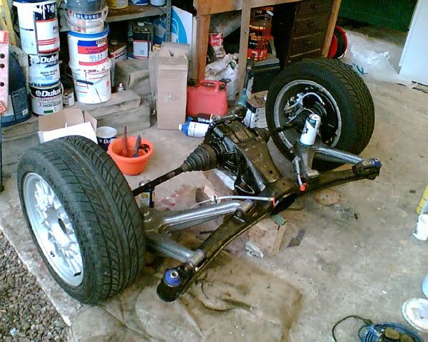

Si316
Posts: 1810
Location: Cheshire
Mon May 29, 2006 9:16 pm

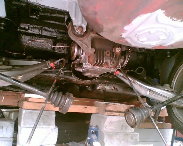

Got abit more done this bank holiday weekend 8)

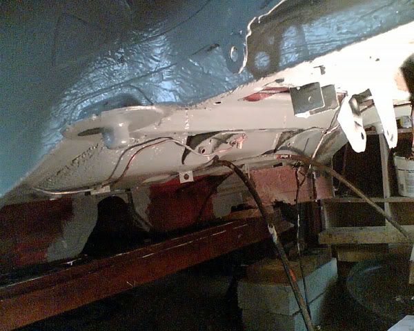

The rear axel will be going on this week after ive waxoiled the freashly painted under side!
New wheel arch, the plating was ditched and a proper job done with a freash new inner arch!
under side
rear axel

Tue Jun 06, 2006 1:09 pm

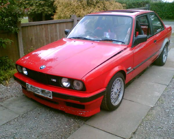

more progress!!! the 316 is now back on the deck :cool:

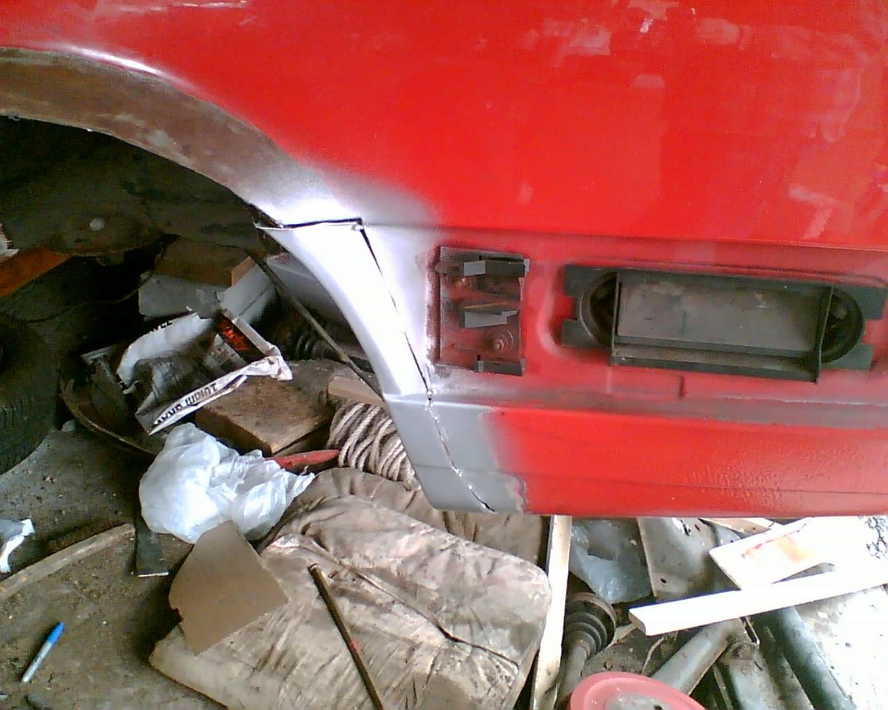

the rear underside is now all waxoiled and bolted back together. just that rear arch to tidy up now. sort out the new filler pipe and then its time to just give the front a quick look over and change the bushes. then sort the engine out ready for its first start.
Not seen it from this view for a long long time 8)

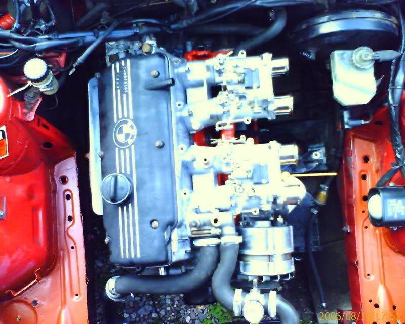

Tue Jun 20, 2006 9:37 am

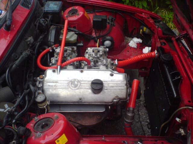

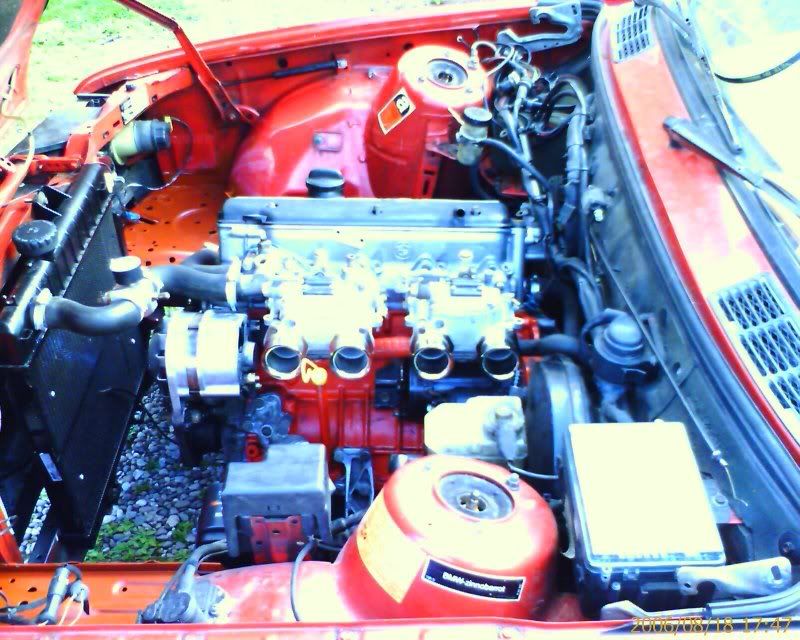

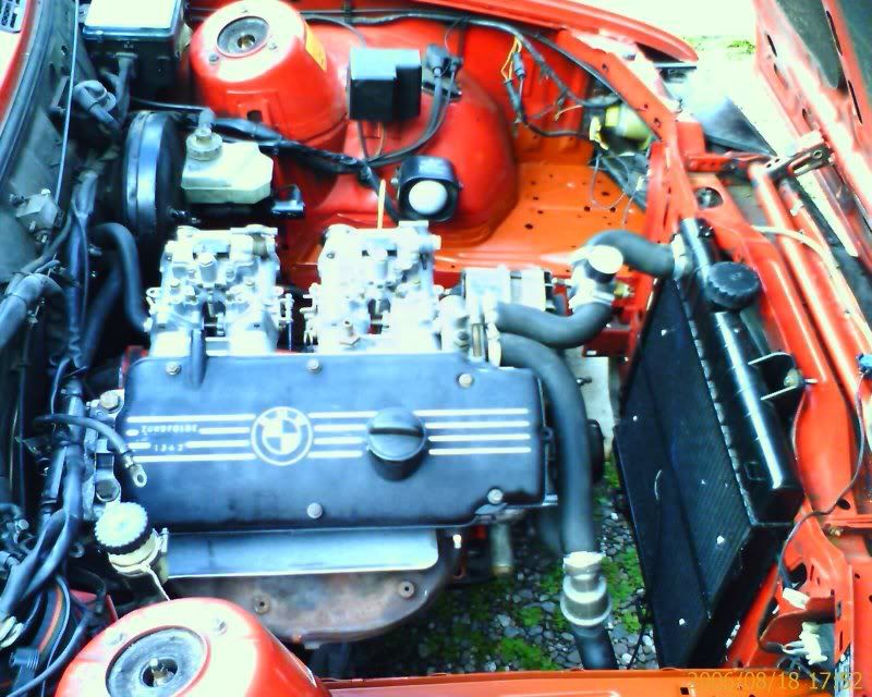

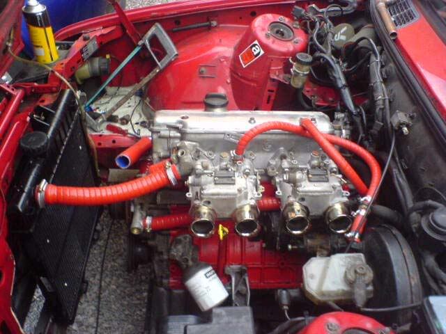

Abit more progress now, seem to be taking big chunks out of what needs doing at the mo.
Samco hoses fitted, just need to do the one from the top of the thermostat to the head casting. samco didnt give me the correct amount of pipe so im waiting for another piece. I was on a roll aswell!
IG: Si316ti
2.0L M10, Twin carbs, big cam
Full send restoration in progress
Toby_Unna
Posts: 2183
Location: Sheffield
Tue Jun 20, 2006 10:05 am
engine looks quality :D
what are you doing with the cam cover breather?
(as mine has just a pipe at the moment!)
Si316
Posts: 1810
Location: Cheshire
Tue Jun 20, 2006 10:10 am
Im going to just plumb it into a catch tank I think. I did have a little KnN filter that goes on the camcover, got fed up of cleaning oil off everything tho!
Thats supossed to be an MOT failure i think ?
I want to try to plumb my breather pipe back into my inlet so you could have my catch tank if you want ?

Argos wrote:You need to make up an adaptor on the air filter box and plumb the breather into that - it's a good idea for the engine to ingest it's own fumes. Even with a catch tank you will still smell the fumes inside the car and it stinks reeeeeaaal bad.
I'd imagine an air box from an old Alfa would do the trick and I can't imagine the carbs on those are spaced apart that differently.
Glad to see that rare 4.1 LSD is still nestling under the 316! :D
Which alfa would that be off mate?
The lsd has had new seals and a paint up and is under there ready, and yes its the very same block! I hope some of the soul of the rockingham taxi will shine through in my car :cool:
next step, find a ford edis-4 ignition system and order megajolt unit

Posts: 1810
Location: Cheshire
Sun Aug 20, 2006 8:09 pm
UPDATE!
got quite abit done to the car now. Its got all of its fluids, brakes and polybushes now.
all that it needs now is:
the facet fuel pump fitting with the new fuel lines
Engine electrics sorting and tidying up
paint in afew places where its been welded on the rear arches
heres afew recent pics

get longer trumpets on there 8) and decent filters (NOT sock!)
Looking good tho dude, looking forward to seeing this sometime. Got a bit of a sickness for old skool 8v lumps on a lumpy cam and carbs kicking the bigger boys asses :twisted:

Im gonna get some longer trumpets once I track down a golf mk2 servo so they'll clear. for now tho its 40mm ones and socks. whats wrong with filter socks? ive heard they give the best flow
