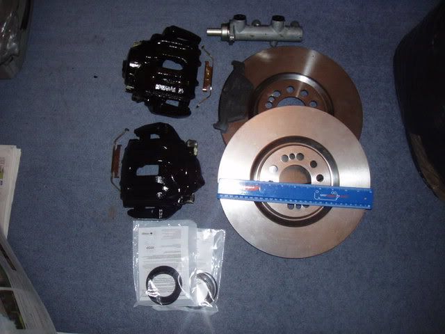

Apart from the mounting brackets and wheel spacers to fit my 17" wheels I have all the kit to carry out the 312mm Audi TT front brake conversion, including 750I master cylinder.
I have thoroughly cleaned, painted and re-sealed the calipers.

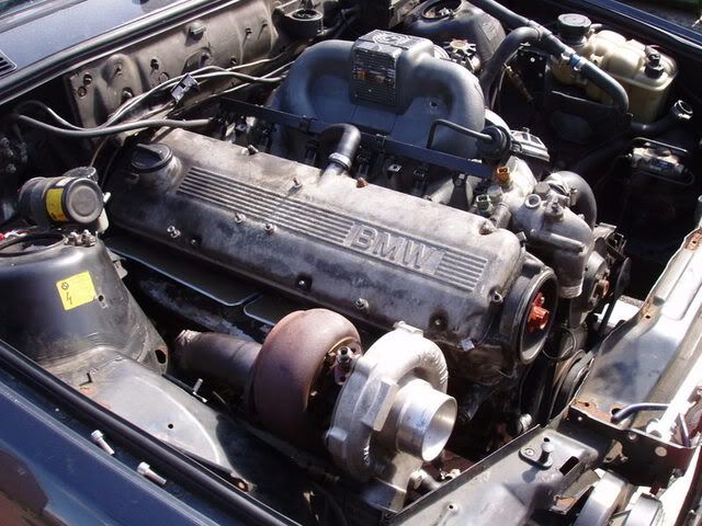

As many of you will have seen in the 'E30 Parts For Sale' section, and mentioned in various threads, Toby Unna made the decision to break up his 335i turbo for parts.
I had already started gathering parts to do a similar conversion when Toby offered me the chance to buy his turbo gear and Megasquirt set up.
I felt bad that he was breaking the car but if I didn't buy them then somebody else would have.
I couldn't resist, so that's where all of Toby's turbo equipment went!
I hope to start work on this very soon, my aim is to have my 335i turbocharged by mid summer at the latest!
Before we; Toby, Theo325, Andy335Touring and I stripped Toby's car on sunday (17th february), Toby took us for a drive.
If you read this Toby, I've replaced my wrecked pants now!
What an engine!
The work Toby has done on the parts is fantastic; well thought out, creative and definately effective!
I'll let you know how I get on!

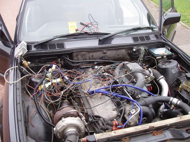

Nice box of wires, looks like fun !
Warp factor nine here we come !
I did label some of the pipes and wires, and some others are obvious but I'm still not looking forward to that part!
Should be ok though, I sometimes surprise myself, an advantage of being a pessimist!

E32 / E34 calipers, Audi TT discs and E32 master cylinder fitted:

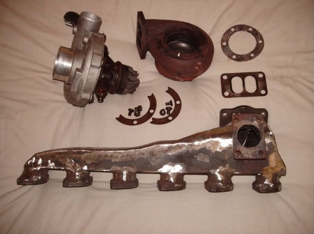

Toby's exhaust manifold - rough seems smoothed off, just to tidy it up a little:

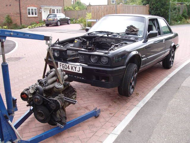

Engine out, again!

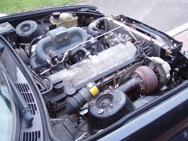

Sump and manifolds swapped and a big angry snail stuck on the side.

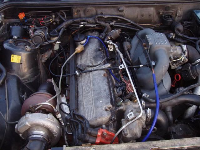

And back in the car:
And this is where it all went wrong, and the reason I missed the Santa Pod meet.
I had a nightmare over the last few weeks with wiring in the Megasquirt ecu.
I've called in the assistance of Ant, and only today I managed to pick up another M30 engine wiring harness from a scrapyard, so I'm hoping it won't be much longer before it's running again!
Here is how the car is today:

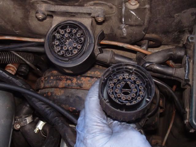

The only thing is, the E32 735i I got this engine loom off is different to the E34 loom I had before because of the pins in the C101 plugs.
I now have this, which I hope to sort out tomorrow:
Then I'm changing the rusty rear brake backplates so the handbrake works for the M.O.T., I'll also have to get the ecu mapped.
I'll let you know when I have any more news.

Thanks guys!
As Gareth said, the hardest work should be over with now, so I'm hoping to have it back on the road in the next two weeks or so, and no, I can't wait to drive it!
I'm keen to get in on a rolling road, drag strip and on a track when it's done, and see what breaks first!
