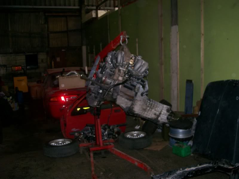

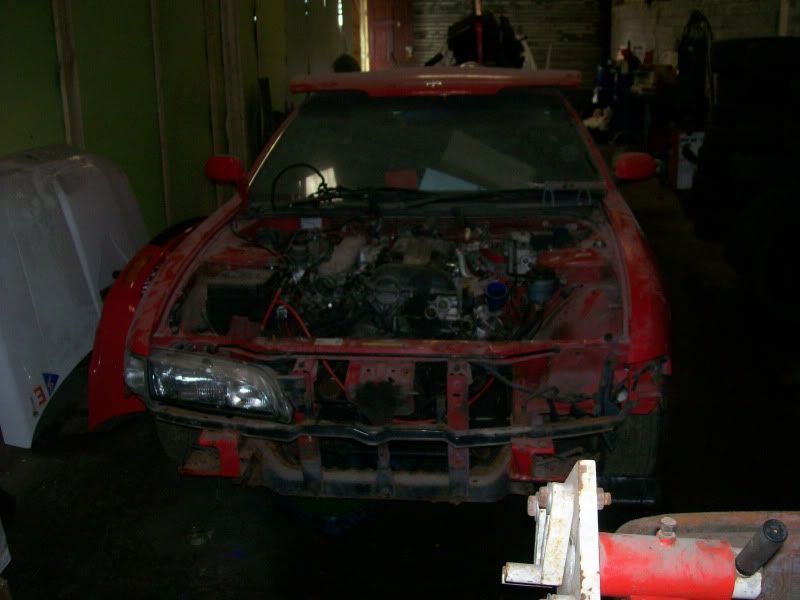

Well after much procrastination, I hope to follow in Theo's footsteps. This time the Nissan motor will go into a lightweight dedicated track car...
Donor car: 200SX. I bought the complete car, which was a daily driver when I bought it.
The SR20DET we hope to transplant.
M42 engine, box and loom removed.
The E30 sprint/hillclimb car I'm building - into which the SR20DET will go! Everything under the watchful eye of my 7 month old project manager!
More updates as we progress! :D
Alun
