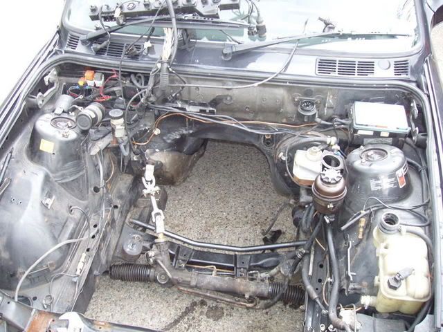

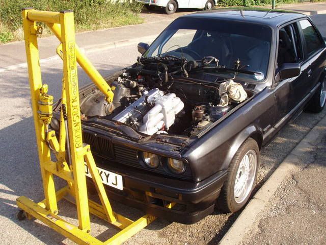

Update time! It's been a while since any major work so....
I have committed myself to the turbo plan! winkeye
Although today didn't quite go to plan.
I have four days off work this week and just two of them (today, wednesday, and tomorrow, thursday) to fit my spare M30 3.5 engine so I can remove and rebuild my (already rebuilt) engine to turbo spec. It's my only car so I need it to be running by monday morning, and I'm out friday to sunday! :?
I got delayed today and didn't get started until 1:30pm. But, in the lovely sunny weather, I worked like mad and, on the road and without air tools, I got my engine ready to lift out minus electrics, gearbox, clutch and flywheel, three and a half hours later. Well chuffed with progress! :D Apart from two broken exhaust manifold to downpipe studs! :roll:
I constructed my extremely heavy engine hoist, sweat pouring down my face in the heat, to find that the hydraulics had given up and it wouldn't lift the weight of it's own ram. It was fine a couple of months ago! :cry:
So, engine is still in and ready to be lifted out tomorrow, as long as my mate can get his engine hoist to me in the morning! :?
While the engine is out I also plan to replace my E36 steering rack, which has a bit of play in it, with my Z3 rack - to give a quicker steering ratio. Got a set of brand new E30 track rods and track rod ends to go on too.
I also plan to replace the horrid, naff looking, emergency fitted brake line across the bulkhead with a more subtle better routed pipe and bleed the brakes.
If anyone cares, or even if they don't, I'll report my progress tomorow!

That engine hoist looks a bigger feat of engineering than the engine conversion itself! Although I can't talk I'm usually making my own tools for specific jobs and the tools usually take longer to make than the job they are made for :D
Gone but not forgotten.
('92 325i Cabriolet)
DRIFTBOY
Posts: 3131
Thu Aug 02, 2007 3:38 am
Thanks!
It does seem quite heavy duty, even on it's longest reach it's rated at 250kg. I only bought it a few months ago off Ebay for about £53.

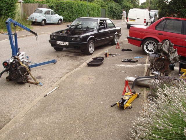

DRIFTBOY
Posts: 3131
Fri Aug 03, 2007 12:44 am
Thanks for all the kind comments everyone! :D
But Charlie, I don't have a nice dry garage to work in, it just isn't big enough so it's out on the road with a red raw gravel-rashed back for me! :(
With huge thanks to Theo325 (sorry about the t-shirt!) who kindly came round and provided a very helpful extra pair of hands today the spare engine went in very easily.
Can't say the same for the gearbox which proved rather reluctant to go on but we got there in the end!
My limbs are so stiff now I can barely move! I really should do some regular excercise! :?
I got most things connected back up but called it a day without quite getting it finished.
While the engine was out we also got the E36 steering rack out and replaced it with a Z3 rack with new track rods and rod ends.
As I'm out all day tomorrow (zoo) and saturday (zorbing) I'll have to finish on sunday. :(
