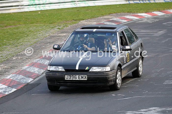

What no more of this sort of thing?Theo325 wrote:Furthermore, I saw some total sheds lapping during TF which was something they were supposedly clamping down on.
Shame

I rekon the Rover would be fine, Keri's Civic on the otherhand...
