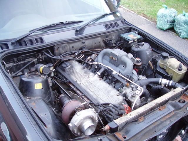

I've been keeping a bit quiet on here lately but here's how my car looks as of this evening:
I'm a bit bit puzzled over wiring and intercooler mounting and plumbing, and as I'm fitting Toby's old turbo gear I'm doing some research!
Only thing is I'm not using his M5 i.t.b.s so I need to change a few things as I'm using his original inlet, so that adds to the difficulty of wiring and plumbing stuff up now!
How are you doing?

Not bad fella, not bad. Hope all is well down your end as well.
The day before yesterday I was wondering where you'd got to, then I saw you post something, albeit unrelated to this.
Turbo setup is looking good, fits so nicely in there. I realise 'nicely' means its probably a frigging pain in the arse to get all the charge pipes hooked up etc.
Will it make the pod?

The car (as an n/a 335i) only came off the road monday evening, so yeah it all fits very well! I've got this week off work and decided to go for it!
I've not shouted about this mostly because I can't take much credit for it.
Toby did the hard work getting it going in the first place, I'm just fitting it to my car!
It isn't a small job all the same, I've had the engine out and back in this week, but Toby did the really hard work, as seen in this thread!
I've slightly altered a few little bits, hopefully to improve an already ingenious creation, including bigger injectors, which was an issue.
My plan for tomorrow is to fit the intercooler, exhaust, fuel pump, change the oil filter and start on the wiring.
The intake plumbing could be a head-scratcher as i'll have to change things a little, but the pictures I've saved from this thread just now should help a lot!
