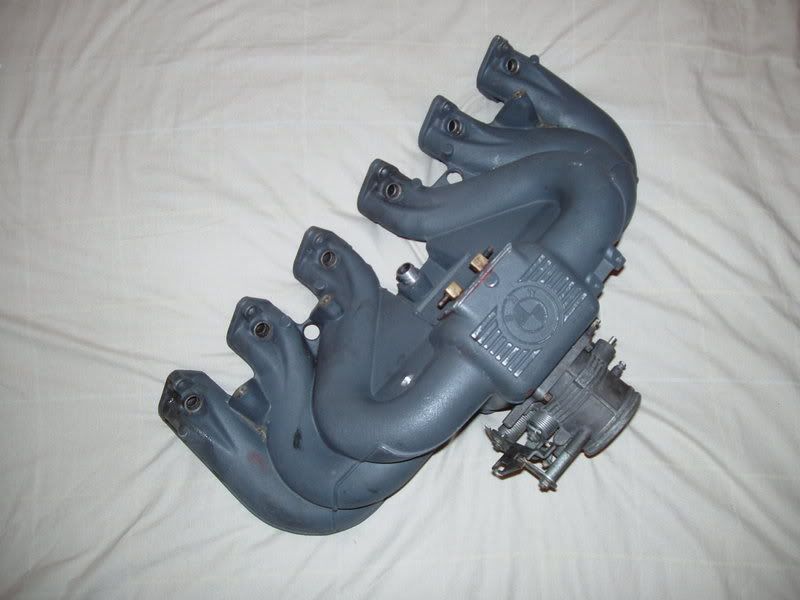

I might have a long-term plan for mine too!
I'm not shy about it, but I'll give you a clue!
So far I just have this and potentially a fuel pump (from a friends modified Supra ?). I bet most of you can guess which way this is going!
Eventually!
I hope the project goes well and we find out what it is asap!
Eventually!

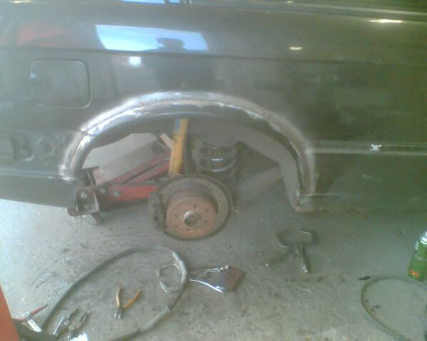

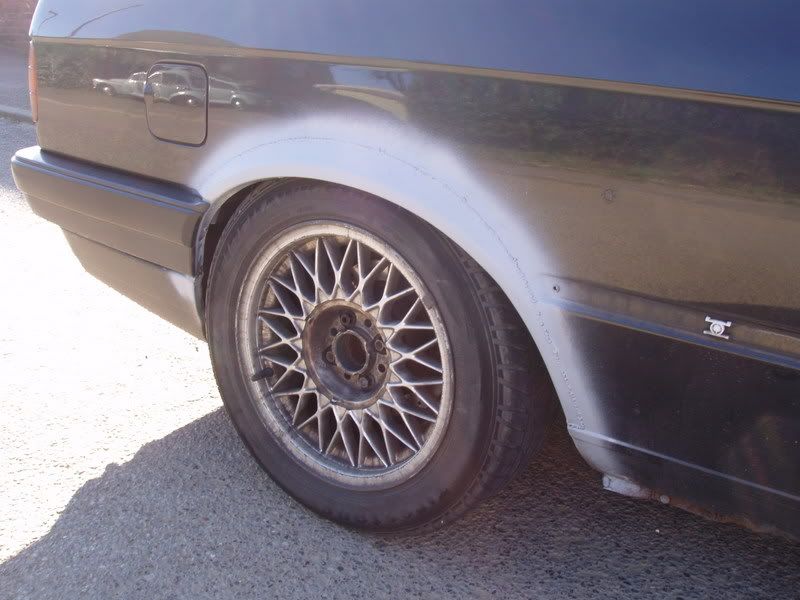

Another update!
Had to fit my spare alternator this week as my original one stopped charging the battery, a right pain in the mornings and after work getting people to jump / bump start me!
I found the cause of my dramatic oil leak today - a cracked lower timing cover!
I must have been a bit brutal with it getting on with the sump in place the other week!
But I have got some good work done this weekend too, well my mate who's a bit handy with a mig welder did most of this!
(First two pics from my phone so not best quality).
Bodywork is being sorted now over the next few weeks or so I hope. Going for a total re-paint too.
Hopefully it will look a lot smarter soon!

bought my six branch for the m30 today
should be here in a week ant has ordered my cam and springs too!!!!!!
soooooooooooo excited feel like a kid again
Stuart
Stuart

Oops, i missed your new post Martin, shame about the timing cover, is it weldable ?
Stuart, which six branch and cam are you getting ?

hi andy cam is a 284 cat cams with schrick springs head is now fully gas flowed ported polished with three angle valve job six branch is 1 5/8 primary race manifold for e28 m535i from the states will have to modify slightly but would have to modify any manifold even the btb one to fit the 2" race system had fitted to my m20 previously having the pistons pocketed and full lighten and balance on bottom end inc flywheel clutch front pulleys etc etc
Got well carried away
Heard yours is making good power
Stuart
Stuart

Just thought i've got one on this spare bottom that no one wanted to buy, trouble is getting the time to get it off at the mo
How much of a rush are you in ?
Just looked on the ETK and it's suggesting it's about £80 from the dealers, just an idea if you are desparate to get one quickley ?
Stuart, you are probobly going to need to mod that six brach lots unless your car is LHD ?
Sounds a nice spec' engine, should go well

I know needs loads of modding mate but was not gonna pay £750 plus when i can get one cheaper and mod it myself
Plus think that talking to ant has convinced me to dump the a f m and sort the management out too ( digging myself a very big hole with the bank manager lol)
Martin really appreciate you makin the time mate:D
Im gonna hide the manifold
Stuart
Stuart

Can't fault you, the BTB one is very nice but £Â£Ã‚£ V's BHP gains isn't so hot.candyman wrote:I know needs loads of modding mate but was not gonna pay £750 plus when i can get one cheaper and mod it myself
Nice move with the amount of mods you are doing as you will be able to tune(and re-tune) to suit your mods.Plus think that talking to ant has convinced me to dump the a f m and sort the management out too ( digging myself a very big hole with the bank manager lol)
Im gonna hide the manifold (from the mrs)![]()
