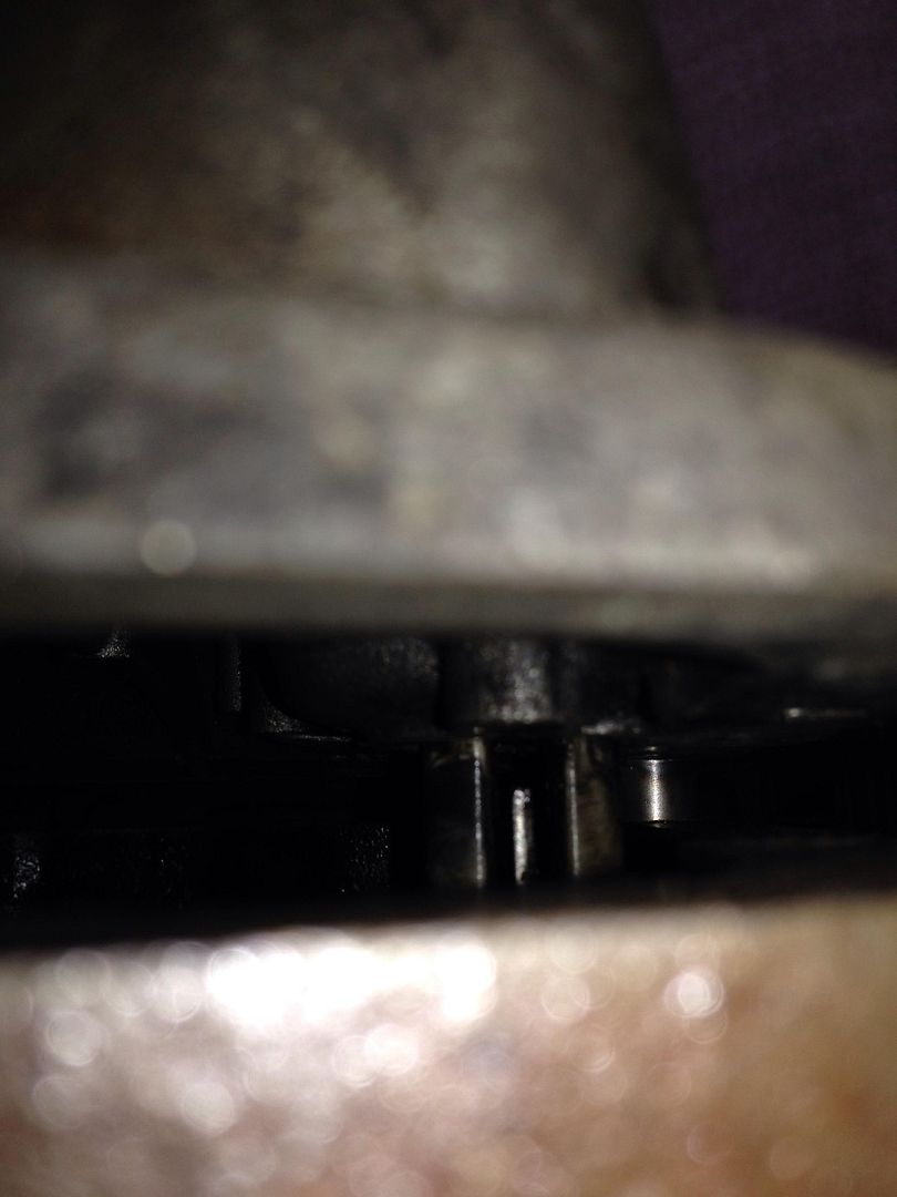

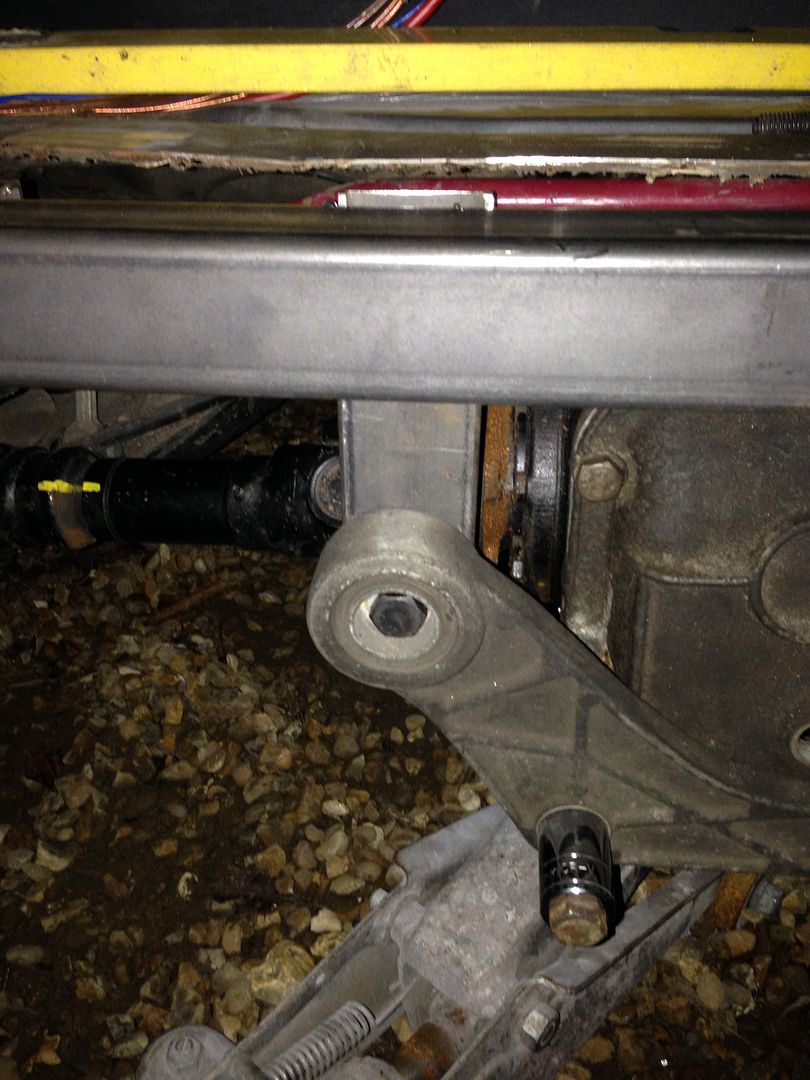

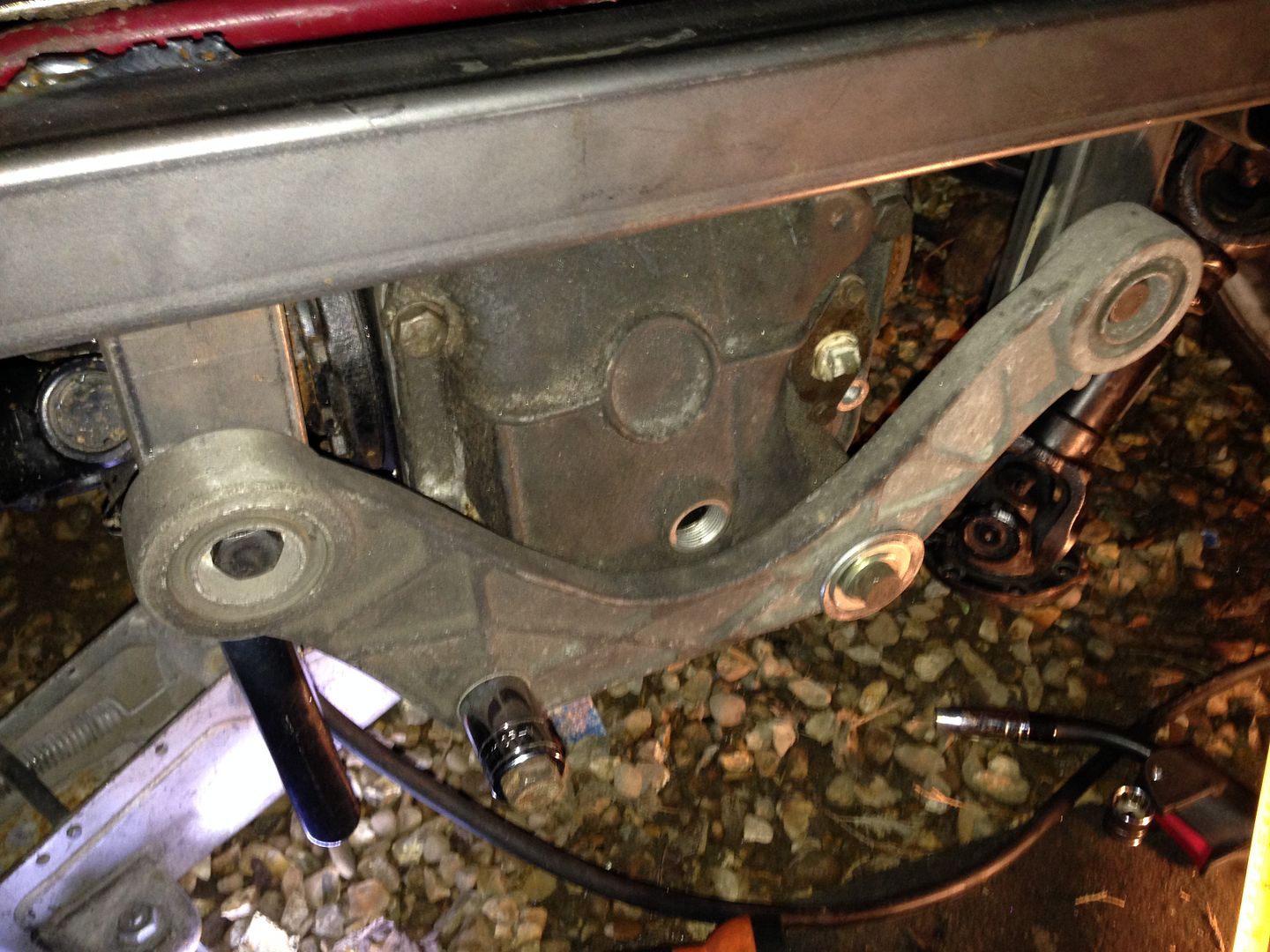

Might be worth while looking at an e36 trigger wheel for the diff mate,
I had to use one on mine when I fitted the twin ear rear cover,
As I had about a 10mm gap before the cover could go flush.
ross2009
Posts: 2762
Post Mon Feb 17, 2014 11:42 am
would do mate but I ain't taking the diff apart lol

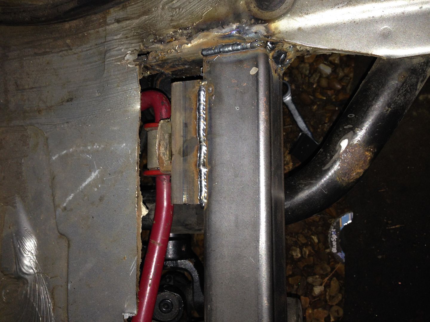

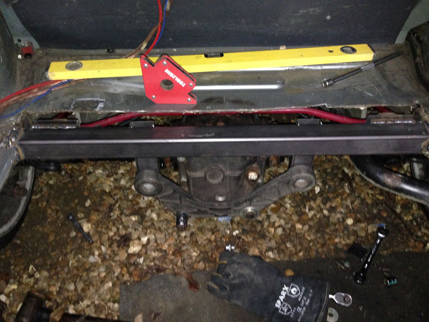

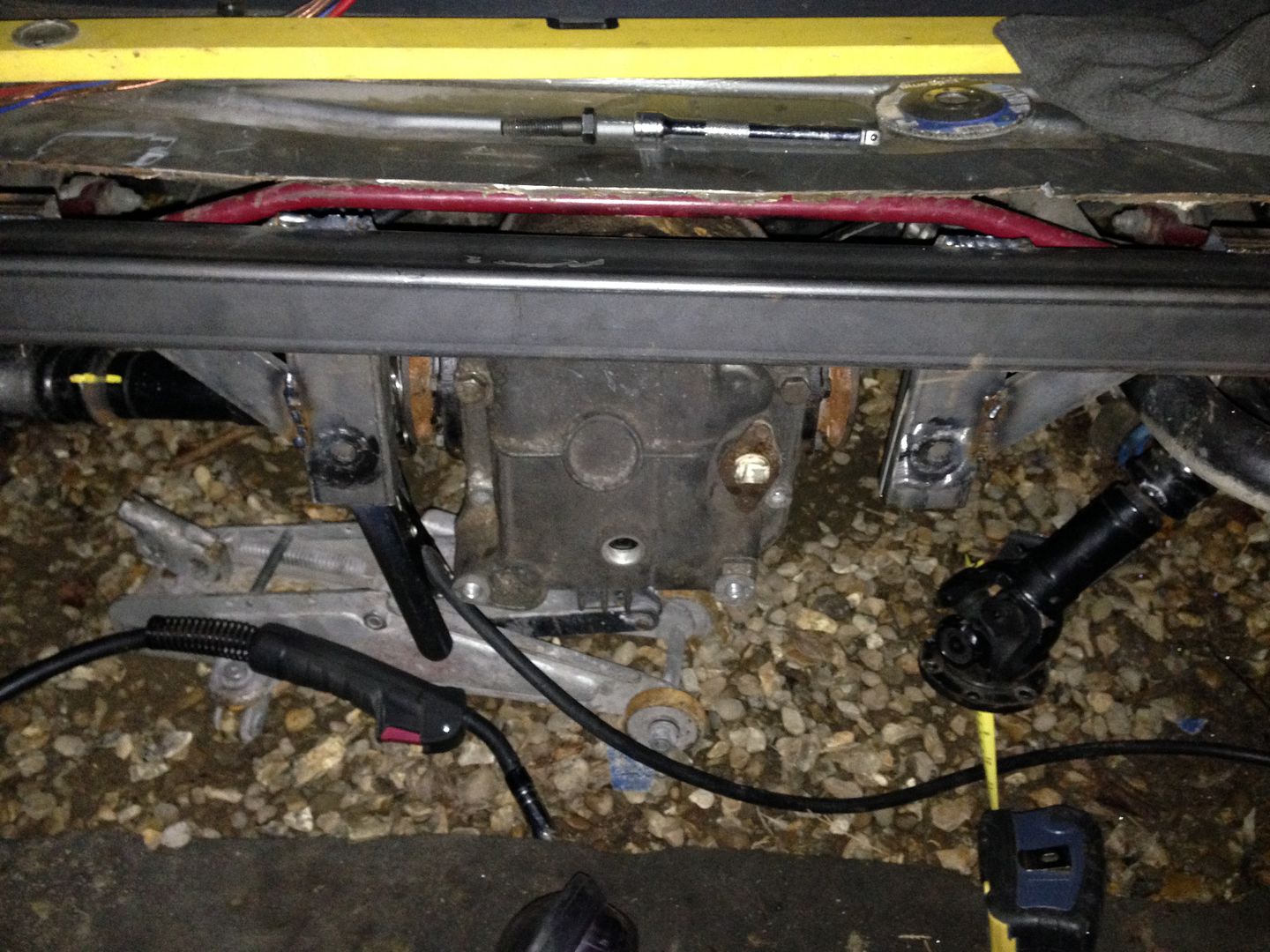

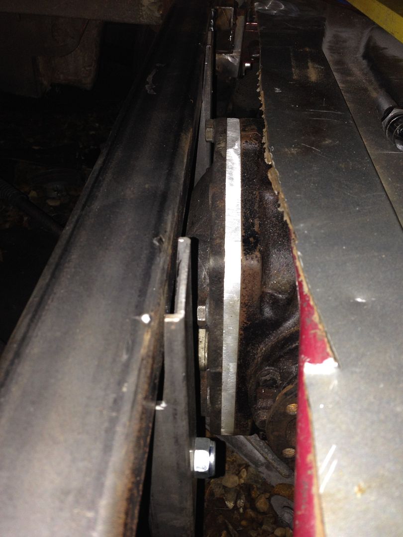

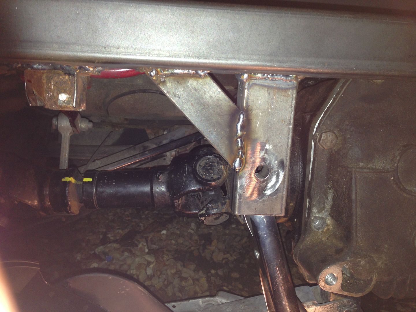

as i mentioned yesterday about the rear cover is going to have to be spaced bk i just cut some tubing up to represent the spacer of 10mm and it works fine
just a little pic of the gap and where the speed sensor now sits
so ive ordered the material for the spacer which should be here the next couple of days but in the mean time heres a couple more of that ive done today

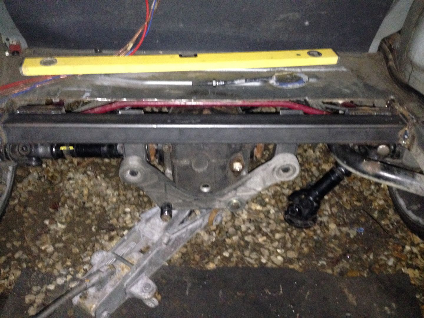

also had to reattach the rear anti roll bar mounting points
but the rear cross member is all in and welded and the drop links are tacked in place dont have pics yet as my battery died on me on my phone will get some more tomoz with more updates

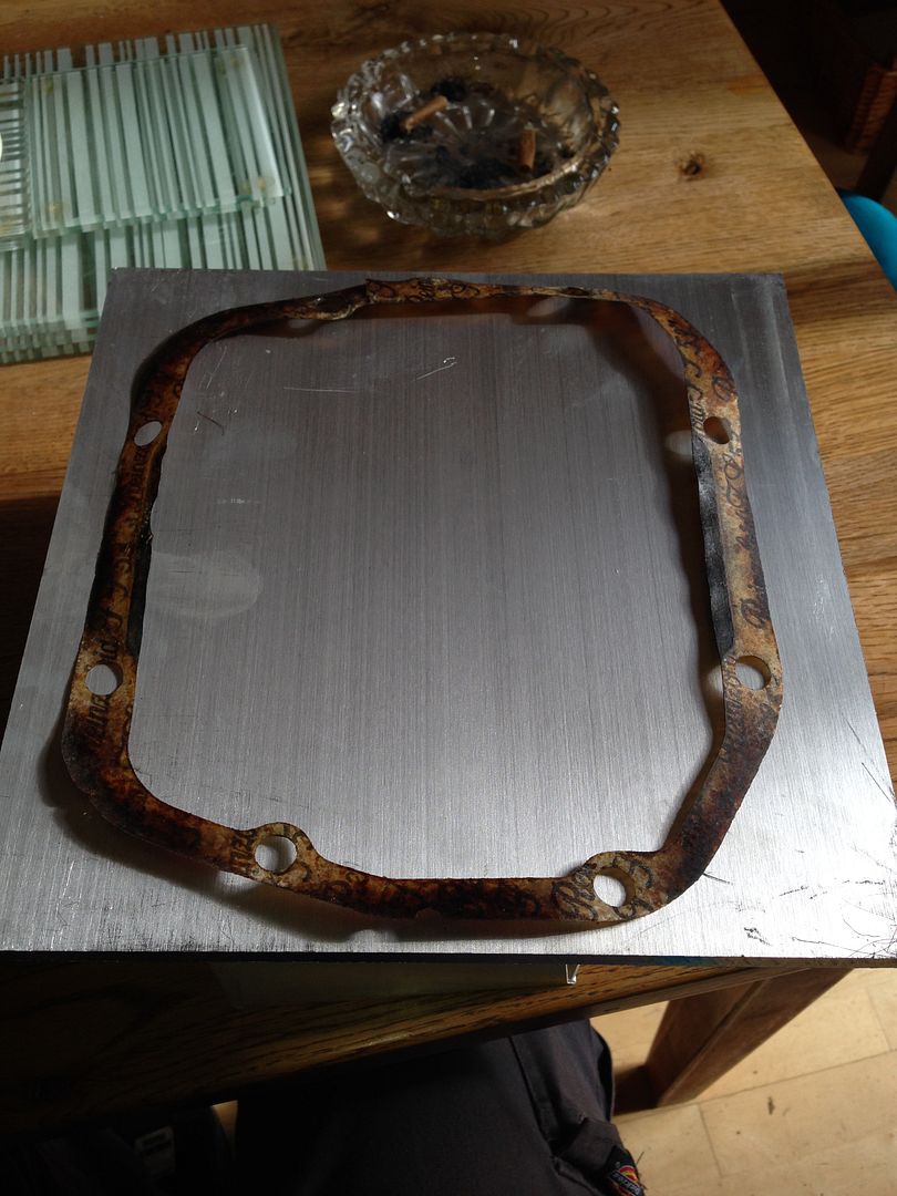

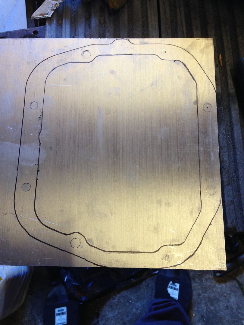

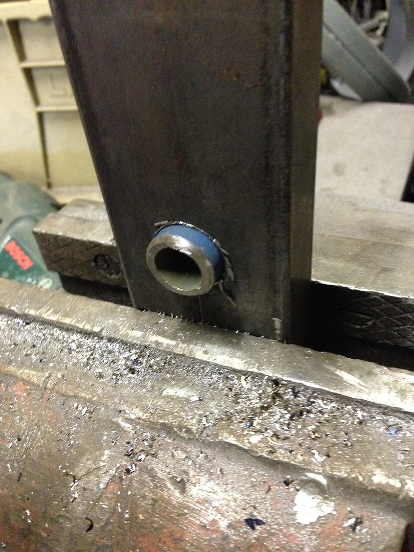

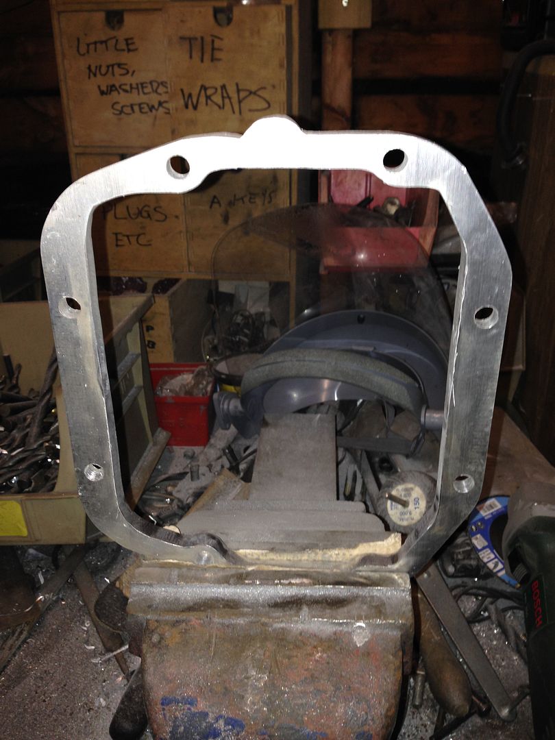

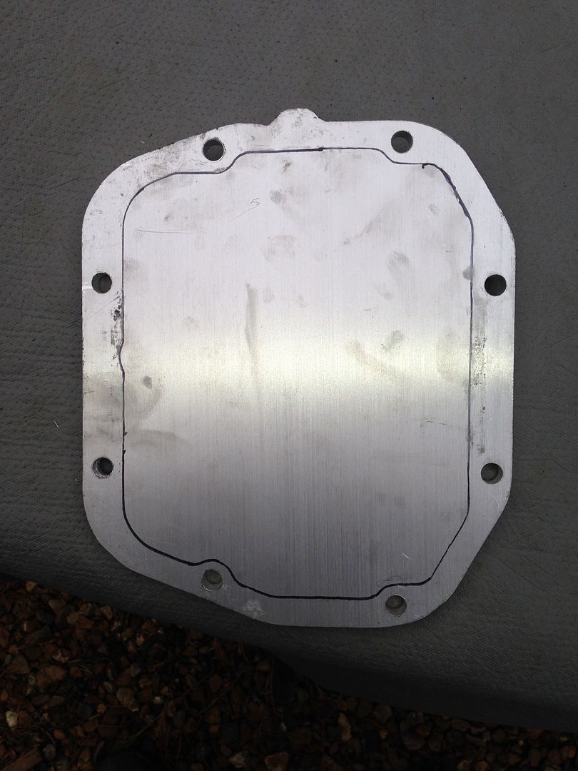

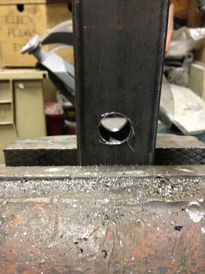

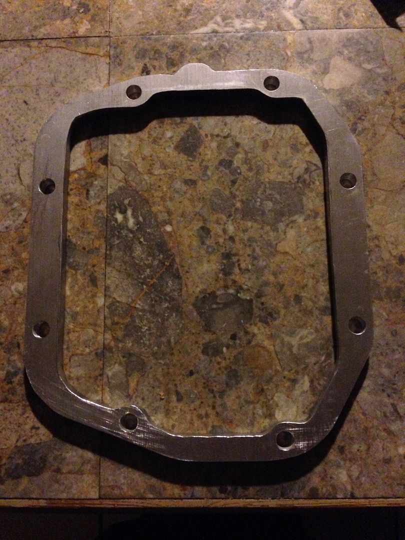

material for the rear cover spacer came today
so i jumped straight on to it to get it done basically just used the old gasket as a template
after taking the grinder to it
and after grinding drilling sawing sort of got the middle bit out
and after about 3 hours its done
just gotta buy 2 new gaskets for it one either side and should be good to go

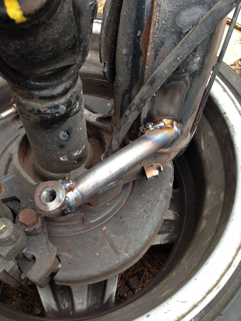

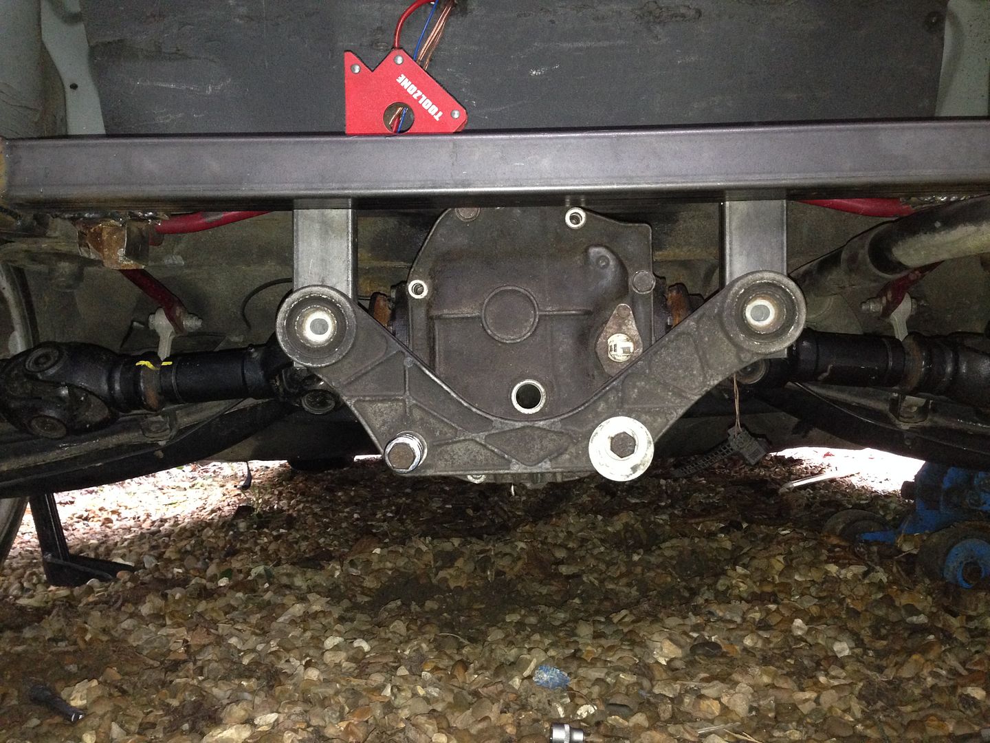

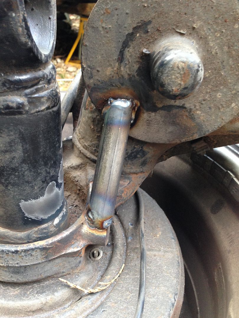

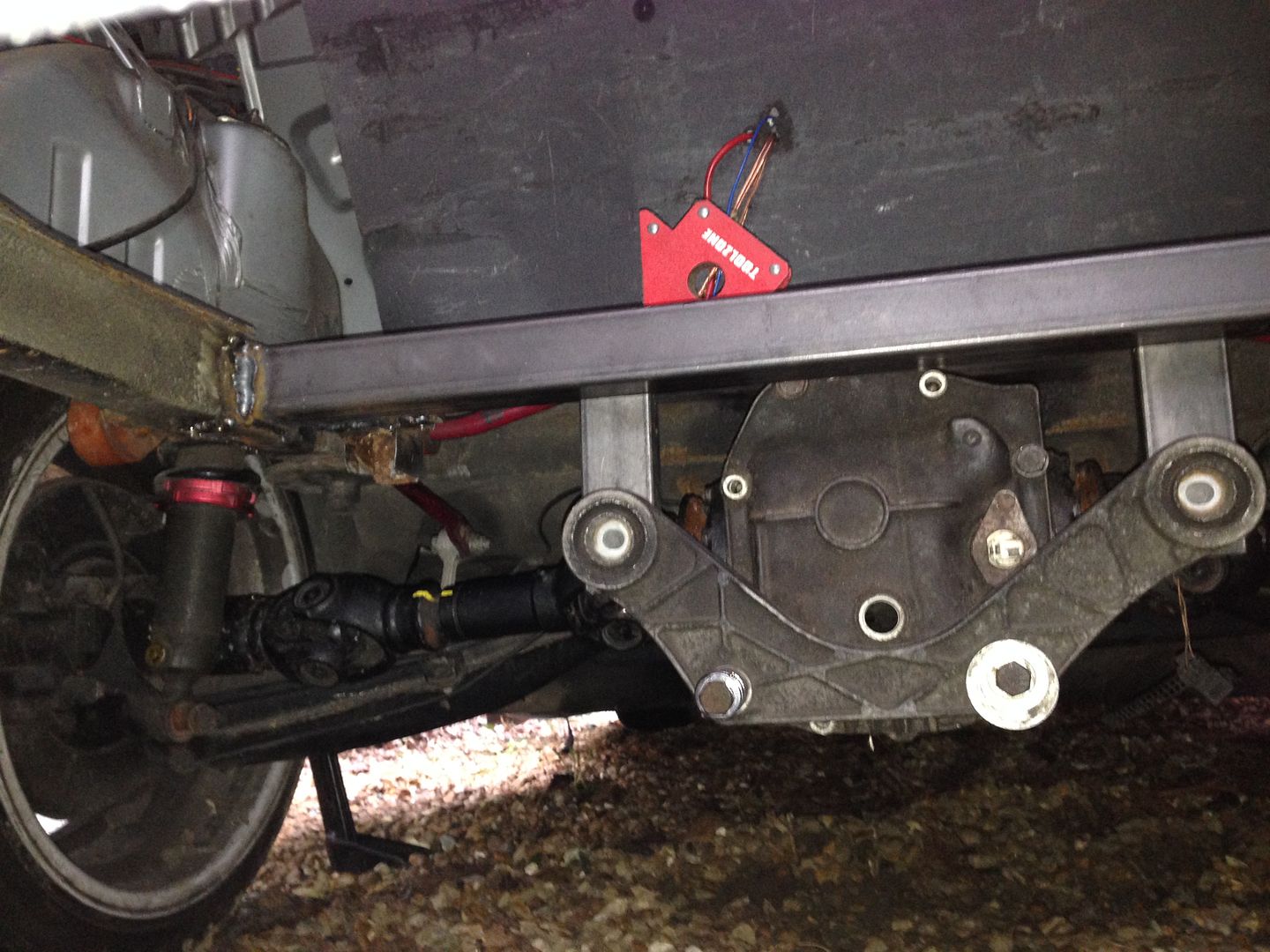

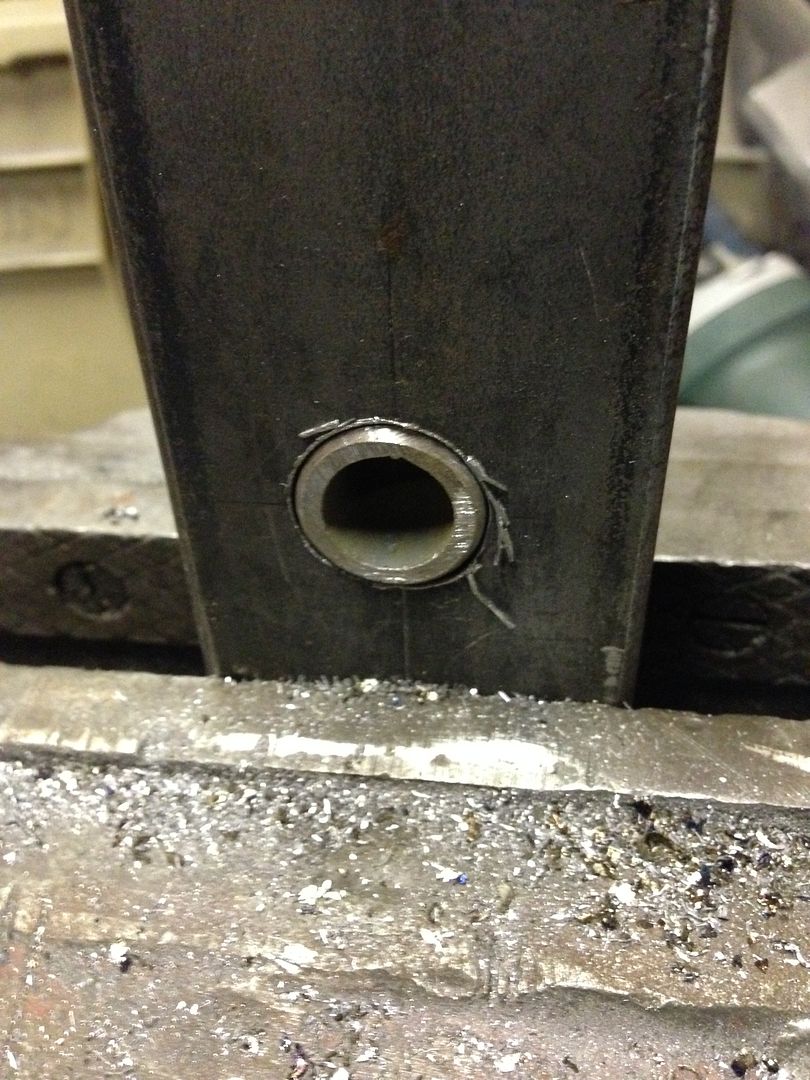

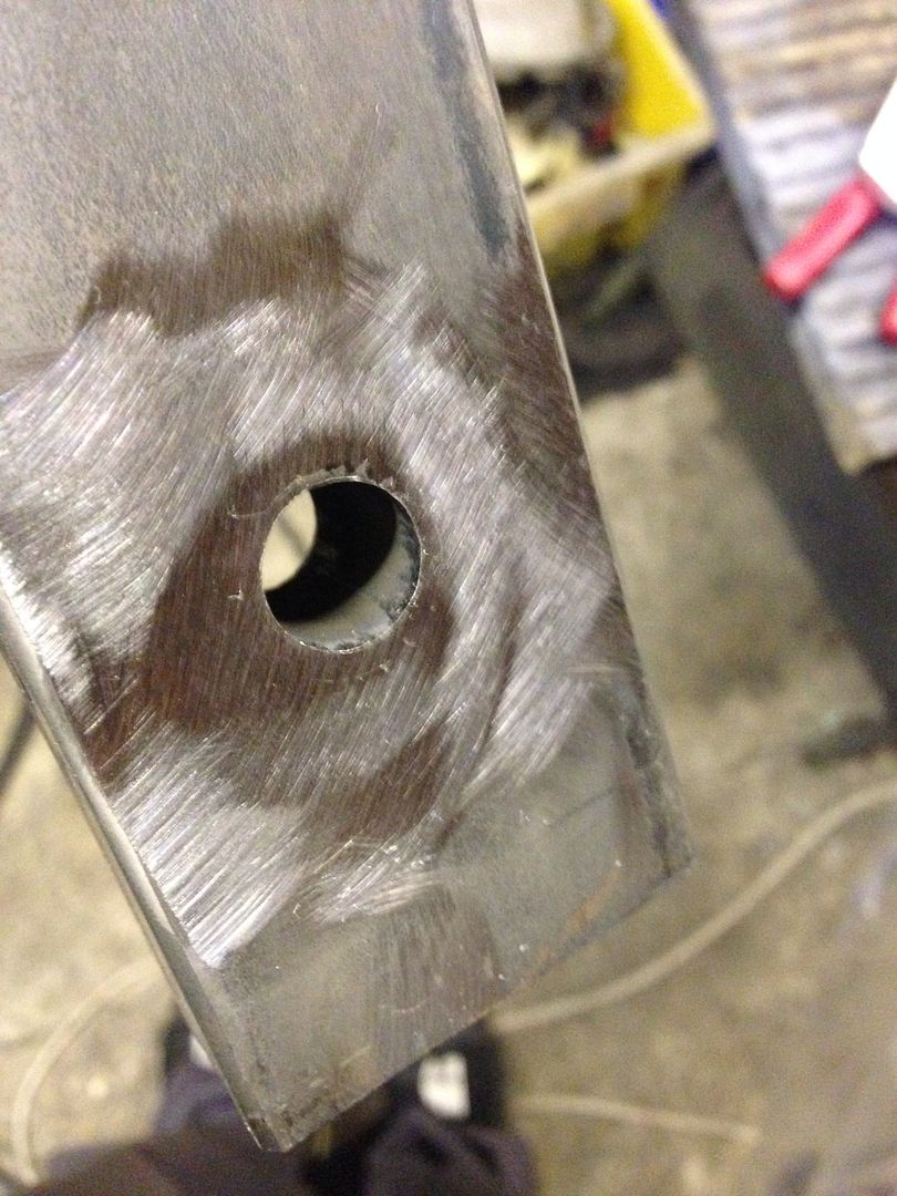

finished off the drop links for the rear diff coverjust a little reinforcing
as fitted my rear cover spacer i made fits good
and basically just welded everything together

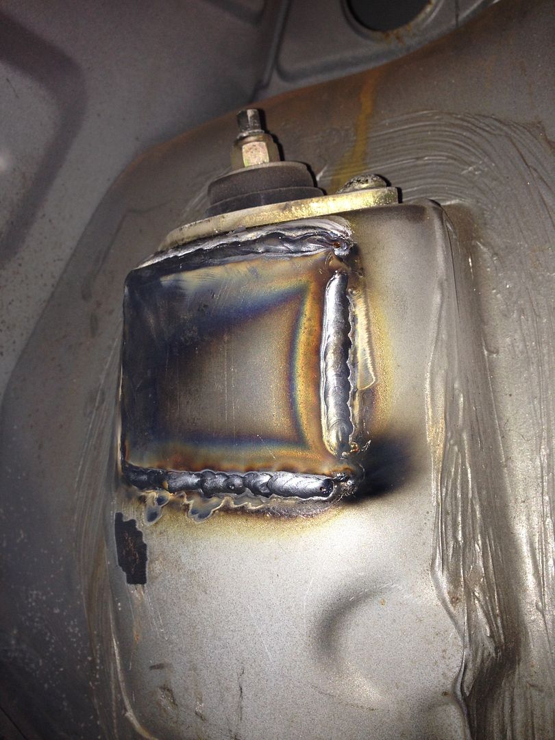

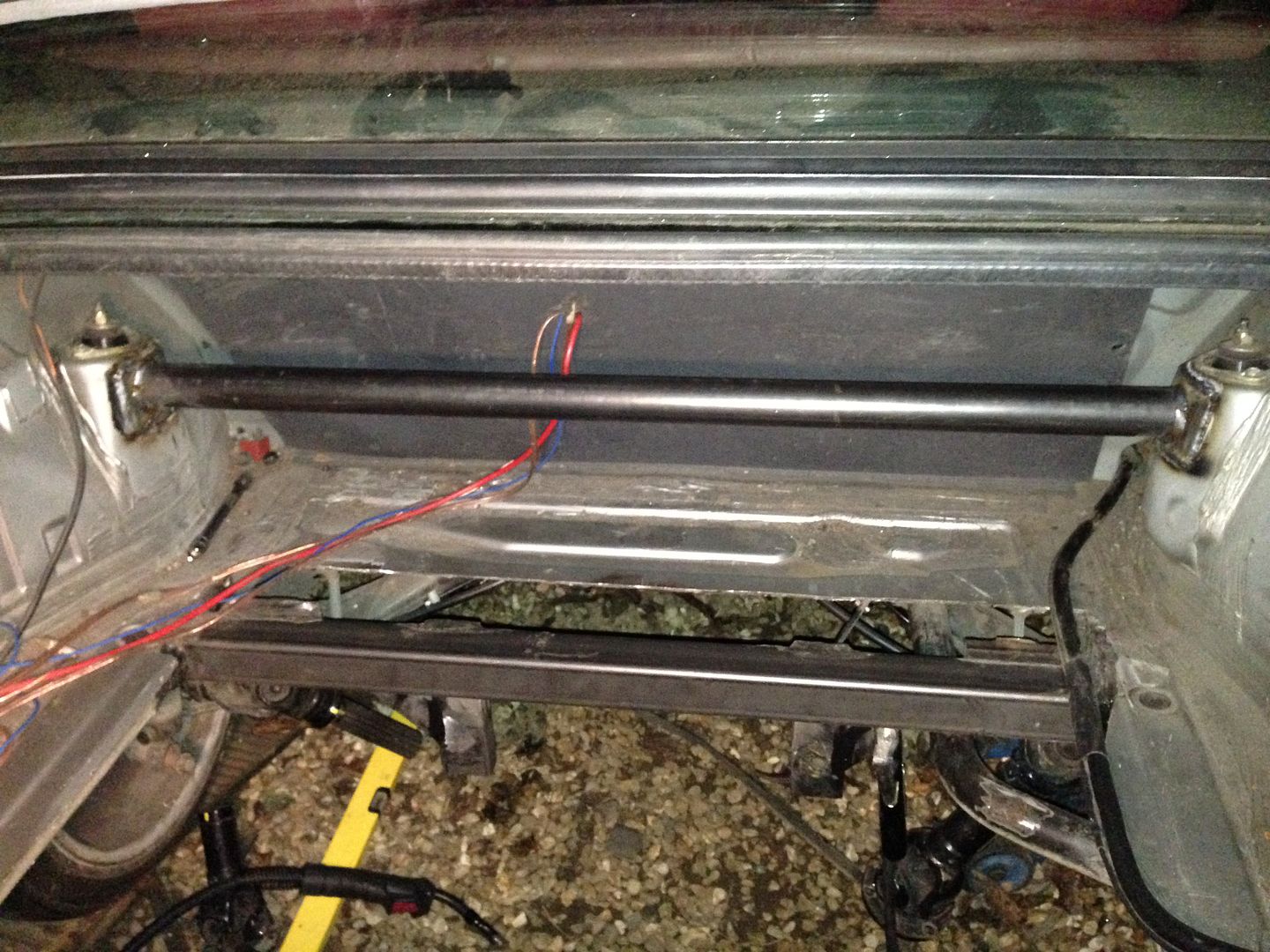

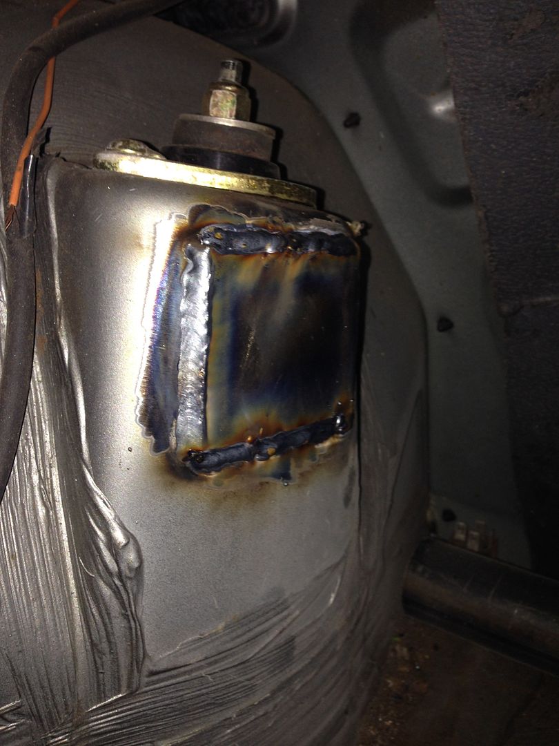

next job im going to weld in like a mini roll bar across the rear struts and reinforce the strut tops
then the rear is finished ready to be all ripped out cleaned up and all put bk together with the new rear beam thats the weekend job :)

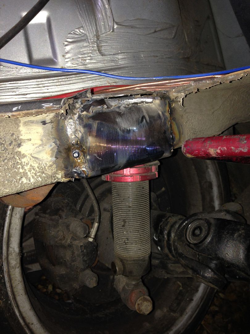

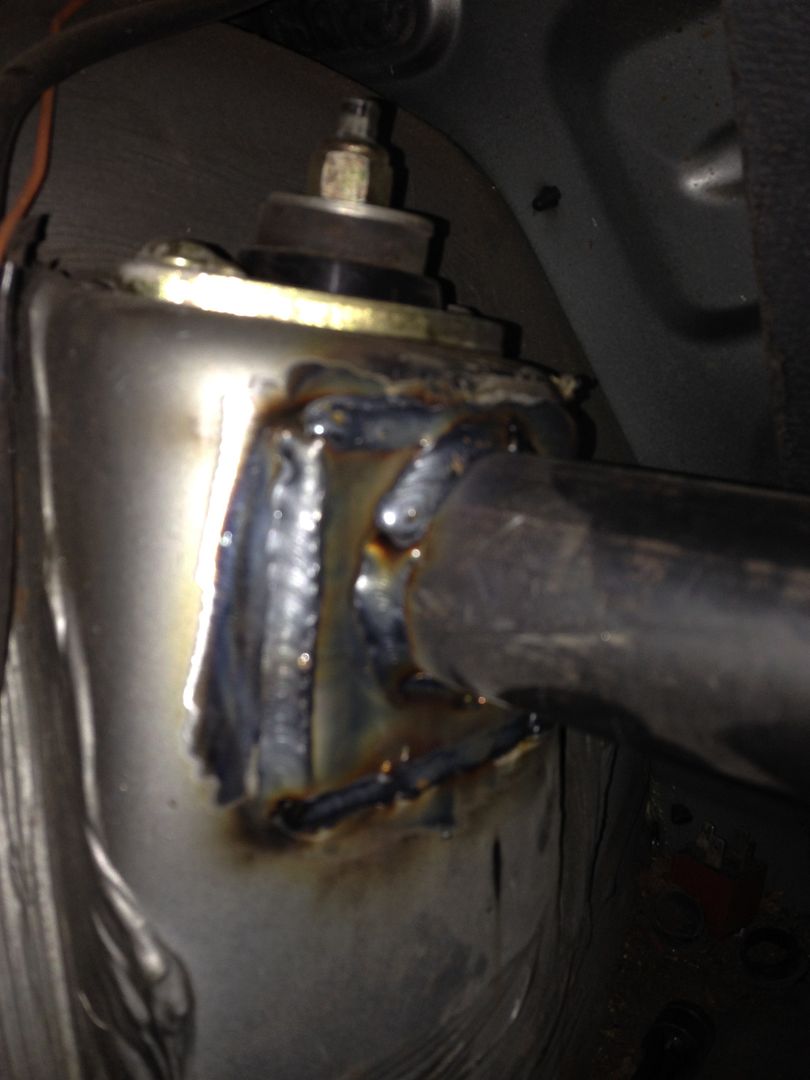

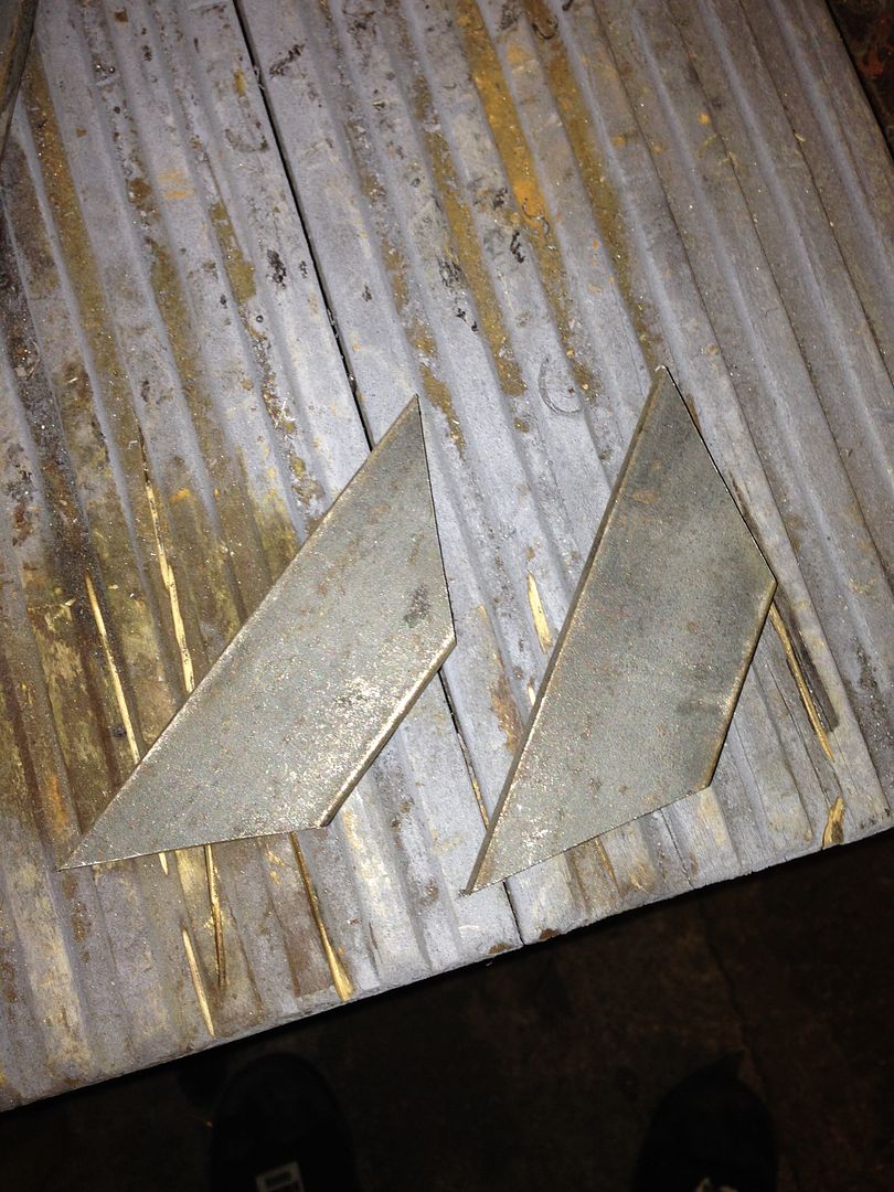

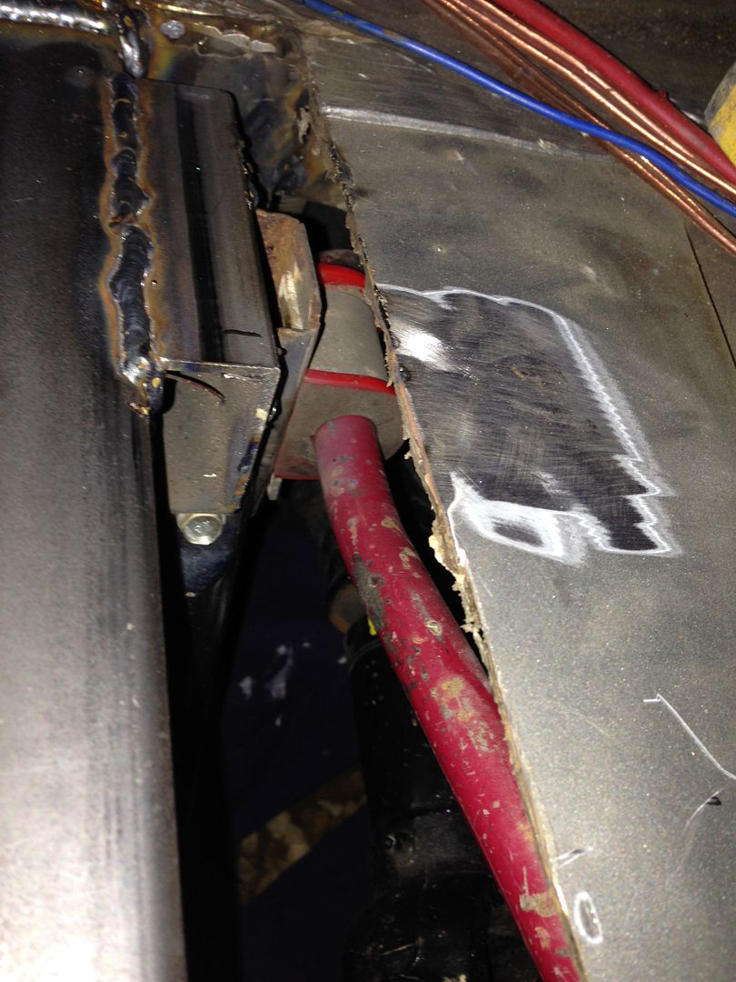

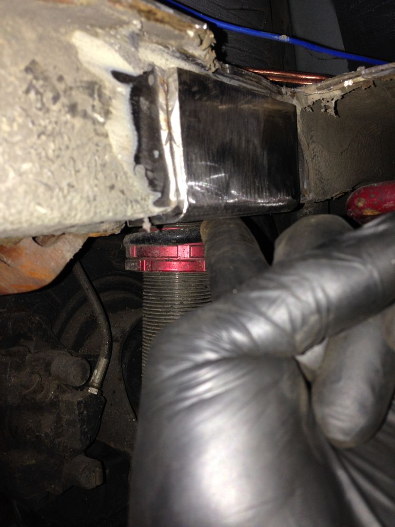

basically just a clean up day today rear cross member is near on done so i started with the rear strut bracing ,
got the first piece in, im thinking of tieing in the cross piece with the new cross member ive just put in for added ridgity

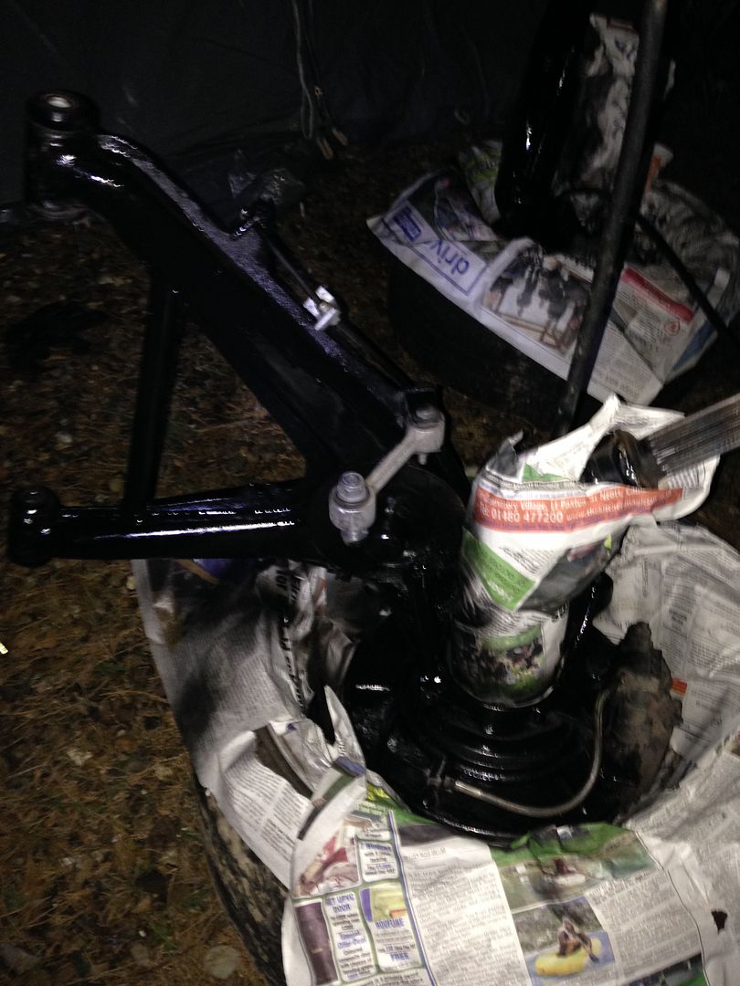

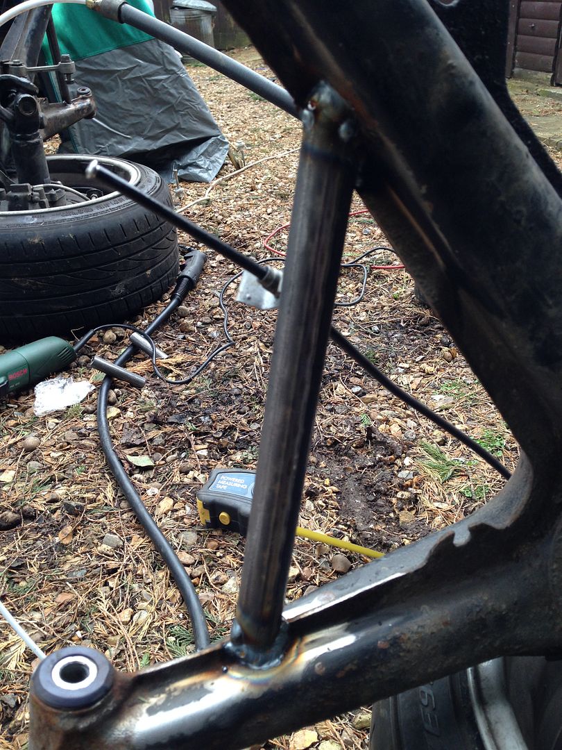

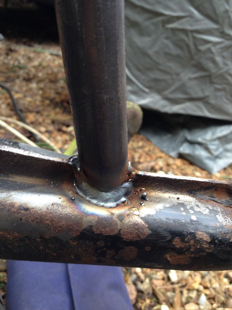

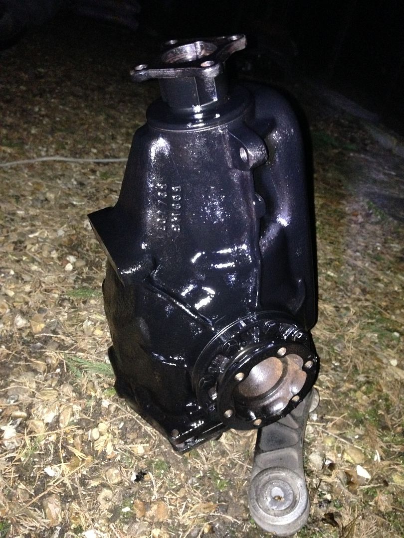

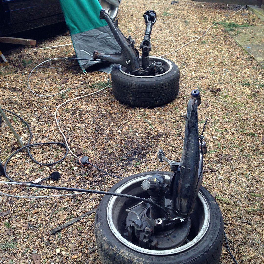

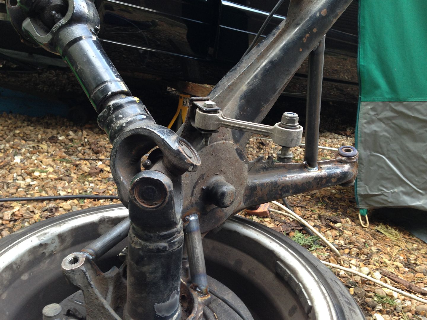

well finished work today and jumped straight on it ripped he whole rear out beam diff trailing arms the lot
and set about doing the trailing arms like they do on the group a spec cars strengthening wise
also cleaned the diff and the trailing arms up and gave them a lick of paint
tomorrow it can all go bk in and then the rear end will be complete and finished :)

I notice the driveshaft UJs appear to have grease nipples. 8O I didn't think those were fitted to cars after about 1980. :?

Speedtouch wrote:I notice the driveshaft UJs appear to have grease nipples. 8O I didn't think those were fitted to cars after about 1980. :?
yeah they do there on there so there serviceable after all there not like cvs that just have there own grease laying about
I don't mind what they look like they do the job and are bloody strong I think they were built to handle like 1400 bhp and came off a e30 drag car the guy was changing all his drive line so were no longer needed so I had them

Don't know if your fuel tanks in the boot but if it's not then the brace you have welded in the fork of the trailing arm is in the same space as the rubber filling tube to the tank, it will still go but might rub if not guided abit, ask me how I know...:)
ross2009
Posts: 2762
Post Sun Feb 23, 2014 8:16 am
o really ok thanks for the tip mate I'll look in to that I take it you done it and it rubbed thro lol
