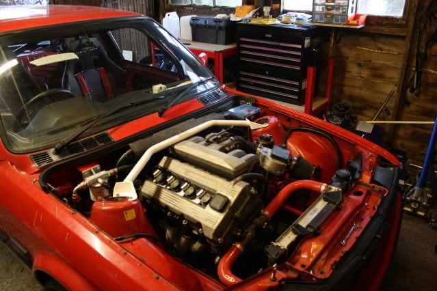

Radiator and hoses fitted, coolant in, bled up, lovely. Looking good again:

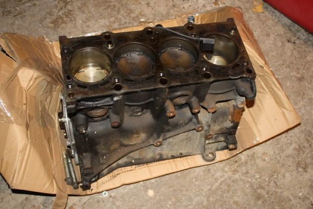

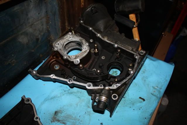

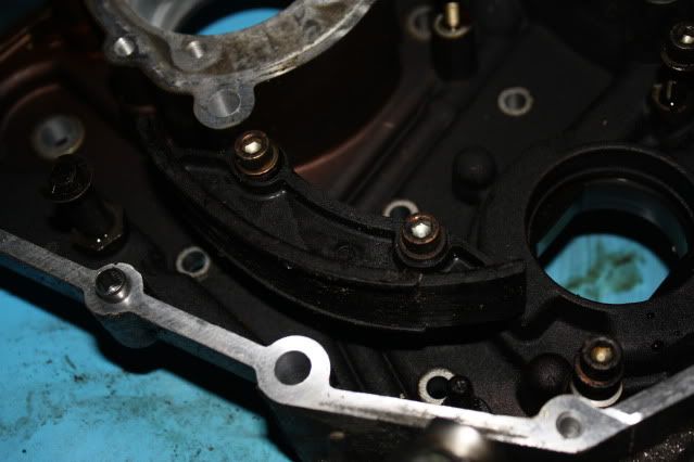

Well today I took the 2hr trip up to Leamington Spa to pick up an M44 block and bits from Odbod for this hybrid engine.
The timing case that came with it was a bit of a double wammy. It was from an M42 so has the lug for the CPS but also has a guide instead of the idler pulley for the timing chain:
I've got so much else to do with the car I'm not going to crack on with it straight away but I will be tinkering with it from time to time :)
The one question I have if any one can help is how do you safely store a block without the bores begining to rust?
odbod
Posts: 298
Joined: Mon May 08, 2006 11:00 pm
Location: leamington Spa
Post Sat Feb 06, 2010 7:38 pm
lots of wd40, and regularly I've stored it for 6 months like that!

GeoffBob
Forced Induction Specialist
Posts: 1843
Joined: Tue Apr 28, 2009 11:00 pm
Post Sun Feb 07, 2010 8:14 am
rix313 wrote:The one question I have if any one can help is how do you safely store a block without the bores begining to rust?
Paper towl spayed with WD40 bunged down the bores.

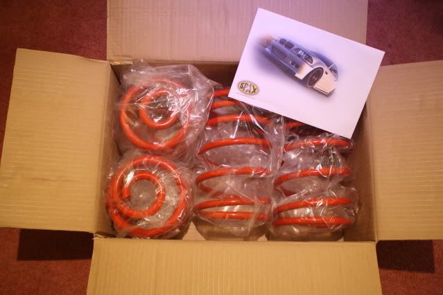

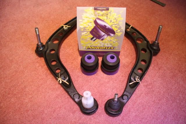

Well it’s been a while. I hope this isn’t too boring :D After discovering my steering rack was leaking I set about making a plan. During my post shake down check over I was looking at the front suspension and just thought ”˜to hell with it, overhaul time’!
I got a shopping list together and set about saving back some spondies to buy all the bits. My shopping list consisted off:
- new Lemforder wishbones,
- Powerflex eccentric purple poly wish bone bushes,
- a replacement offside adjustable damper,
- a set of -60mm springs all round,
- new steering rack.
It all arrived end of last week :)
I’ll be stripping down the front struts and sending them off along with the lollipops to get them powder coated. Once they’re back I’ll be putting it all back together and will have a nice refreshed front end!

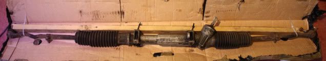

On the steering rack side of things I couldn’t decide whether to get an exchange recon PAS rack or do an E36 rack conversion to lower the lock to lock ratio. After some thought I remembered hearing that a few racers had or have manual racks. I quite liked the idea of a manual rack because:
A. I can save a little bit of weight doing away with all the pipe work, pump and associated ancillaries.
B. It’s one less thing with high pressure fluid running through it that could fail.
I decided to get a manual rack and Chris-w sorted me out with one:
The issue with the manual rack is that it would obviously still be the 4.5LTL ratio which is hardly desirable. Subsequently I've sent it off to Quaife to let them check it out and make a quick rack and pinion for it :D going to have something like 2.5 like the Z3 rack.

Post Tue May 11, 2010 10:15 pm
Well it's been a while. After a rather inspiring weekend working with the Kumho Tyres BMW Championship I have a burst of energy to get this suspension sorted, only took 2 months :o:
Hit it hard and after a couple of hours the car was off the ground and the front wisbones and struts were off along with the rear dampers for the new top mounts:
Ball joints look suitably buggered:
The ARB looks a little rough too so I'll be popping that off for a spruce up and will get some poly bushes and new brackets for it as well as some new drop links.
Hopefuly it'll all be back together soon :D
