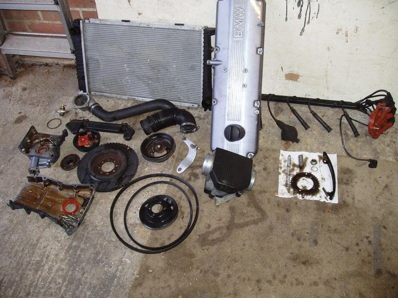

Thought I'd do a bit of engine surgery today to try and get rid of my annoying rattle.
Was replacing (things I should have replaced in the first place
) the timing chain tensioner and slipper pad, camshaft sprocket and while I was there thermostat.

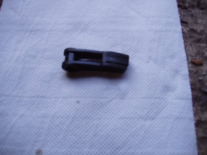

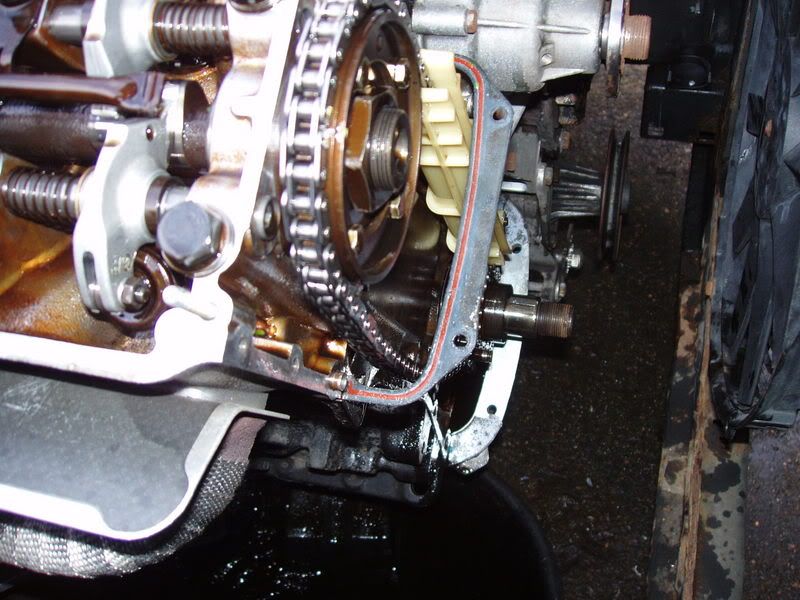

Then I found this -
It's a broken tensioner for the small oil pump drive chain.
Was just hanging there with the chain flopping around!
Don't know yet if this was the cause of my rattle or not, I expect I'll have to order a new one from BMW and blag lifts to work and back this week!
Also, the crank pulley is in two parts hels together with 8 x 8mm bolts. Even though I had tightened these to the correct torque setting I only had 3 finger tight bolts left in it!
Then I found this -

I've not seen one of those broken before ? Erm, i'm guessing the metal leave spring things and the rest of the plastic bits will be in your sump ?
It's more comon to see the plastic chain guide in bits because the plastic goes brittle.
Did you have fun getting the big nut and vibration damper hub off ? Did you need a puller to get the hub off ? Don't lose the woodruff key thing !
Did you see if you have one of those little balls by your chain tensioner ?
This is what the oil pump chain tensioner is supposed to look like. The pic is big so i've only posted the link.
http://img403.imageshack.us/img403/9929/56735098lq7.jpg
I was surprised to see that broken. And yes, I guess the remains are in the sump!Andy335Touring wrote:I've not seen one of those broken before ? Erm, i'm guessing the metal leave spring things and the rest of the plastic bits will be in your sump ?![]()
Did you have fun getting the big nut and vibration damper hub off ? Did you need a puller to get the hub off ? Don't lose the woodruff key thing !![]()
I replaced the plastic chain guide when I broke that taking the engine apart!
I had to use the old breaker bar / starter motor trick to get the crank pulley nut undone!
A couple of pry bars got the hub off without too much of a struggle!
Woodruff keys and dowels are safe!
There is the little ball in the tensioner (what does that do ?) but it is worn on it's friction surface. Thought a new one would be a good idea.
Thanks, for the link! I looked at one of my old photos on my pc and zoomed in! Your's is a much clearer pic!
