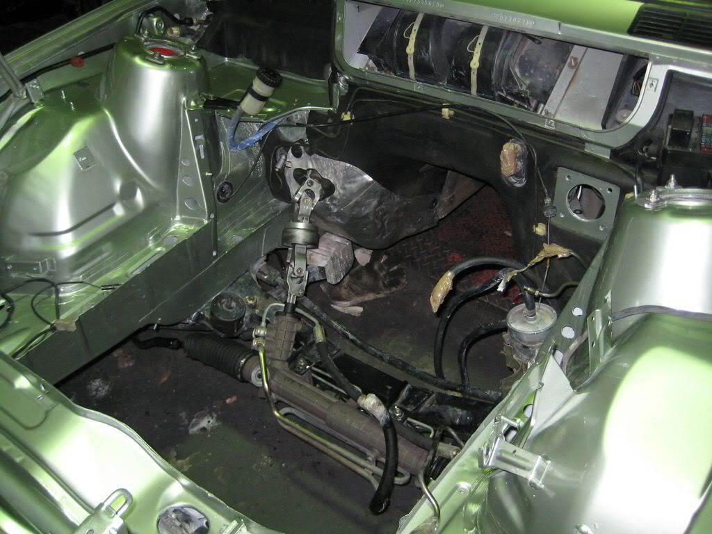

Going to be a great car! The new paint in the engine bay looks lovely :cool:

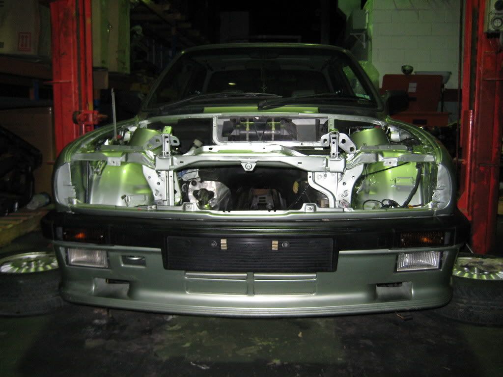

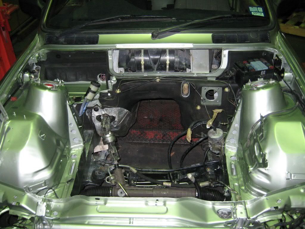

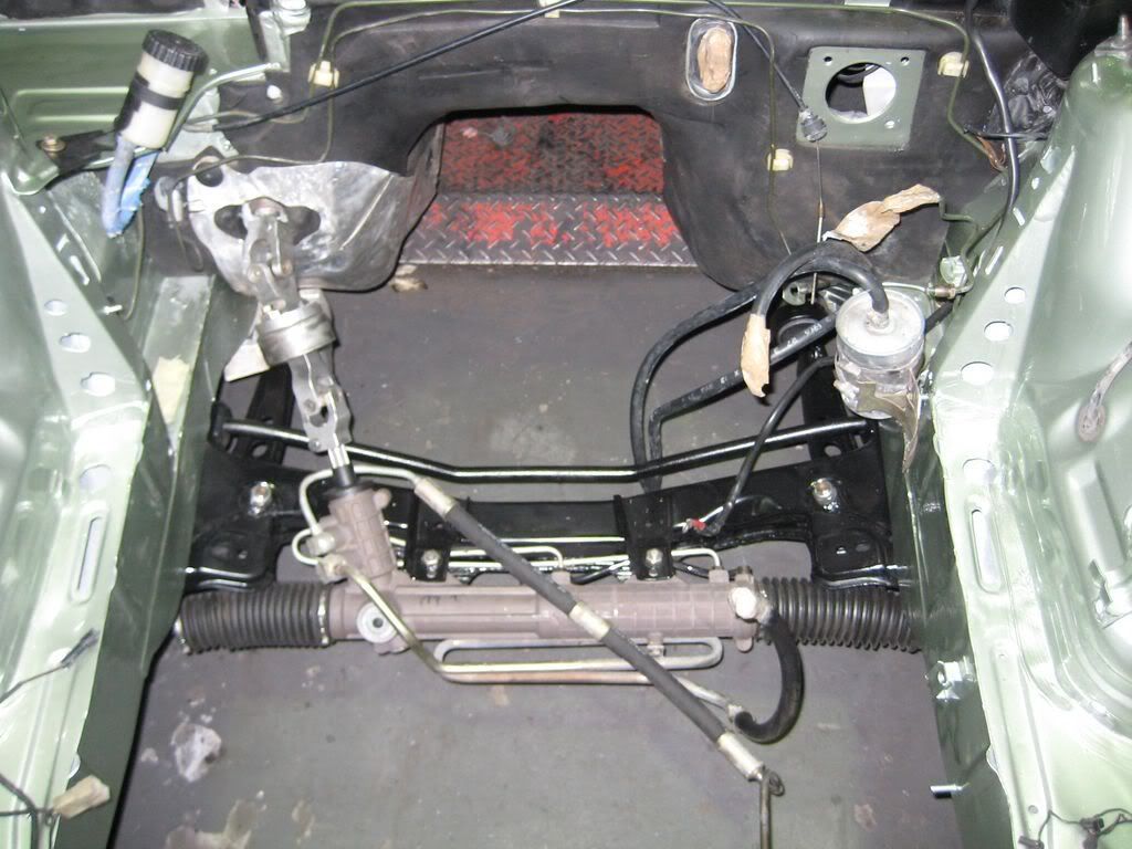

here is today update:
fitted the m3 rack and link
fitted the front bar
the car is slowly getting back togather. i am happy :D

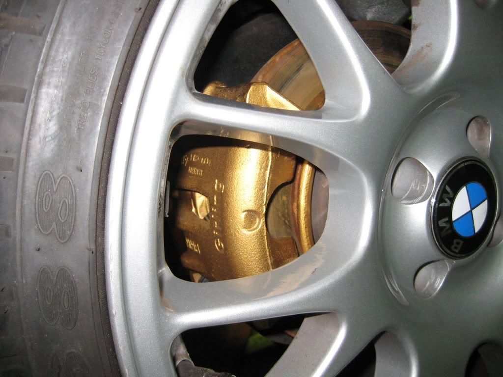

spikuzi
Posts: 122
Joined: Mon May 14, 2007 11:00 pm
Post Wed Dec 19, 2007 12:13 pm

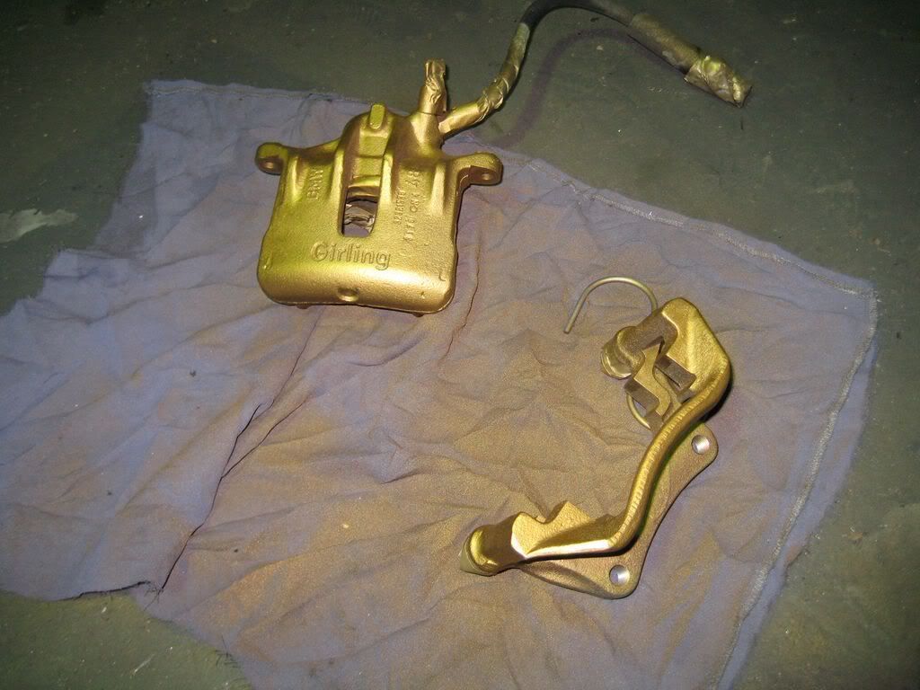

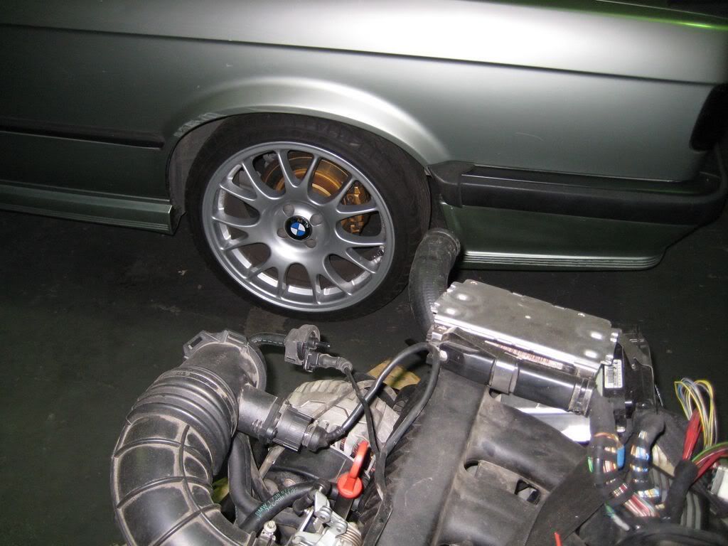

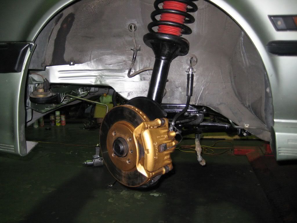

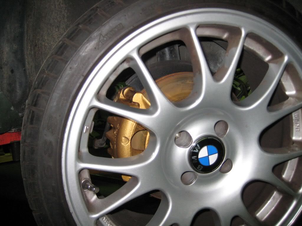

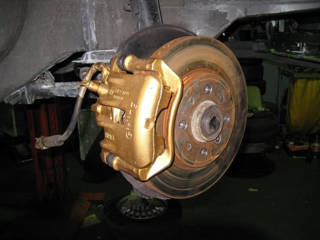

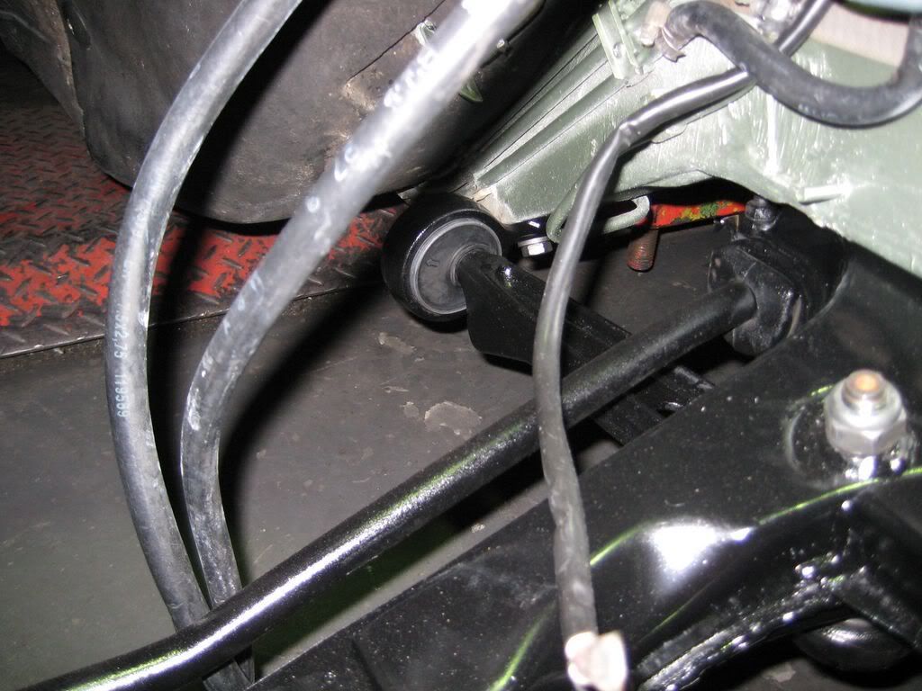

some updates for today:

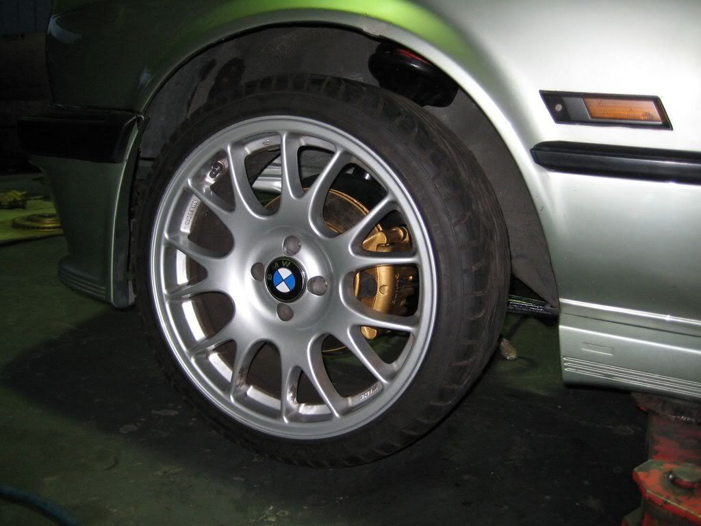

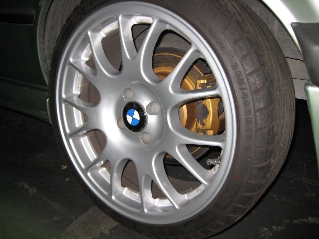

after 3 bad days i finsihed the front susspension, one of the cross memeber bolts snaped inside the chassis rail. took me 4 hours to get it out :x anyway i cleaned and painted, fitted the control arm bushes, rebuild and painted the calipers, changed sway bar bushes and links.
here is a few pics, hope u guys like the gold 8)

I need a workshop and infinite time/patience. Then I can ask you how you do it :)
Jay07
Posts: 1013
Location: South London
Post Wed Dec 19, 2007 1:15 pm
Top work mate! Keep the updates coming!! Lovely green and the golds a cool compliment. :D
mikekean
Posts: 369
Joined: Fri Jun 29, 2007 11:00 pm
Post Wed Dec 19, 2007 6:41 pm
what alloys are they on your car, i really like them wouldnt mind a set.
spikuzi
Posts: 122
Post Wed Dec 19, 2007 11:02 pm
mikekean wrote:what alloys are they on your car, i really like them wouldnt mind a set.
they are bbs ch replicas made in australia

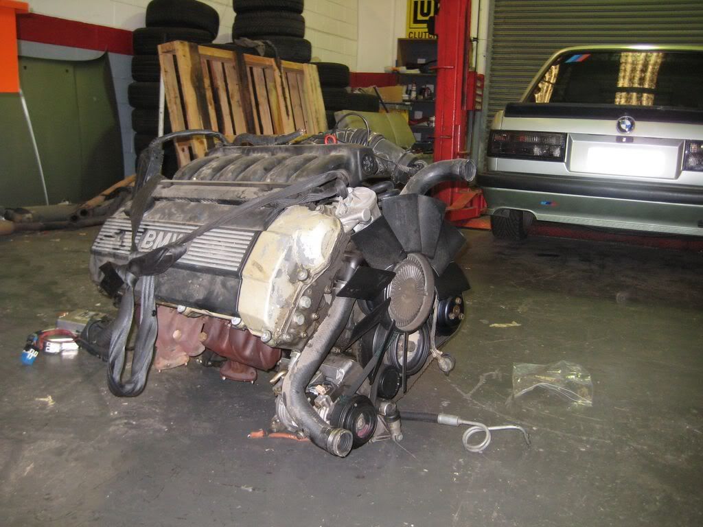

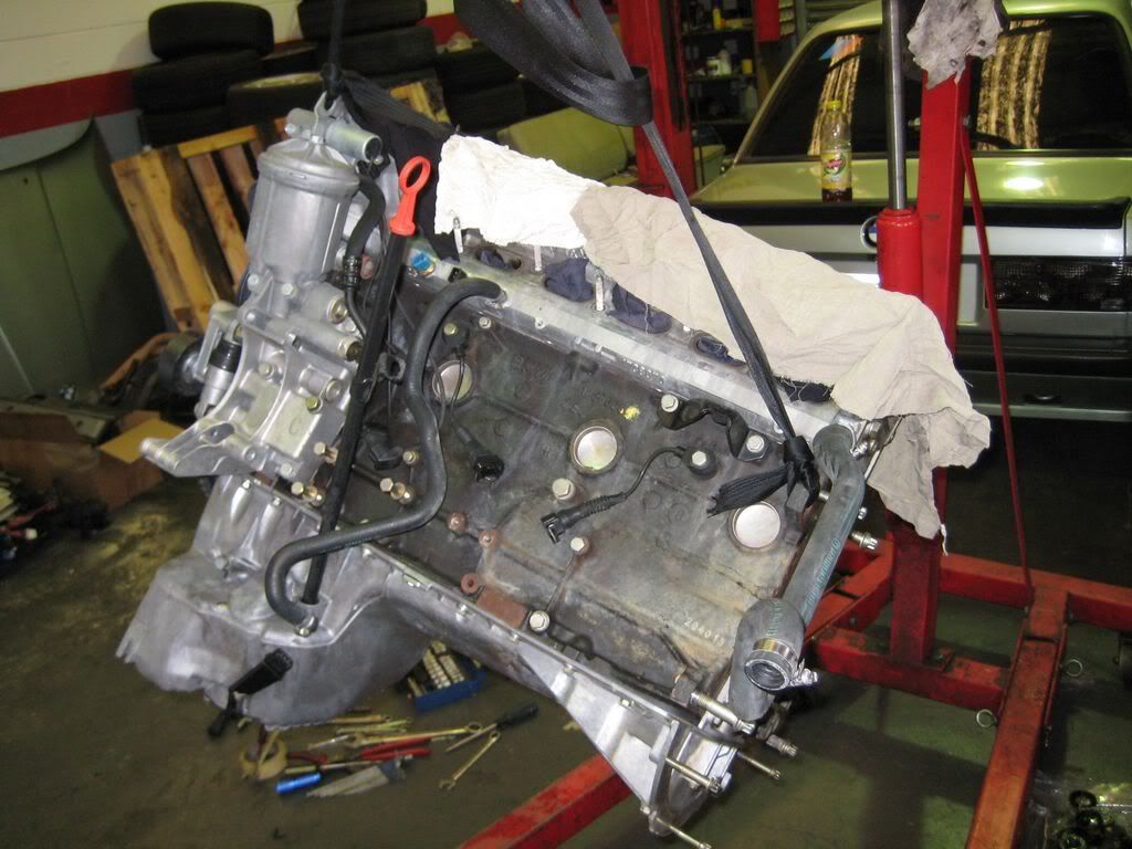

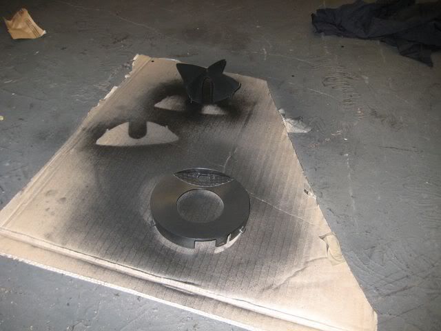

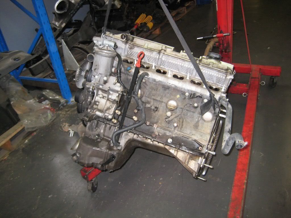

more things happening, just a quick question, any one used m52 valve cover on m50 :?: :?: :?: i have a spare one and i m thinking to use it insted of having all the trobble of painting the m50. i just cant be bothered doing it, too tiered :( and its christmas holiday winkeye
Posts: 28649
Post Sun Dec 23, 2007 12:49 pm
It will physically fit but you will have to f*ck about to get the plug coil wiring through and possibly the breather hoses.
Easiest way is to drop your M50 cover at your local powder coaters and have it blasted, dipped and coated :cool:

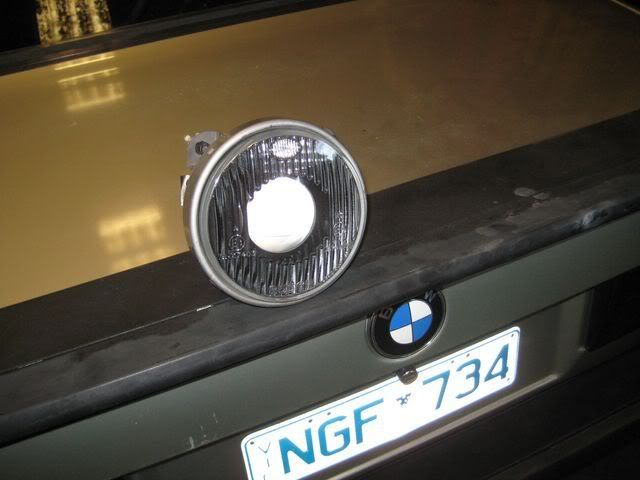

spikuzi
Posts: 122
Post Thu Dec 27, 2007 12:38 pm

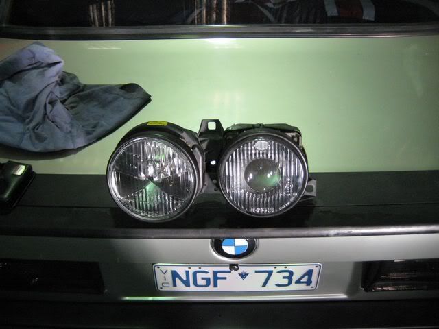

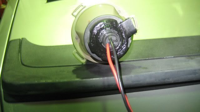

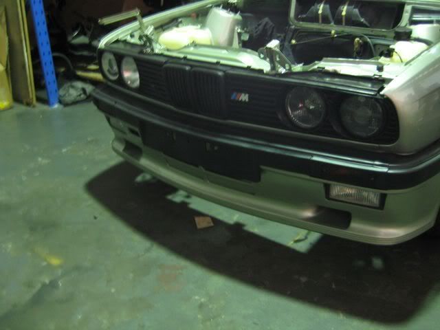

finaly i manged today to smoke one headlight. its bosch non smily i had it for spare. now i just have to find another one the same for the other side :D

Has any 1 smoked smileys? or for authenticity does it only make sense with none smileys?

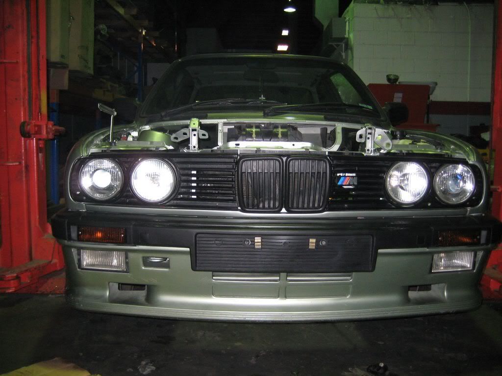

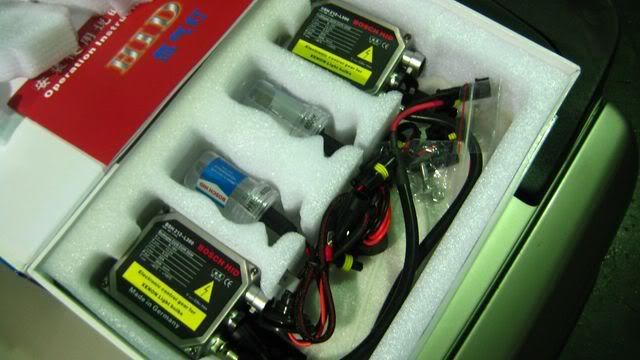

spikuzi
Posts: 122
Post Mon Jan 07, 2008 11:38 am

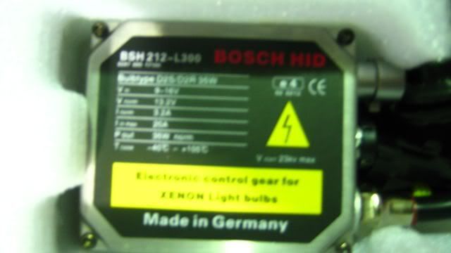

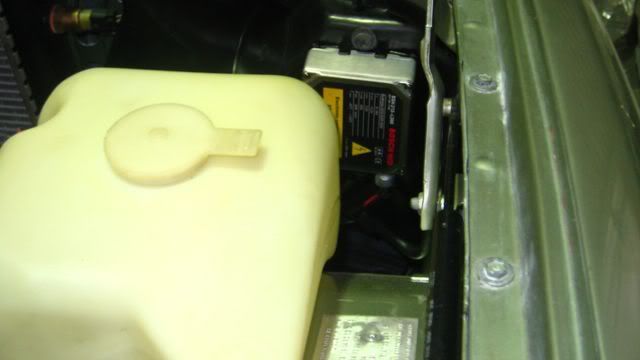

i got my hid kit today, very happy :D . but i cant try them till the engine is back in the car and running :(

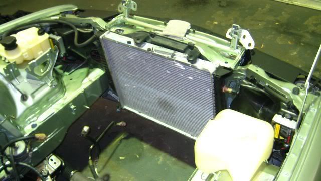

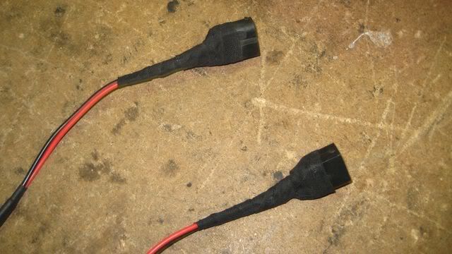

spikuzi
Posts: 122

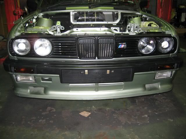

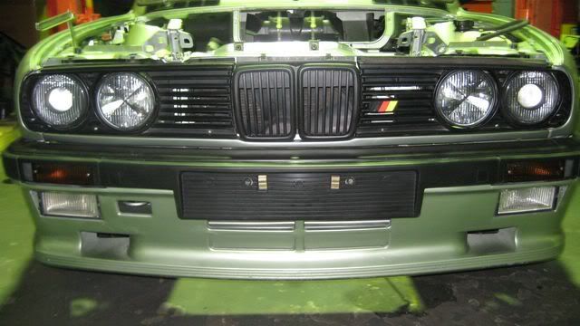

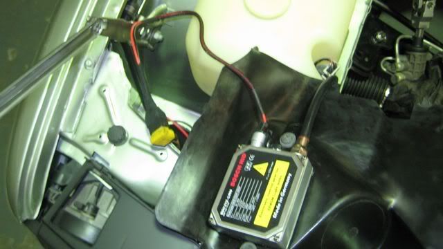

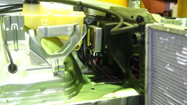

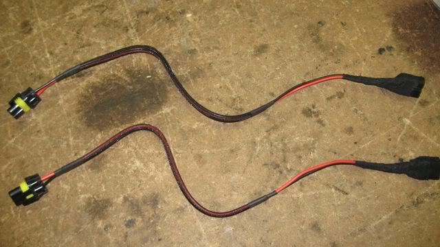

Post Wed Jan 09, 2008 8:52 am
a few more of the hid setup and test fit the e36 radiator
