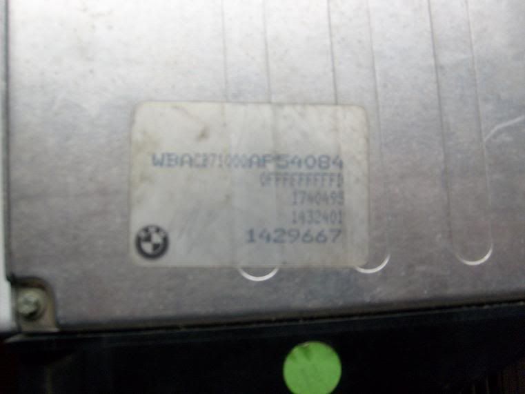

The only other coded bit you require is the key. Apart from that, you will need the small transmit/receive module, and the loop antenna that goes around the ignition barrel.Gabi_323i wrote:i have a 323i engine WBACB71000AP54084 and i have only the ecu and ews module, what do i need besides the key?
First page of this thread..Gabi_323i wrote:thanks a lot! anyone have pics of the missing bits?where is the trasmit/receive module and loop antena located?
