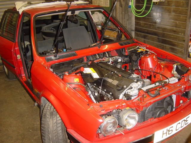

After a long while, I am pleased to report a little progress.
The Air Con setup is installed (in the engine bay) with just the hoses to the compressor to get made. I have managed to hunt down a local specialist that will make the pipes, get it all connected to the E30 side and gas it up and test it. Obviously this will be one of the last jobs to do and one that is best left to a specialist!.
Ian has given me a wiring diagram for the integration of the ECU into the Air Con so that that it drops out on full throttle. I am trying to follow it and get that done as the next job. I've also nearly finished the 'other' wiring. The good bit is that the ECU is where it should be and the wiring covers all fit. I have also fitted a new oil cooler and made new hoses.

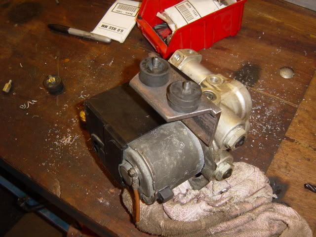

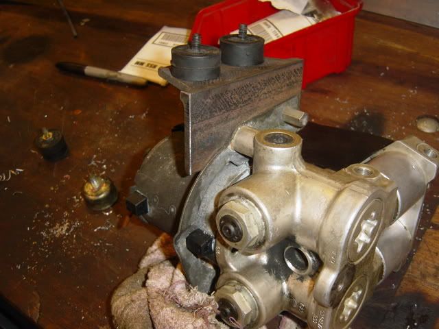

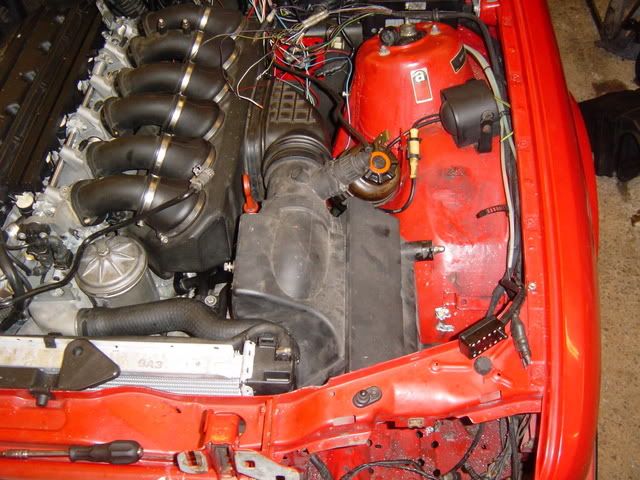

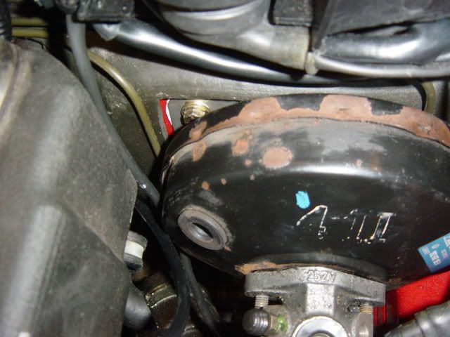

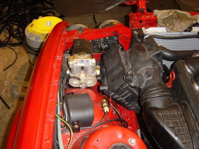

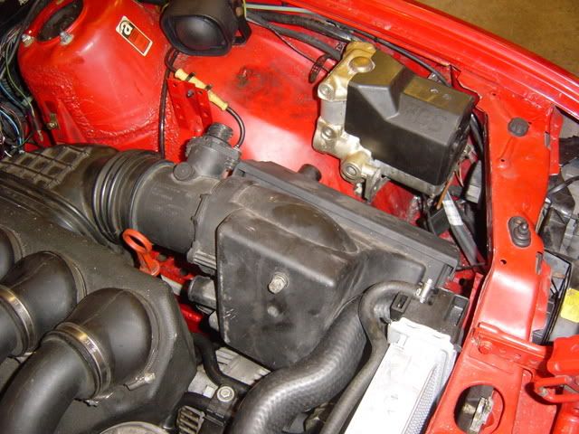

After lots of measuring and moving I've now got the E36 arbox in place and moved the ABS servo.
Some pics,

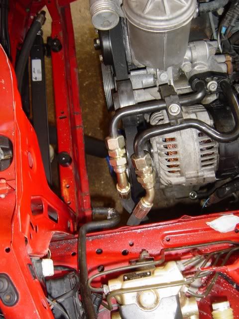

New oil cooler connections:

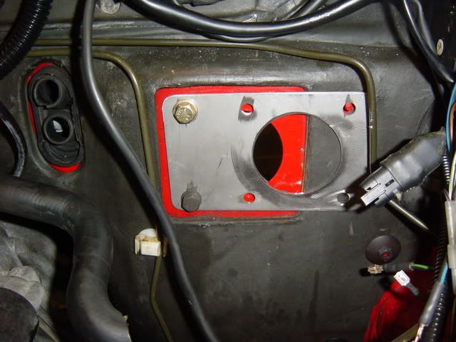

Various pics of Air box and ABS servo:

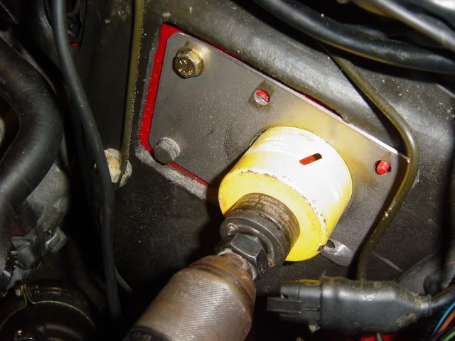

I made a rough mounting from some 50x50x 5mm angle iron and used some BMW rubber mountings I got from an E36 air box mount to fabricate a new side mounting for the ABS servo. Once I'm happy with the whole fit then I'll remake them in Stainless or Ali. I also need to mount the airbox to the inner wing on rubber mounts.
Fitting the airbox means there are no problems with the MAF etc. plus it should be easy to duct the E36 airbox into the underside of the inner wing for a clean supply of cool fresh air.

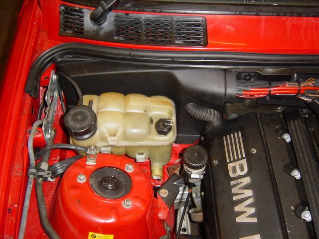

Coolant header moved over into battery tray area. This will be piped behind the engine in Stainless pipe and connected to the original system. The E36 M3 mount for the coolant tank can be used with a little modification.

good work mate.Good idea shifting the abs pump up over 8)
beardymat
Posts: 1979
Post Sun Jun 03, 2007 5:43 pm
nice solution to the whole airbox/abs problem.well excecuted as always with the minimum of fuss

Cheers guys,
There isn't enough room to get the ABS pump anywhere behind the headlight and under the airbox. I even took off the intensive wash motor from the headlamp to try and get a bit of extra space!
Rather than have to go to the trouble of putting it under the car I figured this would do nicely. There will still be a good head of brake fluid available at the pump as the reservoir will still be higher. It also saves a lot of pipework getting it all over to the battery tray - not to mention the wiring involved :mad:
Pipng the coolant header will be a bit of a ballache but I've found a length of 19mm ali tube to cross behind the block and pipe it up that way. I think it's similar to the way HenryM3 has done his.

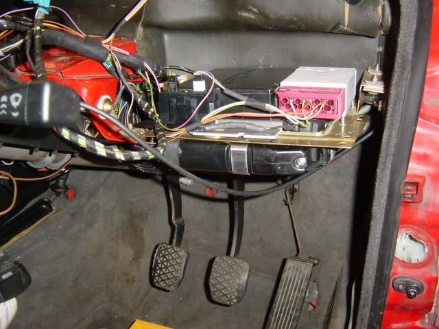

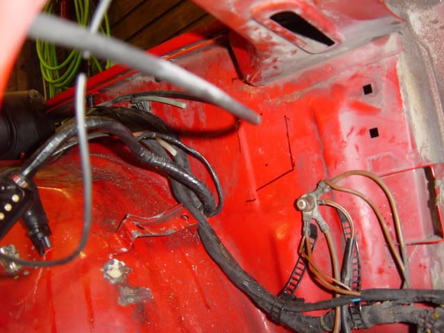

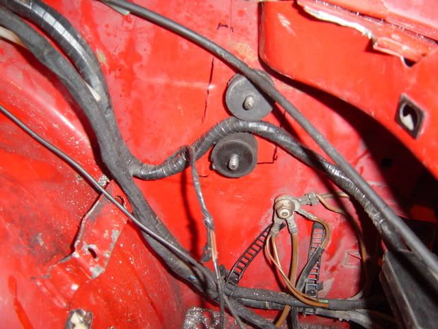

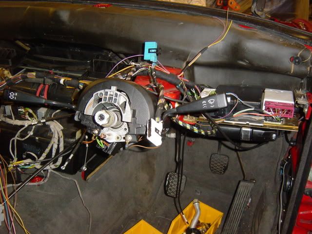

I was fed up with getting in and out of the car and the hassle with taking the dash out and struggling on my own so I took the doors off and the windscreen out. Normally to do the S50 conversion the dash could stay in, but because I was adding A/C then I needed it out of the way to fit the new heater box and evaporator.
Taking the windscreen out and the doors off took around 30 mins and makes life so much easier.
Pic of the inside with the new Heater box installed:
The wires loose by the gearstick are new wires for the VDO gauges should I decide to fit them in the future.

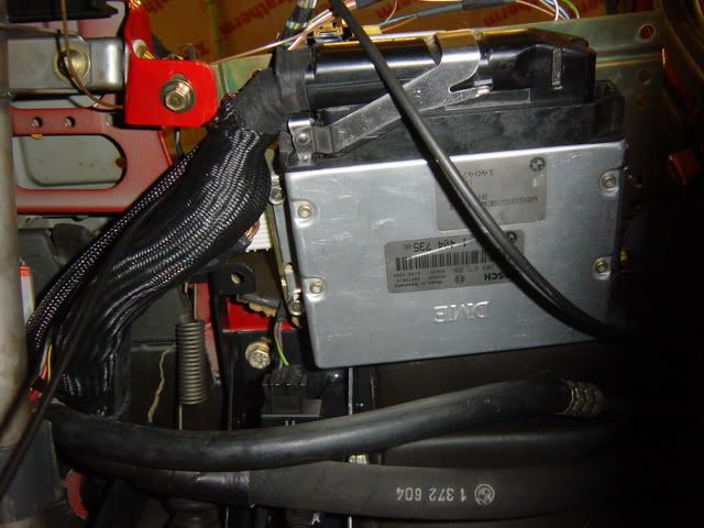

Close up of the ECU mounting, in the OE location: (note A/C hoses in bottom of pic)
EWS system, transponder and Vanos controller mounted and wired up:
Closer:

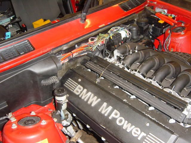

Finished engine wiring:

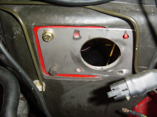

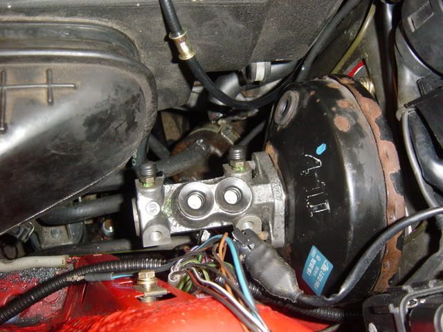

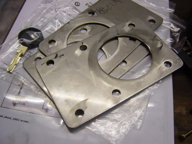

Next job was to sort the brakes out. I have revised my method since the last conversion and used stainless steel platework this time. It doesn't have the OE look of yellow passivated but it is quick. I changed the dimensions of the relocation too. This one has been fabbed up slightly different to solve a few minor issues with my previous design.
Stainless plates - (two of these are spare just in case I do another conversion):
Fitted into place over original mounts:
A little drilling:
A clean up and paint in the bare edges:
Servo and M/C fitted:
Again:
The servo was trial fitted but will be blastcleaned and coated before final fitting. Tomorrw I am going to refit the pivot housing inside the car. Make the new brake pull rod and crack on with some more.

old_skool_2002 wrote:Stainless plates - (two of these are spare just in case I do another conversion):
8O 8O :D
8O 8O :D
Well,
You never know...
I may get bored and want to do another one! winkeye
