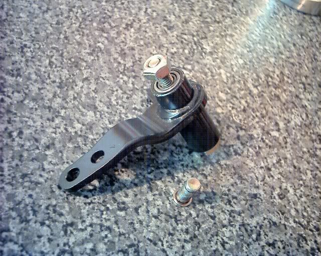

For the lever see pic below ,
Just matched the thicknes of the lever and made an extension for it, put weld preps on both sides ( 45 degree chamfer to a point) and welded it on,then re-drilled the end.

Glenn/Buster, what did you do with the two left-hand servo mount studs? is the servo moved so far over that they no longer go through the black mount bracket inside the car?
This is the extent of clearance issues between 'stat housing, FPR and TB number 1. I'm going to cut the offending stub back further so as to lose the third tapping in the top, then hopefully get a stub welded in at a better angle. Aluminium looks fairly decent underneath the grime. Have sourced an adapter from an old FSE power boost valve kit that should sort the FPR issue.
Meanwhile on a more productive note I've shortened the throttle spindle and made brackets to hold my TPS as close to TB 1 as possible. that's one less thing to worry about then :D

throttle bracket done today, one small step closer :D
