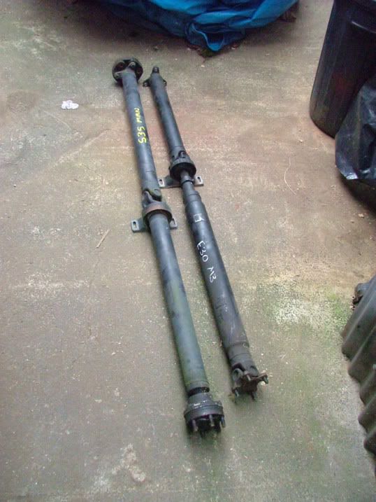

will the m30 front of the prop bolt onto the rear of a m20 325i prop?

The M30 fron part of prop (shortened to the correct length for engine position) slides onto the rear half of the M20 prop with no modification.

There must be 2 different types of props - that is also what the jarad squires site said - but aint no way in hell the M30 front half was going to slide into my E30 rear. I had to cut the uni joint out of both halves and then reconnect them with a new uni joint.The M30 fron part of prop (shortened to the correct length for engine position) slides onto the rear half of the M20 prop with no modification.
gareth
- Posts: 11005
the E34 M30 prop i had for a while definately does not mate to a E30 M20 one. in the pic, both props are lined up at the gearbox flange for comparison. the E30 prop has a splined coupling, the E34 one has a bolt up flange.
