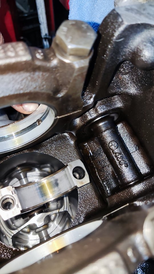

Small update on my issue:
clutch dump etc contribute to the issue with broken PP, but it seems for a first attempt to build a stroker motor from me created the issue which is something has to do with vibration /improper engine build.
while investigating the issue and turning the engine by hand, the crankshaft bolt came lose therefore it was not just a replacement of a clutch.
the broken straps of the pressure plate that happened twice, it seems to be caused by improper attempt to secure the washer of the crankshaft bolt. i wasn't aware that the step of the washer had to be reduced significantly so as to be 100% sure that it does not touch the edge of the crankshaft witch it seems it is longer that the m20b25 one. we removed 1mm of the step (from the 3.4mm) but it seems that it needed more cz it had some markings.
also the crankshaft bolt wasn't torqued to spec and it was torqued with an impact wrench.
actually i don't know what caused the vibration damper not to be secured but i speculate one of the 2 posibilities or an imbalanced crankshaft(even if i have sent it for check to ''specialist''.
Due to the above, the harmonic balancer had a play cz it destroyed the woodruff key, however the bolts of the pulley were in place. also the timing belt wasn't in good shape.
at least we found the issue by luck before the engine would lost its timing etc.
We removed the crankshaft from the engine and the rod bearing s were not in good shape. ( i m attaching some photos, cant put all photos in order so i m giving you some to see the issue)
not sure if this is caused by a vibrating crankshaft. but i will have to gamble that that's the cause. the rods were measured with plastigauge before installation of arps and oem standard bearings at 0.038mm to all rods or near that figure.
i was using motul 300v 10w-40 and was replaced every 4-5k km after break in period of 1500 km (changed oil i think twice dont know what oil was used), engine had 7k kms. , max rpm 7300.
steps to resolve the issue.
1) take the crankshaft , different harmonic balancer in better shape, oem flywheel(to be resurfaced, i was using RHD FW that was destroyed when PP broke), new sachs 618 PP with clutch to be individually balanced and balanced as assembly.
also it came to my attention that the throw out bearing that was used with the 618 sachs PP was 25mm long, while many suggest that the specific PP needs the E21 throw out bearing which is 30mm long. Don't quote me on that. so i will be using a 30mm throw out bearing.
i bought new standard acl rod bearings and standard kings racing main bearings, bought new crankshaft bolt for 24v egines. , (i will also take with me another m52b28 crankshaft in case that one was bend)
take the crankshaft bolt washer to the lathe so as to remove material from the washer so that the washer has a step of 0.9mm.
reassemble and hope that with plastigauge that the clearances will be within spec.
do you think that there is anything i should do before ? i don't know how to check if the bearing of the intermediary shaft is in good shape. is there is any way to check?
also i will replace the gearbox with another g260 as the one installed was not in good shape, 2nd gear wasn't engaging easily.
thanks
