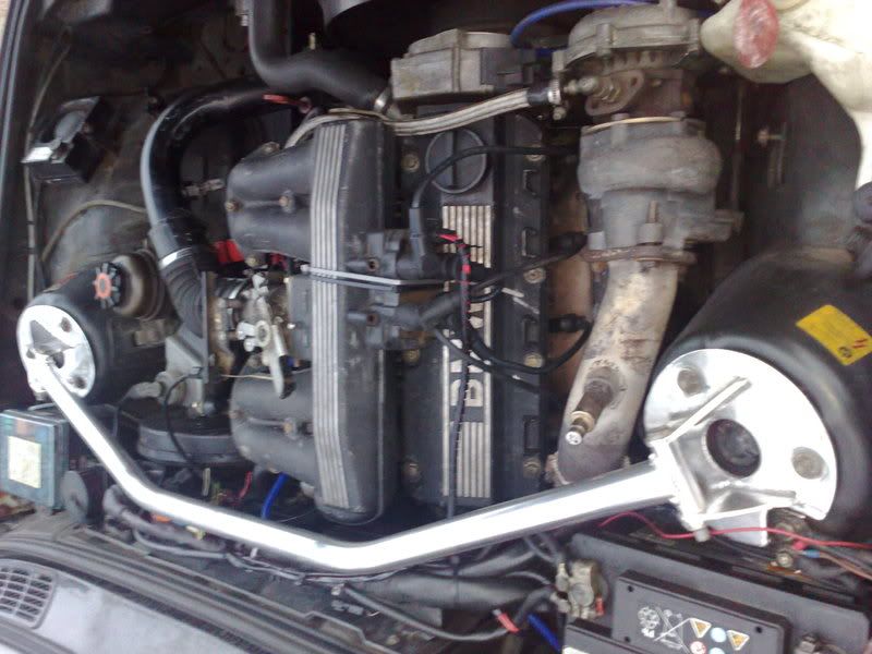

I'm going wastespark, boost control parts are ordered just looking for for some non-stretch bolts now before 10+psi :woohoo:
Let me know what pics you guys want and i'll try and take some this weekend.

Chu you can run 10 psi on bog stock engine fella i did !!!!!
i ran 0.8 bar on mine without any problems
What coil pack you going to use ????
a citroen one is good as you will struggle for places to put the coil pack unless you have reloacted the battery to the boot
Hope that helps bit messy the photo's but they were taken when car was in process of being finalised
EX A-Tech Workshop bitch !!!
gone but not forgotten
Ant

I made a bracket for the coilpack on chris P's M40T, sits where the stock dizzy cap normally resides
Nice,

Ant wrote:I made a bracket for the coilpack on chris P's M40T, sits where the stock dizzy cap normally resides
Nice,
That was always the intension. I've had to put the standard coil where the battery tray is for now, so the battery is in the boot. I wanna put the battery under the bonnet again and put the washer bottle in the boot.
I've got a cavalier redtop coilpack which was donated by a friend :D
I want the non stretch bolts because i'd like to run more than 10psi really, even if I don't i'd like the extra security.
Chu just geta 325 washer bottle and cut the small intes was bit off job done and put it in the original place
as Ant did for me
is perfectly ok and even on a cold day you have pre heated washer fluid

It won't fit, my turbo is further forward than yours.

fair enough mate would keep battery in the boot then and move the washer bottle to the battery tray

A 324d washer bottle fits in the battery tray area I think :wink:

I would like to see a pic of the exhaust manifold and how i has been made, im seriously considering this.
fowler
Boost Junkie
Posts: 3468
Wed May 27, 2009 5:36 pm
all three m40 turbo's have different style of manifolds as two were top mounted and one bottom mounted
they wereall one offs .
so either speak to Chu for his drawing or photo's as the other wre made by A-Tech

Boost control now added, but turning up the boost means the spark is now being blown out when I get to 8psi. So I have purchased some new sparkplugs that are a grade colder and gapped them to 0.55mm from 0.65mm. The original plugs were 0.75mm. After fitting the new plugs my whole map went lean, does this mean i'm burning more fuel and the engine is running better or does it mean that all the fuel isn't being burnt so easily and more fuel is needed and some is being unburnt?
I'm going to try to get it running wasted spark later, will I be able to open up the plug gaps? If so by how much?
