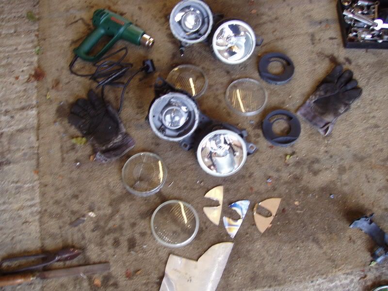

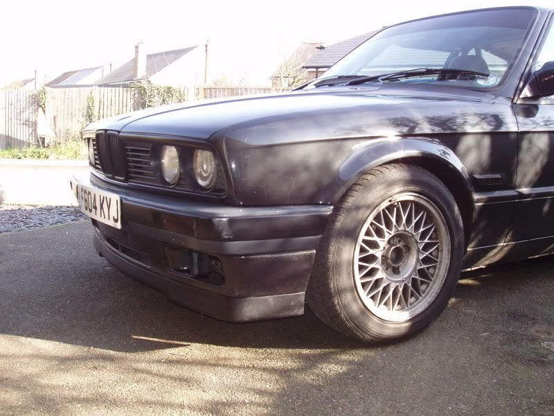

318is front lip recieved and fitted -

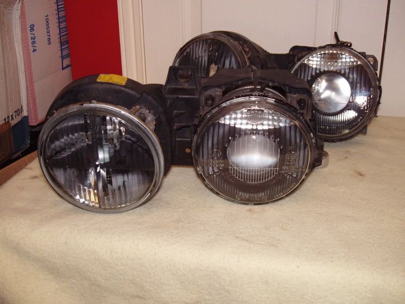

And I 'blacked' a set of headlamps which I'll fit later - ran out of time today and want the sealer to harden properly too. -
Still a few things lined up to do but not enough time! :(

Lights look good, not too dark like i've seen before.
Are you still preping for PPC ?

Andy335Touring wrote:Lights look good, not too dark like i've seen before.
Thanks Andy!
They look so different from different angles though, hard to see them in just one photo really. I'm quite pleased with them (and I didn't even break any lenses! :D ) as I've gone for the all black and sinister look! :twisted:

Nice lamps, DRIFTBOY! Do you have to leave the sidelight reflector section clear for the MOT?
Cheers,
DRIFTBOY
Posts: 3131
Sun Feb 04, 2007 10:00 pm
320iSE wrote:Nice lamps, DRIFTBOY! Do you have to leave the sidelight reflector section clear for the MOT?
Cheers,
Thanks!
It didn't take as long as I thought it would either, but then I do sometimes get impatient and rush things. So they might fall to bits next week! :chuckle:
I left the sidelight reflectors silver as I did fear MOT trouble, but the 'eye brow' spoilers cover half of those so I don't think it will show much. Some people do paint those bits as well, don't know how they get on at MOT time though.
Martin.
Posts: 14031
Sun Feb 04, 2007 10:06 pm
Cool. What glue did you use, also did you weld the X-thingys together or just glue them?
DRIFTBOY
Posts: 3131
Sun Feb 04, 2007 10:17 pm
320iSE wrote:Cool. What glue did you use, also did you weld the X-thingys together or just glue them?
I cut the cross bits out of thin(ish) aluminium (as time consuming as getting the lenses off) and stuck them in with Unibond super all purpose (black) silicone sealant - £7.14 from B&Q from a caulking gun - £2.98 from B&Q! I also used this to stick the lenses back on.
I painted the bits with Hycote VHT heat resistant paint from an aerosol can.
I hope the sealant I used is ok with the heat! 8O
I think I'll paint the metal headlamp rings black and fit those too, just in case a lens comes unstuck, the ring might stop it falling right out!
Posts: 14031
Sun Feb 04, 2007 10:20 pm
Nice one, cheers for the info :) (I hope to have a bash at this mod soon).
DRIFTBOY
Posts: 3131
Sun Feb 04, 2007 10:25 pm
320iSE wrote:Nice one, cheers for the info :) (I hope to have a bash at this mod soon).
No problem.
If you haven't got a heat gun (which I didn't) you can pick up one for under £20 which will do the job. My 1.6 kw one was good enough.
It is a time consuming job but once the lenses are off the worries are over.
Just be careful not to break them trying to get the lenses off before the glue is properly heated, it does take time.
Good luck,
Martin.
gareth
Posts: 11009
Sun Feb 04, 2007 10:28 pm
silicone sealant should hold together to well in excess of 200°C so you should be fine :D
