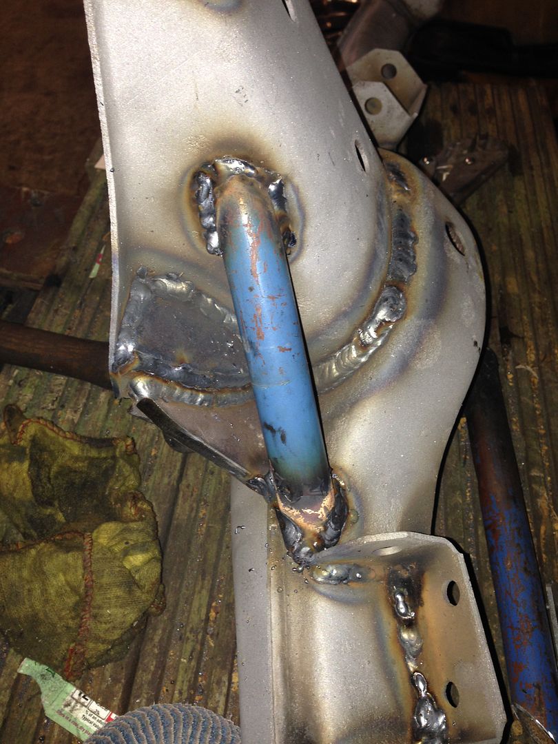

Post Fri Jan 24, 2014 4:57 pm

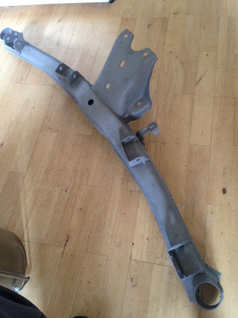

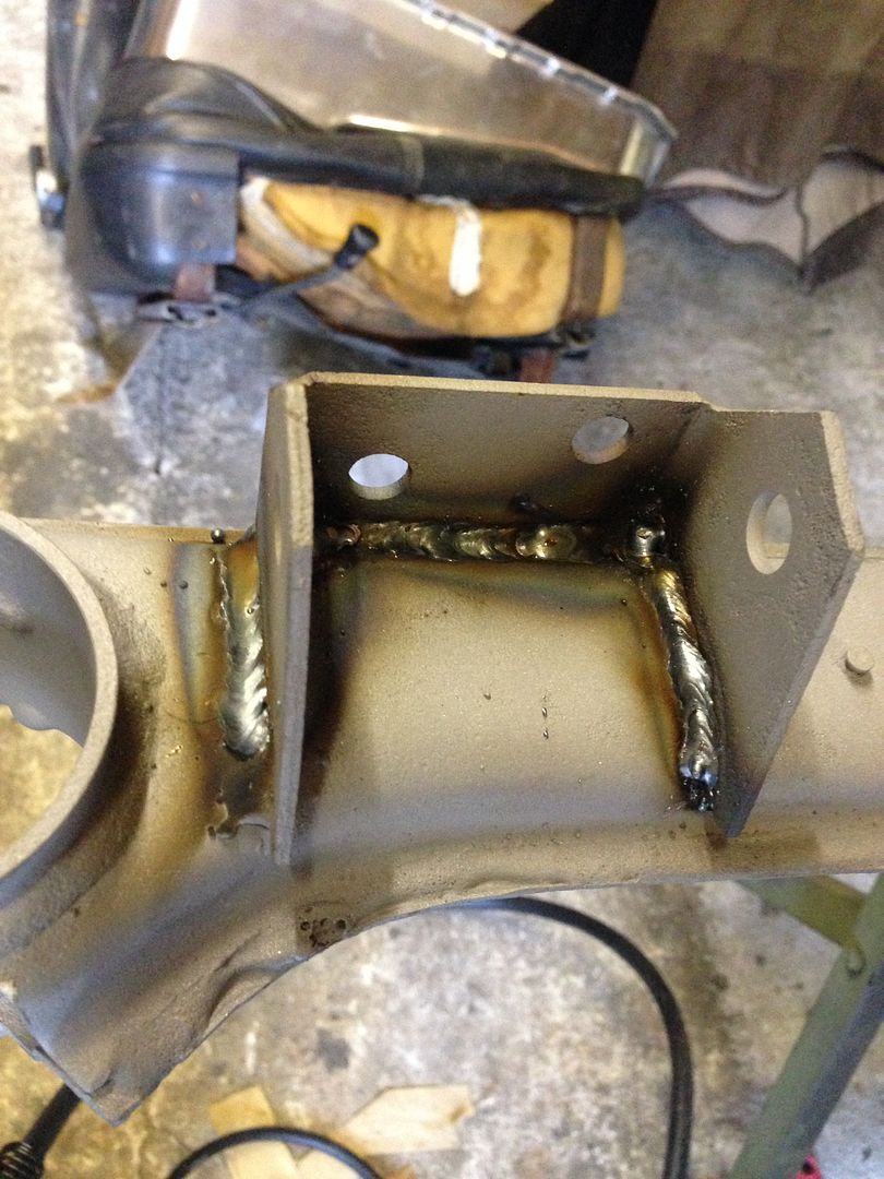

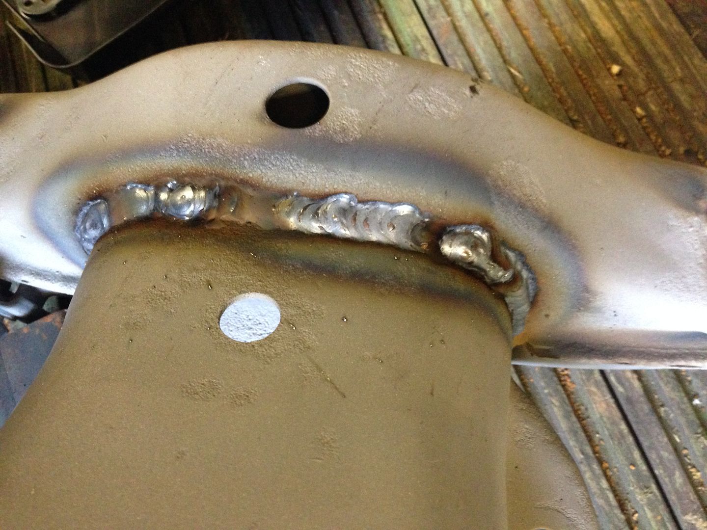

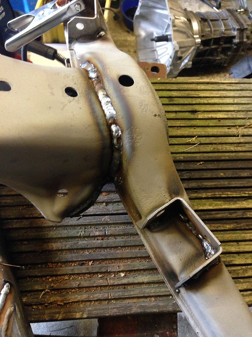

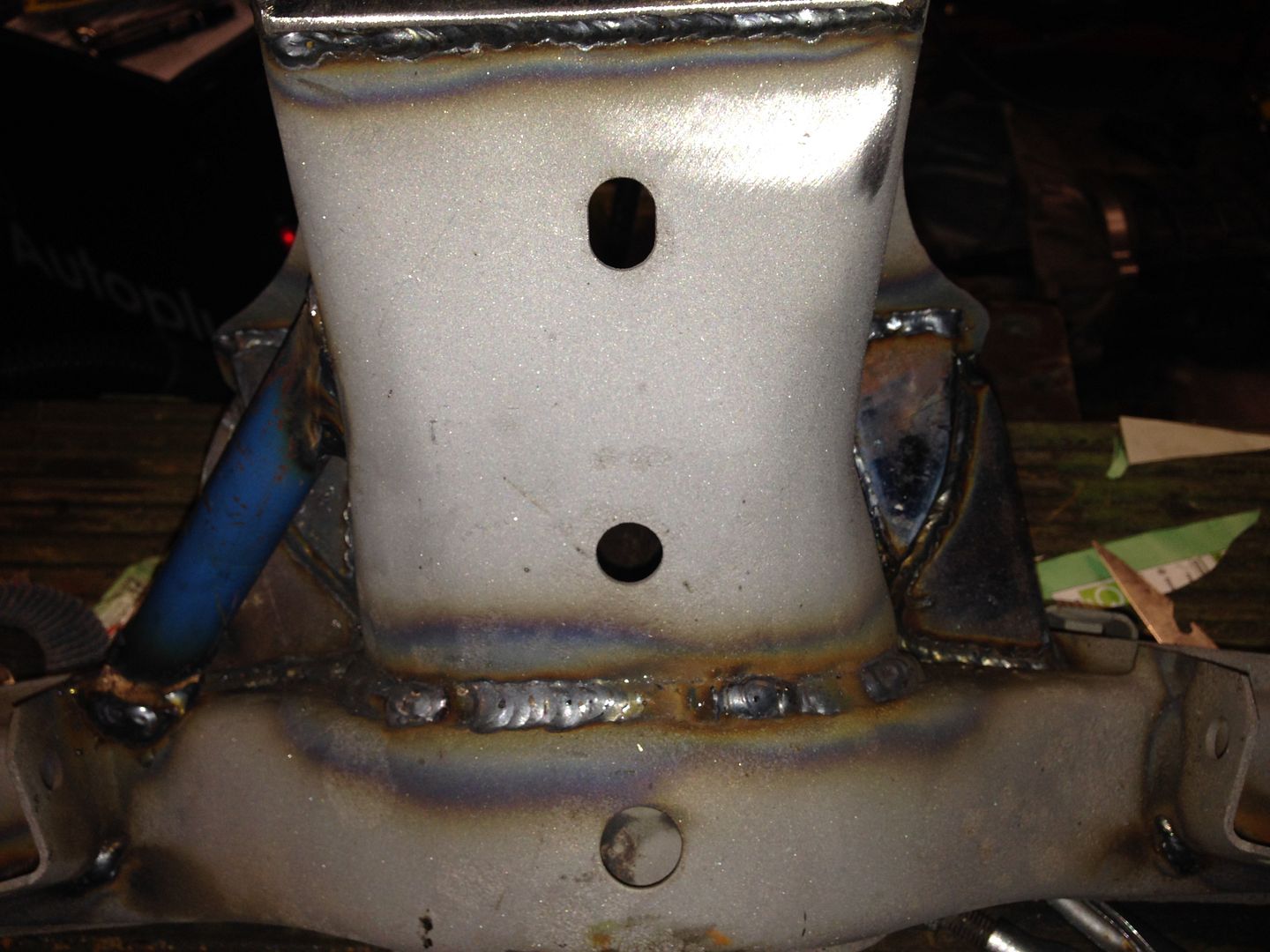

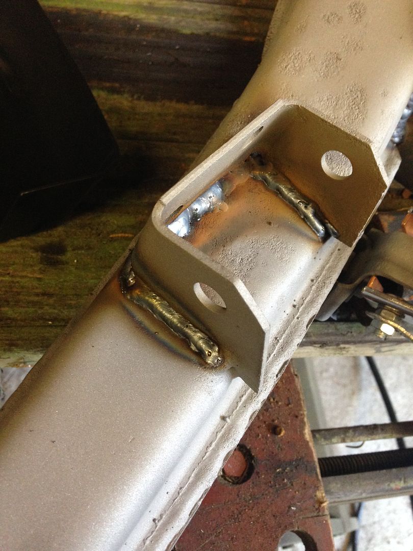

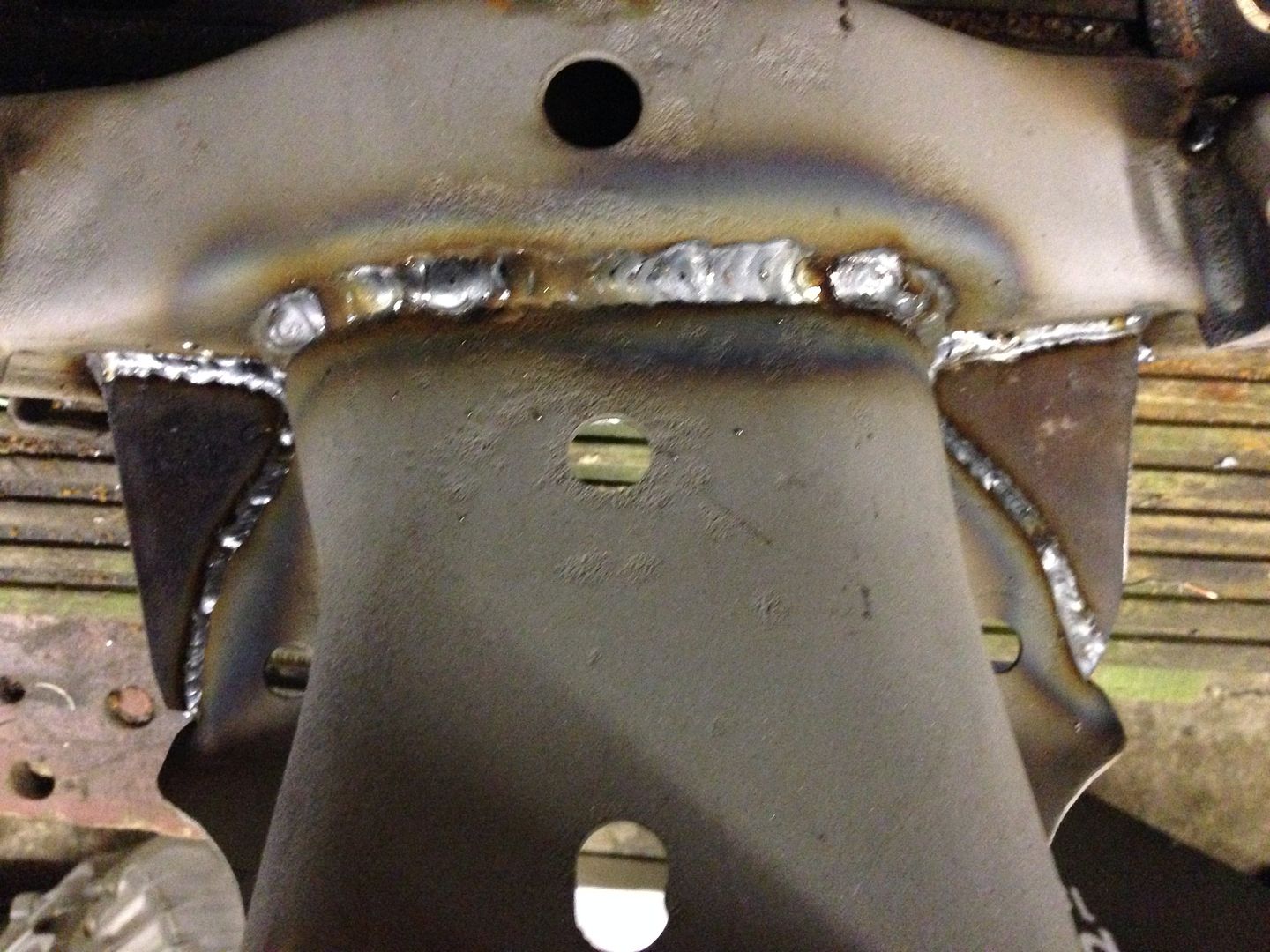

so I got the beam bk today all blasted and ready to weld up
I started by going over the old welds to make them a little stronger and I have gone around the trailing arm brackets again as some of them arnt fully welded
and started the reinforcing

Posts: 14127
Post Fri Jan 24, 2014 5:07 pm
Good idea, for coping with the torque of a mighty V8. Looking at the original ones, I'm surprised they were up to the job with your previous blown engine.

Post Fri Jan 24, 2014 5:32 pm
yeah that's what I am doing max but I'm putting plate gussets instead of tubes just because I ain't got no tube to do it lol

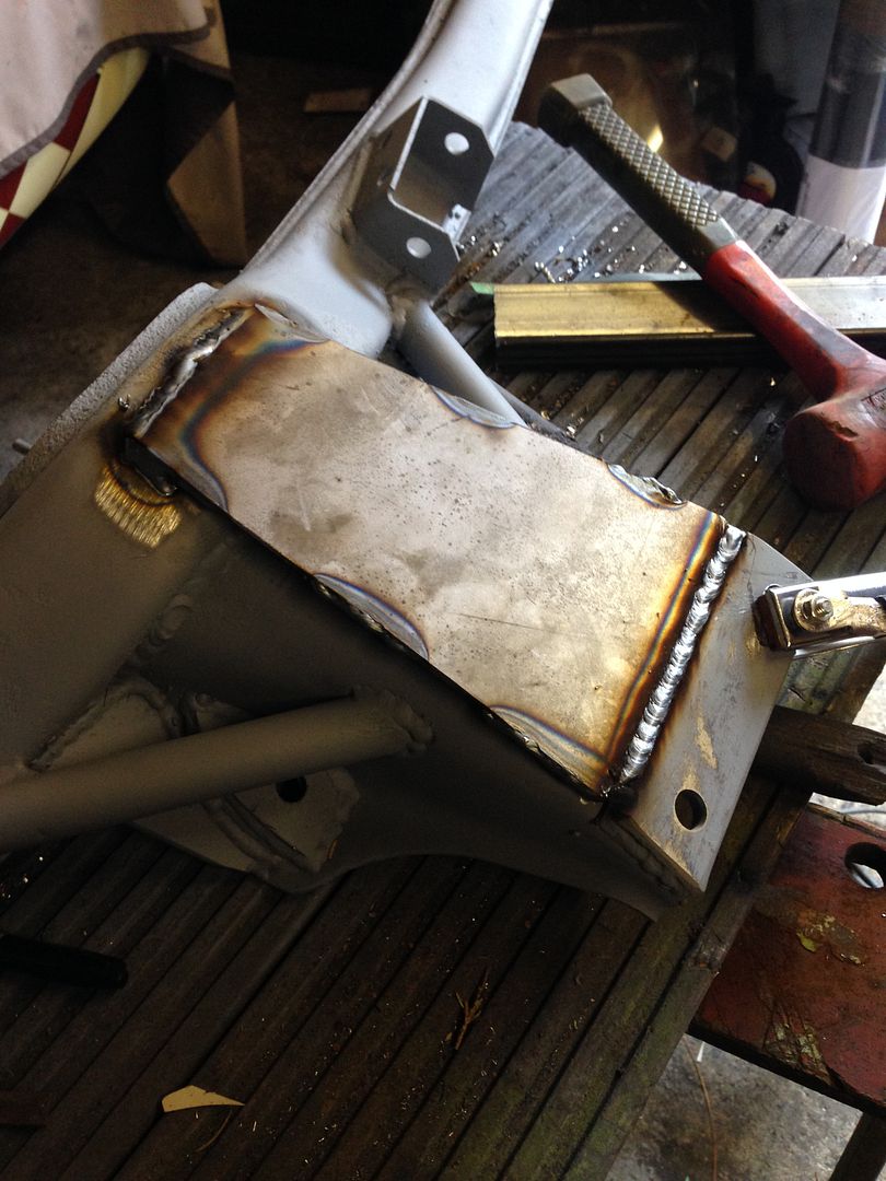

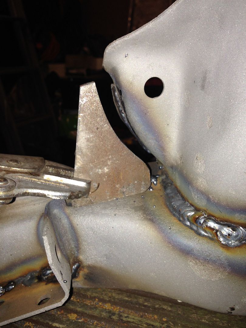

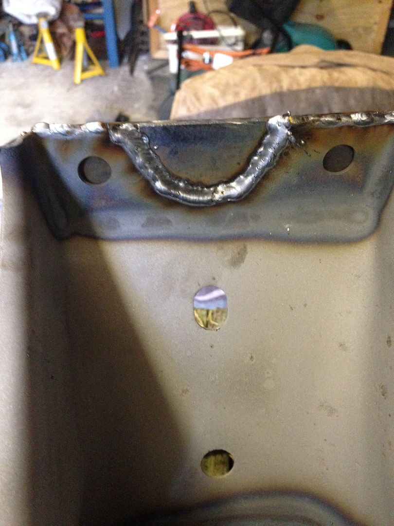

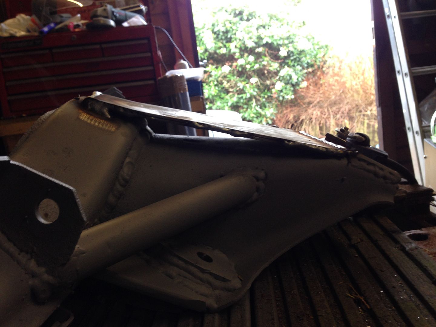

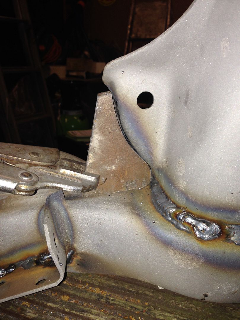

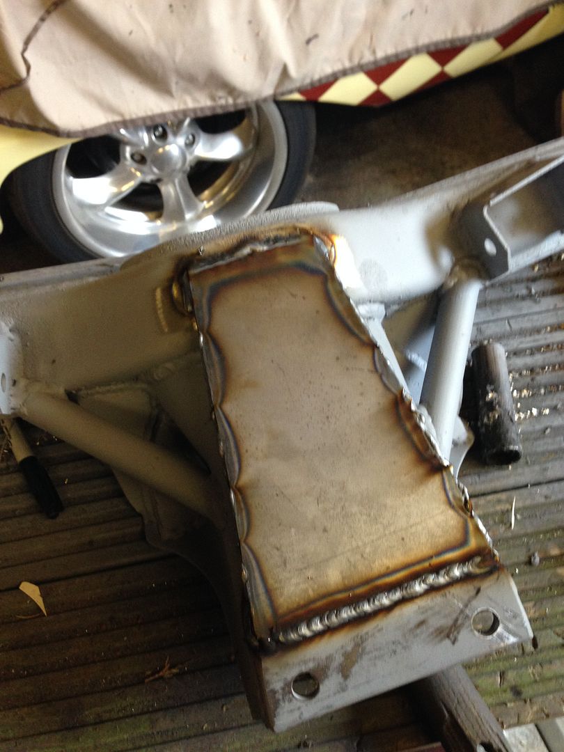

ross2009
Posts: 2762
Post Fri Jan 24, 2014 8:22 pm

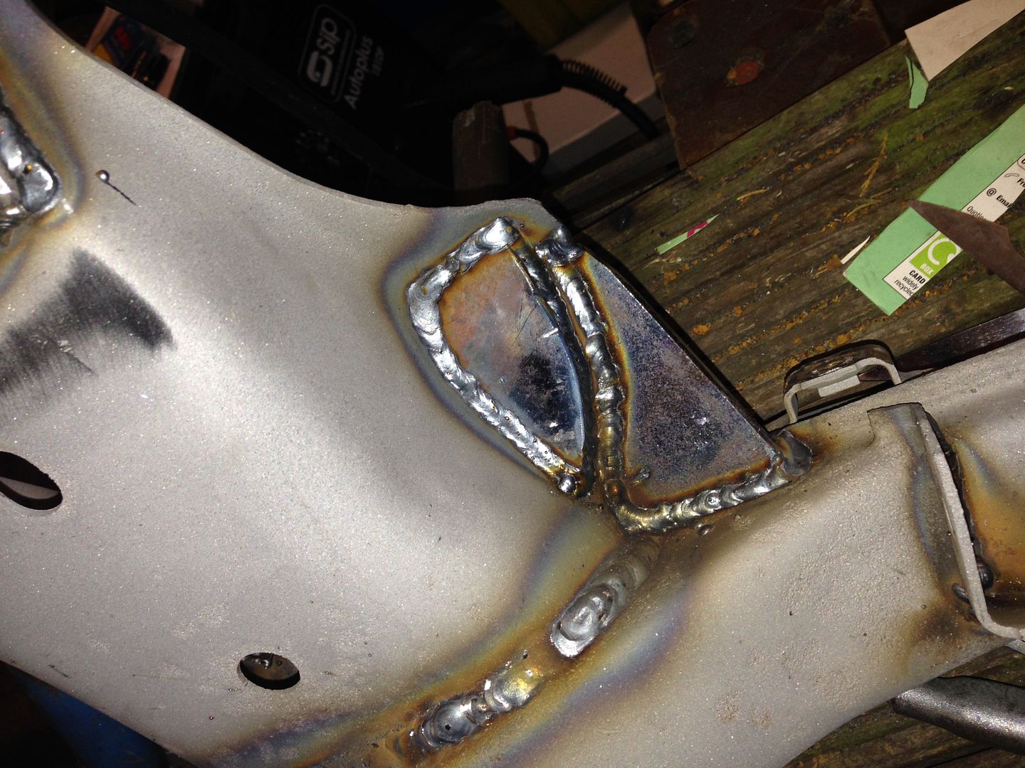

a little like this max
and what I've done tonight
Turbo M20
v8 project 6.0 twin turbo
Posts: 14127
Post Fri Jan 24, 2014 10:15 pm
Certainly looks alot stronger to me. 8)

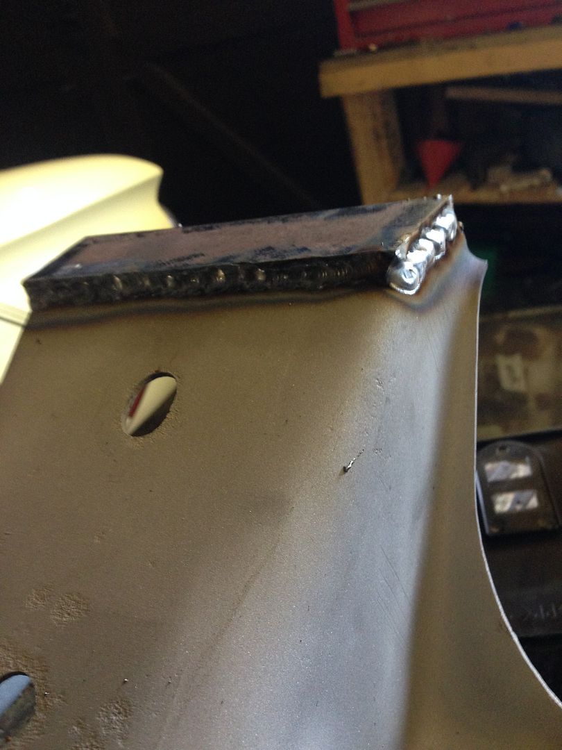

ross2009
Posts: 2762
Post Fri Jan 24, 2014 10:16 pm
not finished yet either still gonna put a plate on the top and then re drill the holes should be good to go :)

Location: Suffolk
Post Sat Jan 25, 2014 12:42 pm
skills with the welder!!! wish I could weld like that 8O
ross2009
Posts: 2762
Post Sat Jan 25, 2014 12:43 pm
lol I didn't think it was the prettiest lol but does the job

Post Sat Jan 25, 2014 12:48 pm
looks good to me! certainly good enough for the tarmac to look at winkeye

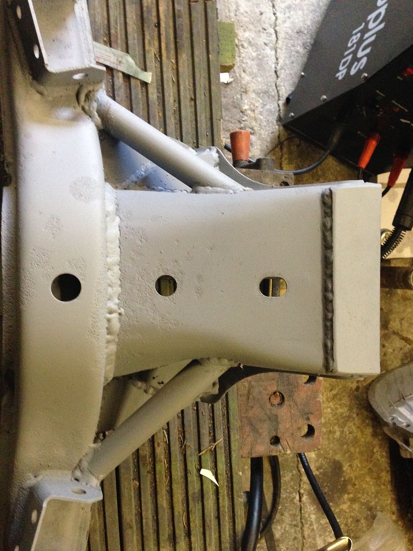

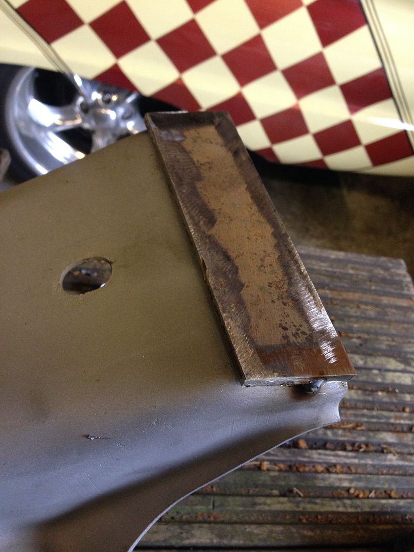

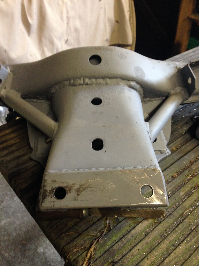

ross2009
Posts: 2762
Post Sat Jan 25, 2014 3:45 pm
just drilled the holes and stuck some primer on it

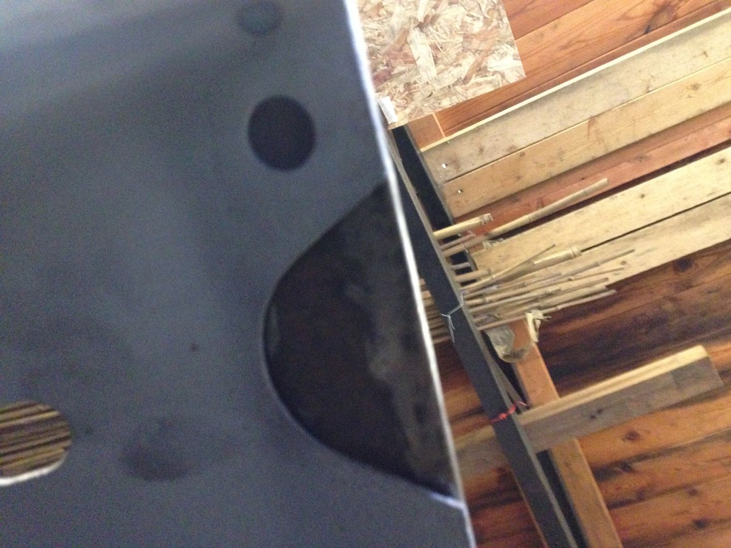

ross2009
Posts: 2762
Post Tue Jan 28, 2014 2:47 pm

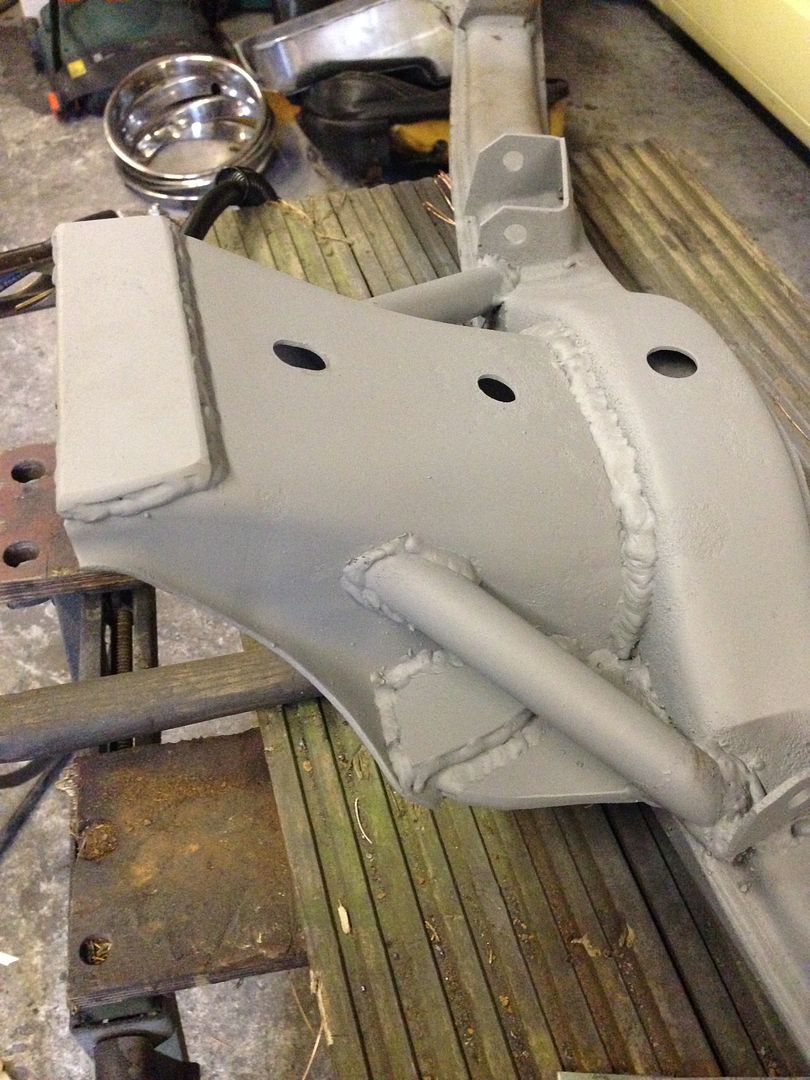

well got the top plate on and all in primer ready to paint now :)

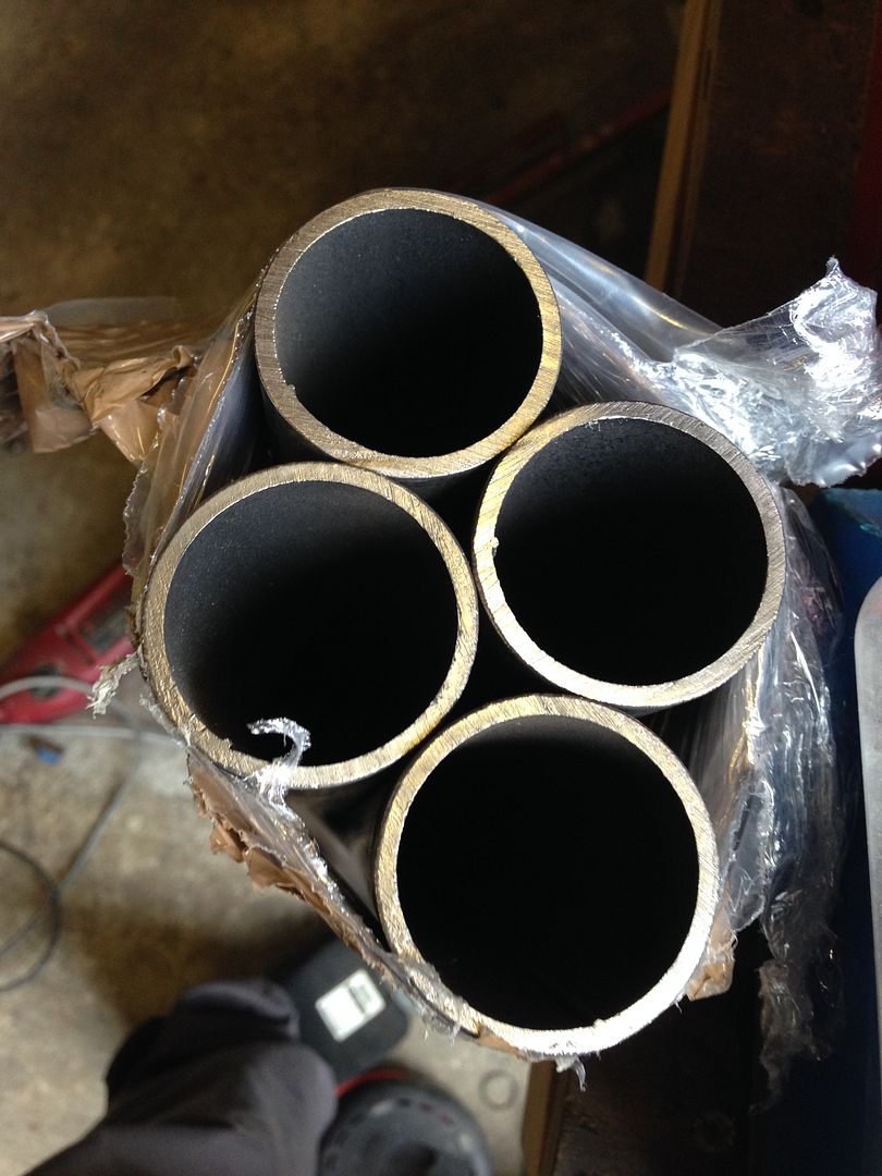

and my tubing also turned up for my rear strut strengthening

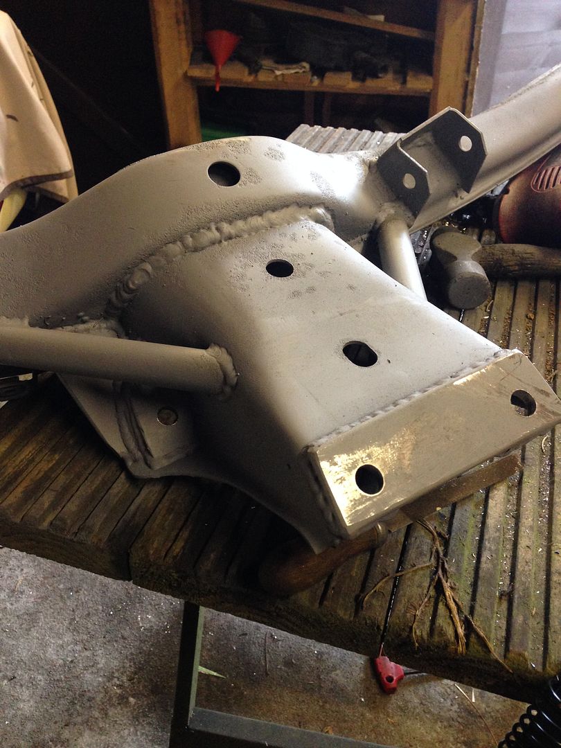

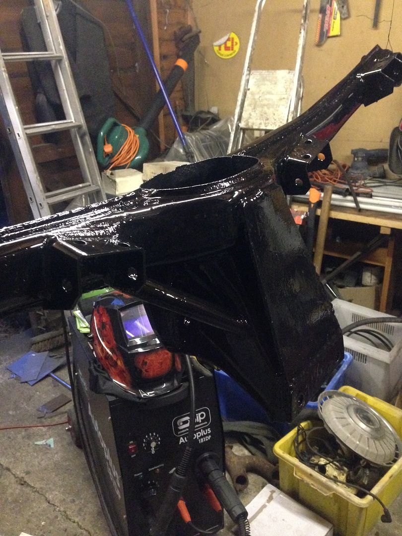

ross2009
Posts: 2762
Post Tue Jan 28, 2014 5:37 pm
got it painted looks ok not brilliant but it will do the job

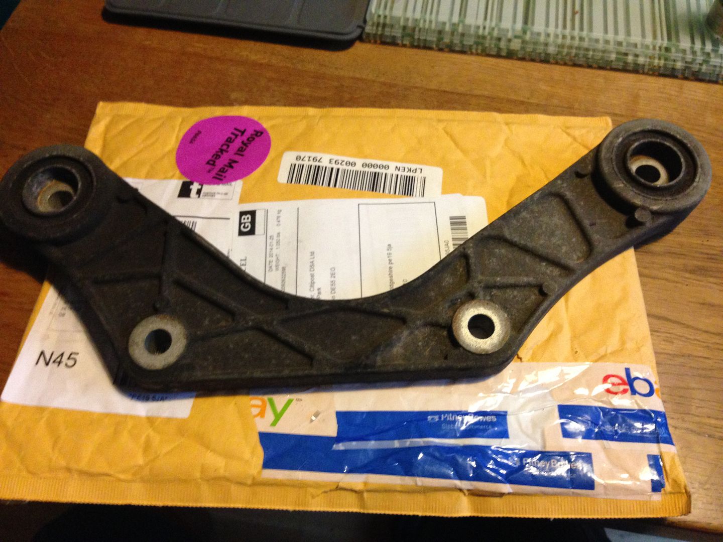

ross2009
Posts: 2762
Post Thu Jan 30, 2014 8:54 am
a couple more bits in the post today well just this morning anyway lol
