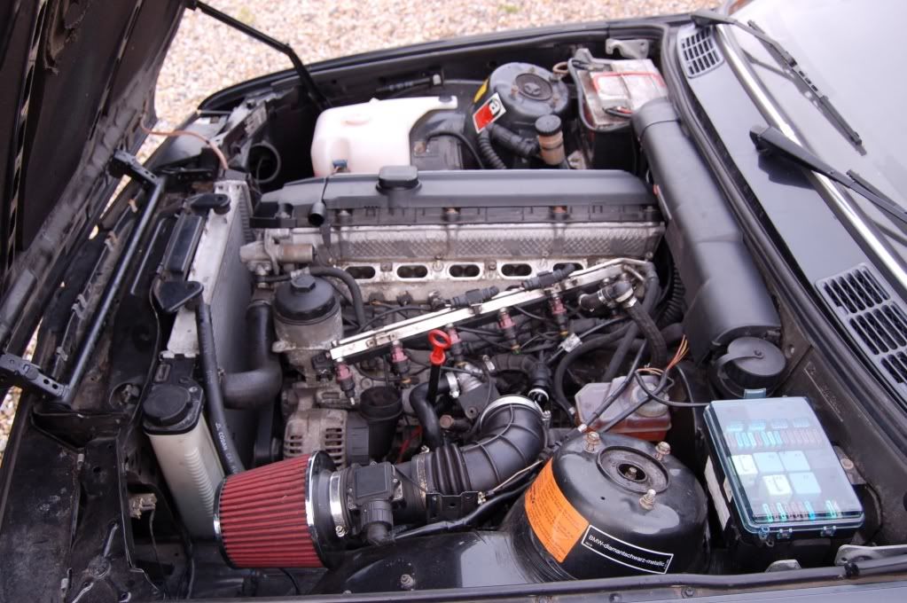

Had a fanny about with the car today in a bid to cure the niggly running problems.
It cranks for a fair while when trying to start it and you can feel it is a bit spluttery when you rev it slightly, it's not running "clean" if you know what I mean. it also seems to sometimes almost hydraulic when turning over and you get an occasion pop or backfire.
The fuel pump has been swapped and I've pinched the terminals in on the connector going to the pump which seems to have that behaving and I can't hear the pump failing when I jiggle the wires any more, but the problem hasn't gone away.

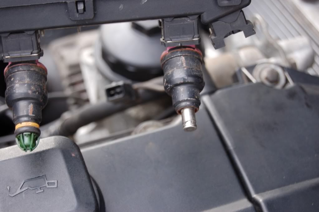

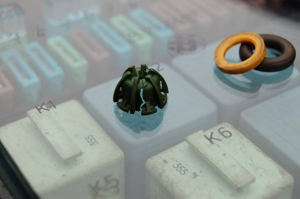

So I turned my attention to under the bonnet. Removed the cover that goes over the fuel rail first and had a look. Immediately spotted that the vacum hose to the fuel pressure regulator had snapped off. So I decided to pull off the inlet manifold and just double check everything under there and also set about making sure the hose from the ICV to the inlet manifold could be secured better as the connector on the back of the inlet manifold is a poor fit as the plastic tab had snapped off.
Pulled the injectors and rail off the inlet manifold and then noticed injector #1 had no green tip on the end and the O ring was still in the inlet manifold, great.
You can just about see the green tip sitting on top of the valve on the left in this pic, that was fun getting out.
Finally retrived that, it is cracked so won't be going back on
So I've decided that I'm going to send all the injectors off to injectortune for a clean and service. But spoke with Dezzy and being the stellar chap that he is, he is going to post to me his newly cleaned injectors and I'll send mine off for clean and service and send him mine when they come back. CR24V style

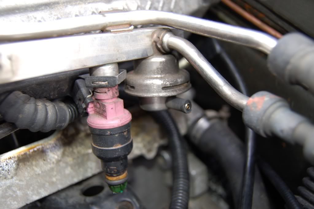

Here is the pesky FPR with the remains of the vacum hose around the pipe
So here is where progress halted after an hour or so of dicking around. Hopefully some fresh injectors and a working FPR will bring it back to good health as I'm planning on some 1/4 mile action next weekend and want that illusive 13

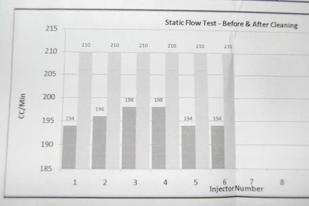

Got my injectors back from Injectortune today, good fast turnaround, posted them off Monday, back on my desk Friday morning.
I haven't got a scanner, so just took a pic of the graph on the report that comes back with them
The dark grey showing the flow rates as they were and the light grey showing afterwards, so hopefully an improvement will be noticed in the arse dyno dept.
