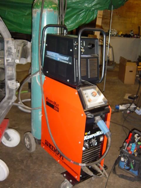

All i can say is WOW! looks good m8, i wish my workshop was half as well kitted out!!

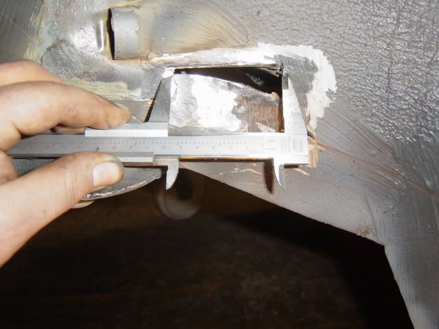

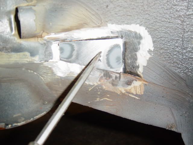

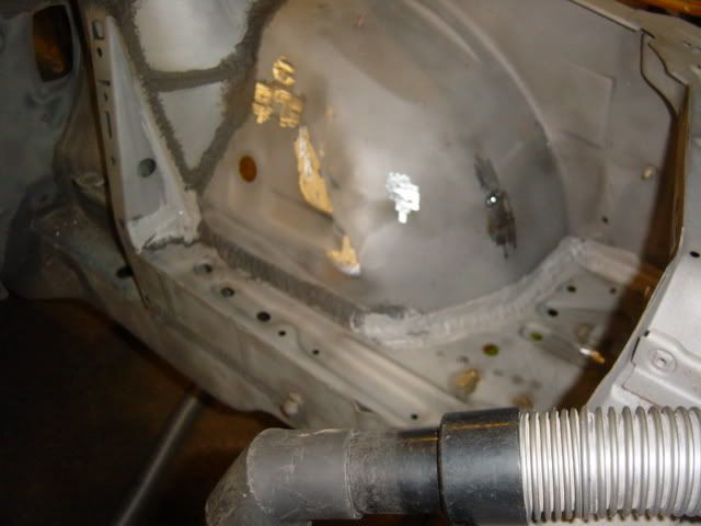

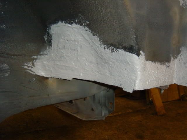

In the rear O/S arch below the breather cover panel there was a blister in the bodysealer, upon closer inspection there was a hole the size of a a 10p piece, so it was cut out completely:
The difference between MOT repair work and restoration is a vast, if I was getting an old nail through an MOT then a rough patch over the top with a bit of birdsh*t welding and some schultz would have done the trick. My standards are higher than that :D

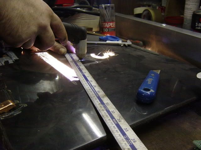

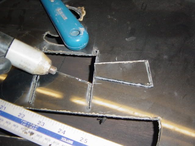

Didn't have any sheet metal around so used the old sunroof panel which is being replaced. Got to use my lovely Plasma cutter:
Then I ended up with a perfectly sized repair plate which would sit flush to the chassis material:
A little welding, here the Plasma, sat on top of the MIG welder:
Here's the result after a little grinding, filling and 3M brush on seam sealer:
That 3M seam sealer is awesome, it is the closest thing to the original BMW sealant used to blind the body joins. It builds up lovely and is waterproof, flexible and overpaintable (it also smells great). Anyone who has had to work on the bodywork on a E30 knows how tough this stuff is. I guess it's why there are so many E30's still around :D

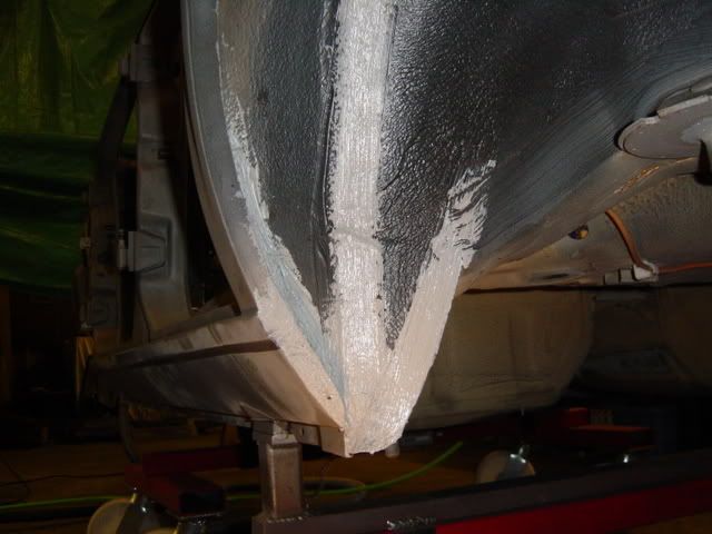

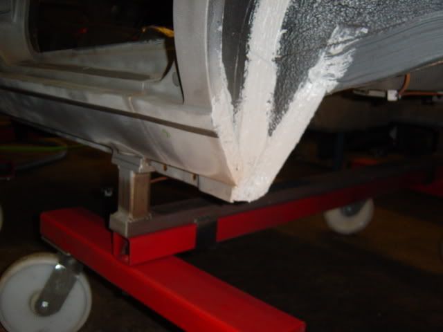

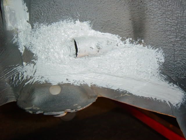

The last bit of welding was the O/S innerwing leading edge. The lugs that hang down had rotten away so I had to plasma cut, grind, weld and fill in a new section so that the innerwing plastics would still fix in to place:
The only other welding I did was to remove the grommet in the rear roof and plate it from underside with some metal and weld it in. I'm not sure if all tourings have a hole in the rear but this one did and it had to go! A quick skim of filler and it was done.
Most of the dirty making good was done except for grinding out any other blemishes under the arches and in the floor. I used an air die grinder with a domed TCT bit to break through that tough sealer and get rid of all the last traces of rust. Also used some more of that lovely brush on sealer to reseal the shell, this took a lot of time, making sure not to miss anything. I used blue stickers to mark any bits that I ground out as some were really small. That way I didn't miss any touching up. The inside edges of the arches also took a lot of time to make sure they were spotlessly clean and resealed:
Note my jig to hold the shell to the dolly frame :D

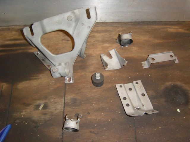

All that was left tonight was to remove all the underbonnet brakets for the airbox and ABS that weren't required:
All being well, without the ABS and all this lot I will stand a fair chance of getting the E36 M3 airbox in. The new airbox and expansion tank will require new brackets which I will make out of stainless or aluminium and bolt in with hex head stainless bolts. Don't want to ruin the new paint by welding :D

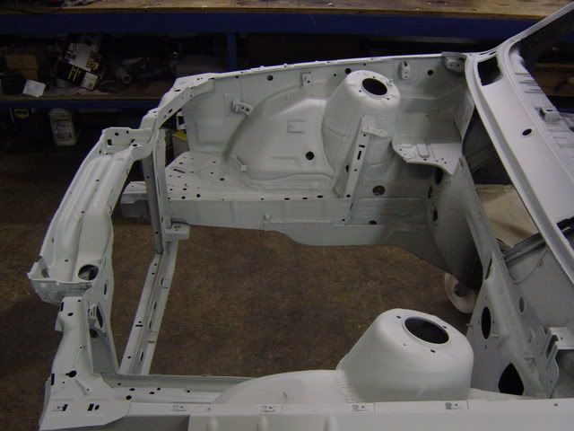

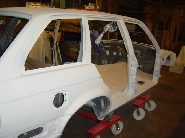

Sun Jan 07, 2007 7:21 pm

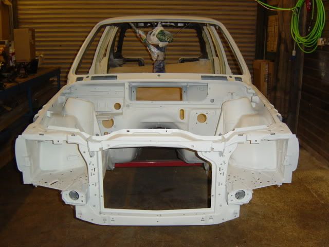

Well the hard part is over, the beast is now in primer! Just one coat to stop any rusting to the bare metal, I used Lesonal 2k etch primer.
I now have bare fingers, backache, hangover, headache from paint fumes, - and I'm still on here talking to my imaginary friends! N E E D B E E R :beer:

there are soooo many screw holes on the front of a E30!!!! 8O :D
it's all looking rather good though :D
