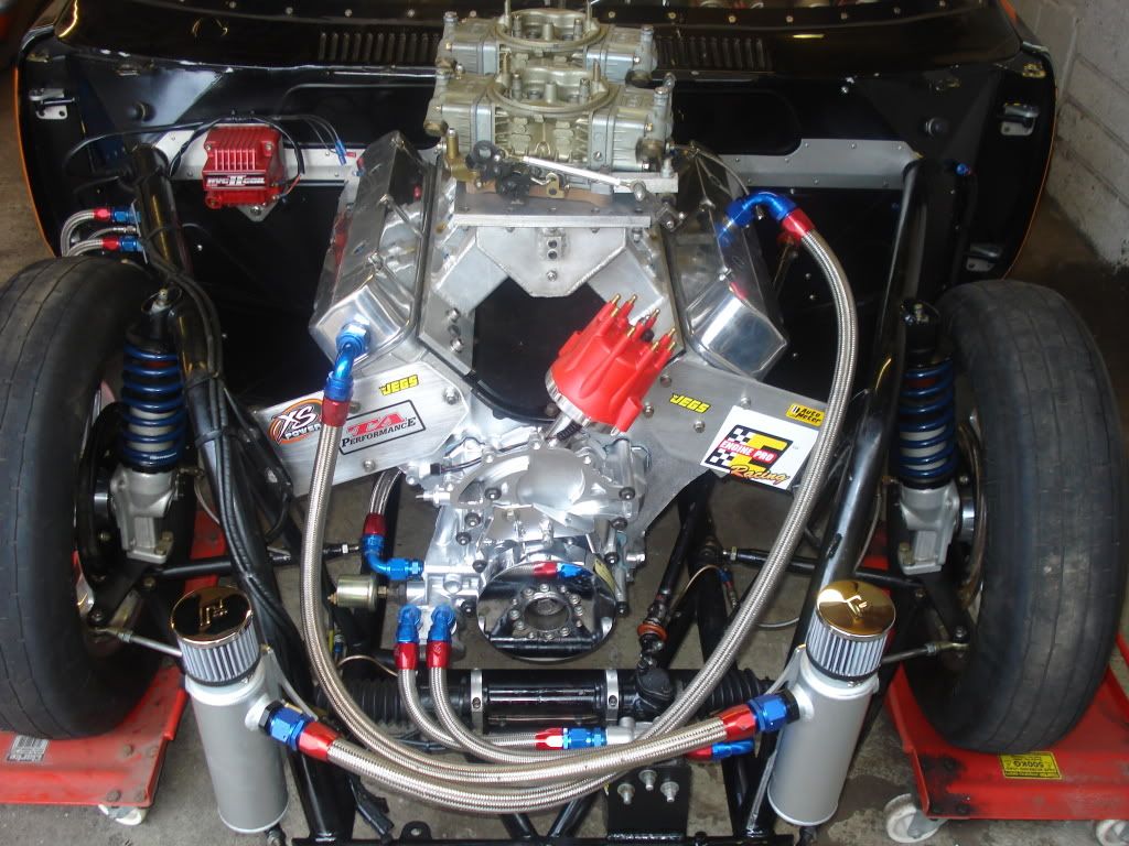

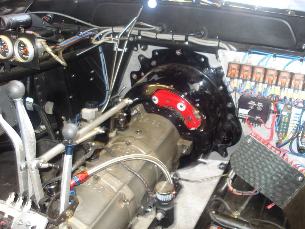

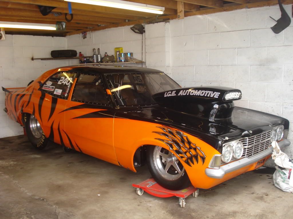

Bumped into Andy (Buster) up there, he was there with his mate Darren who was giving his new weapon a shakedown. It's going to be an animal when it's up & running properly, was running like shite today but when it's sorted on the methanol it will be an 8 second car

Is this the 5 foot E34 turd? it was at the pod 2 years ago, hideous effort 8O

Nothing quite like american muscle is there?
