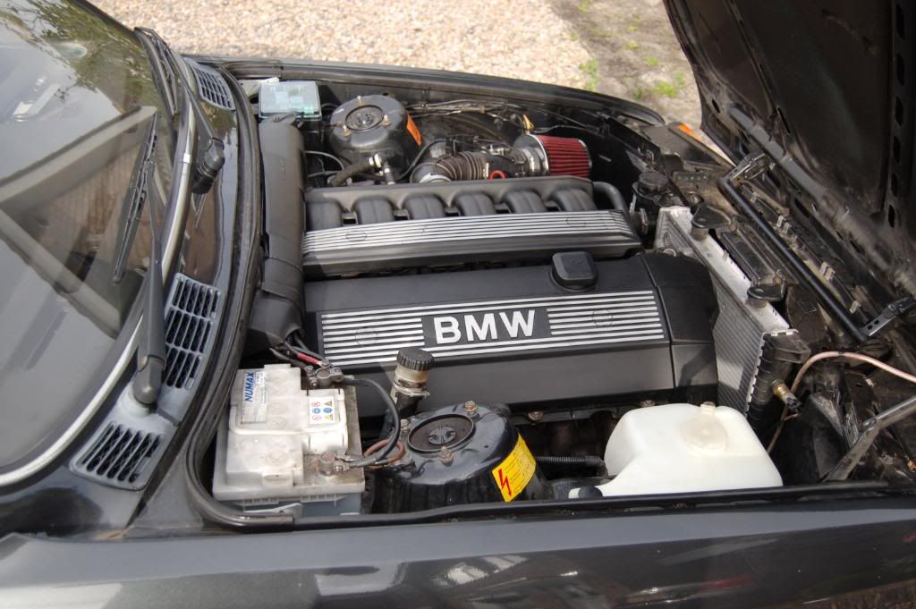

Looks like a very tidy engine install (especially compared to my M50'd E21 turd!), great job.

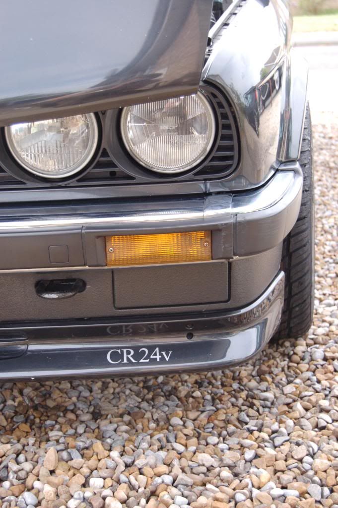

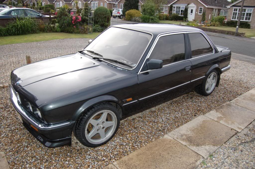

Well some progress to report my friends, she moved under her own steam today, well several times
First I sorted the exhaust system, the manifold and system mated up perfect with the euro sleeves, nice one Dezzy
I also did away with the DTM councilness, courtesy of the roughest angle grinder known to man and some hacksaw blades. It needs a tidy up to be perfect, but i like the subtle slash cuts I have created.
Bled up the clutch system, fitted the Z3 shifter and then got her on her wheels and moved back up the driveway so I can actually get the doors open properly. Fitted the M3 rear bench. The interior needs finishing off and a damn good clean, but it's 80% there.
I started trying to bleed the cooling system but must have an air lock as I'm getting no hot air at the vents. Got bored with that one and will come back to it. probably needs jacking at the front and I'm bored of jacking it up and the novelty of it sitting on wheels was too much to resist, so it had a very quick wash as a bit of a treat. Needs a proper clean and cut & wax but it managed to remove the crap that has been accumulating since November.
Anyway, I'm feeling pretty chippa as it's nearly there, couple of evenings and I reckon it's good to go.
Oh, defo going for some more spacers for the rear.
So here are the pics, click on them for full size.
Introducing Black Betty...........

That looks the nuts mate.
Is the exhaust hung properly? Is the bracket we shortened in use?
Them wheels look really nice and am loving the agressive stance.

Yeah it's taken what, 7 months to do this one compared to 2 years on the touring. Easy second time round just bolting up new parts.
The exhaust is mounted with the modified rear bracket mate, need a better rubber mount for the bit that hangs off the subframe.
Still got to wire up the electric fan and of course bleed the cooling system properly. Strut brace still to fit and I'll probably give the brakes another quick bleed just for the sake of it.
It worried me earlier by smoking a bit out of the exhaust, but not sure why that was
It is not doing it all the time.
