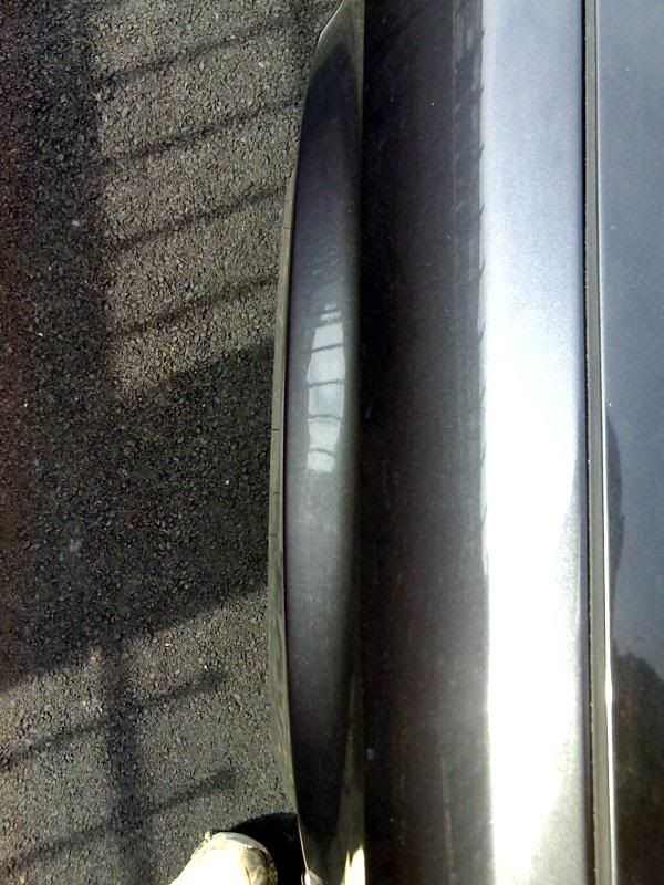

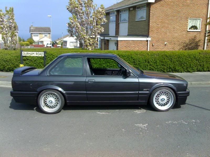

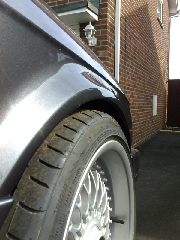

right heres the pictures.
Car with suspension settled,not so bad now :
I think its still sticking out too far.Im going to try 3mm spacer i think.
Id say its poking out 5 mm.It would be perfect if i could bin the spring.
What do you think,can i leave it off ?

Andy,
Not being an expert and all that, but Sandy's pic shows the wheel far further in than your pic. If they are the same ET20 offset and both are running M3 setup and eccentrics I can't understand it either :banghead:
Forget the tyre size, concentrate on the wheel rim. They are clearly different. Even more toe in wouldn't sort this out surely?
I can't for the life of me see that losing the caliper backspring will do any harm other than promote a little more squealing. I guess that's what it's there for having studied the caliper.
Just thought - What about disc thickness?? Are they M3 discs. We're talking about pads being thicker but a thicker disc would cause this too.
Either way I'd be inclined to get the arches rolled and maybe surface the pads if all else fails.
Sincerely hope you sort it out mate,

Andy, they dont look like they stick alot further out than mine.. I'll take a pic when im back home over the w/end..

The difference from what has been said and the pictures that
have been posted are that the Touring has
Fixed Negative Camber top mounts and the Coupe has
standard M3 ones.
The Negative camber top mounts are fixed at 1.5 degrees negative
camber which will lean the top of the wheel in a few mm,
and make a 215 tyre, just inside the arch.
Toe in or out has nothing to do with camber.
If your wheels are BBS ET 20, then 215 40 17 with negative camber top
mounts should be just inside.
However, when you add the spacer it will push it back out again.
I would run with the fixed negative camber top plates, C3 BMW, stock
them, and then you may need a thin 2/3mm spacer for Caliper clearance.
Many of the M3 Guys file down the caliper springs, and I even believe
that somebody in the States sells modified ones.

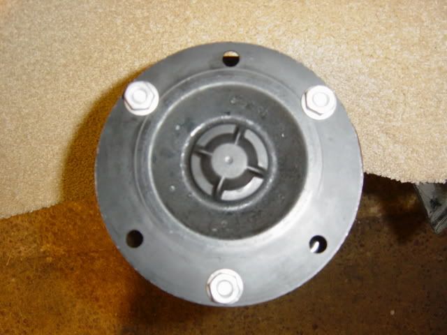

Post Fri Apr 20, 2007 7:04 pm

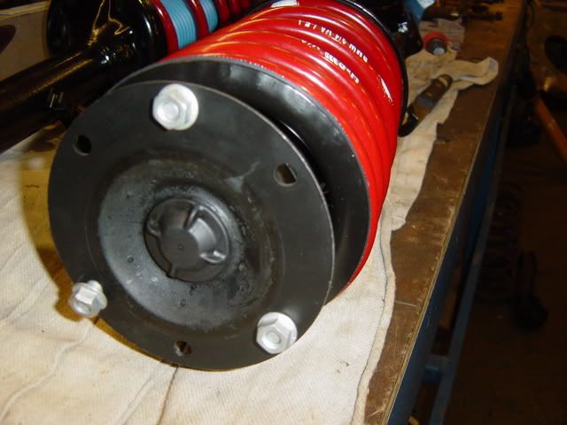

Andy,

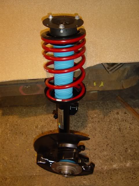

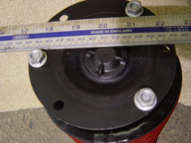

From what I have read and experienced, E30 M3 and saloons/coupes/tourings all share the same top mounts. P/n 31331139452.
There is also an eccentric top mount manufactured with six stud holes instead of three that can be rotated 180 degrees. This will add more or less camber 'around' the standard fixed position. P/n 31331139484
I have bought these and fitted them to mine.
EDIT: sod it, out to the workshop with camera. Here you go.
If you use these to add more -ve camber then this will likely cure the problem. Don't forget that the studs have to be ordered seperately P/n 31331092886 and nuts P/n 31331092887, you'll need 6 of each.
HTH

Pretty sure I have the 6 hole top mount as I remember a bit of fannying about when fitting them.
when you look at the strut top from the engine bay id doesn't sit in the middle.....hold on, i'll take a pic!......

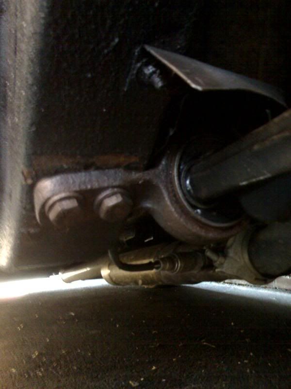

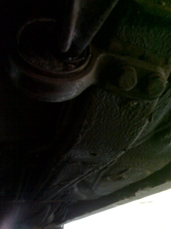

buster
Posts: 3779
Post Sat Apr 21, 2007 10:33 am
Thanks every one for your help.It would seem that my top mounts are the normal ones.Looking at Dameon and Sandys set ups,you both have offset top mounts.
I've definately fitted the eccentric m3 control arm bushes the correct way.
offside :
nearside:

buster wrote:Well theres only the rubber in the top mount and i think its all one piece so you'd need a new top mount.I'd check see if the big nut on the top of the damper is tight or the bottom ball joints and anti roll bar links are ok if your getting a knocking noise.
Yep, Andy's on to it. That big nut on the top of the damper has been responsible for this exact same symptom on mine before.
Andy, that top mount in Sandy's pic looks just the same offset as my eccentrics. OEM dealer kit for the these mounts bud (P/n listed above iirc £40 ea.)
I reckon that they might just cure the problem with some careful wheel spacing too.

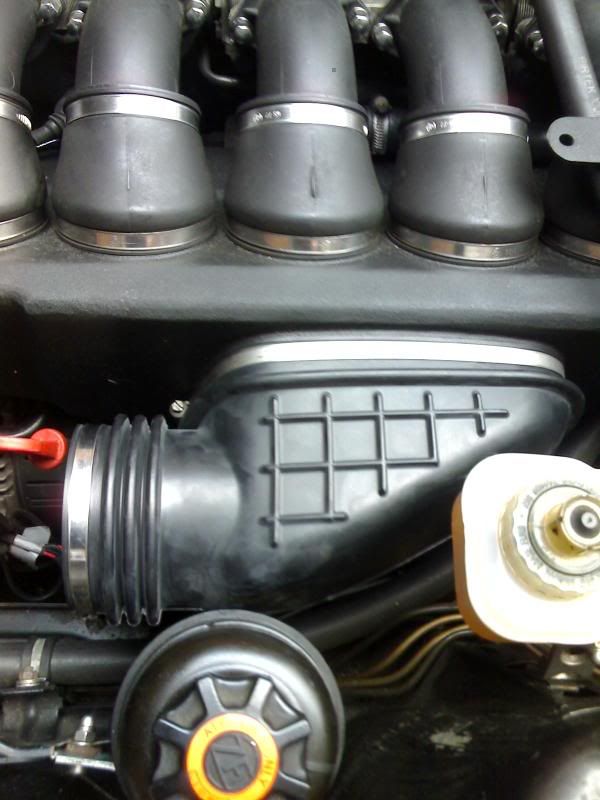

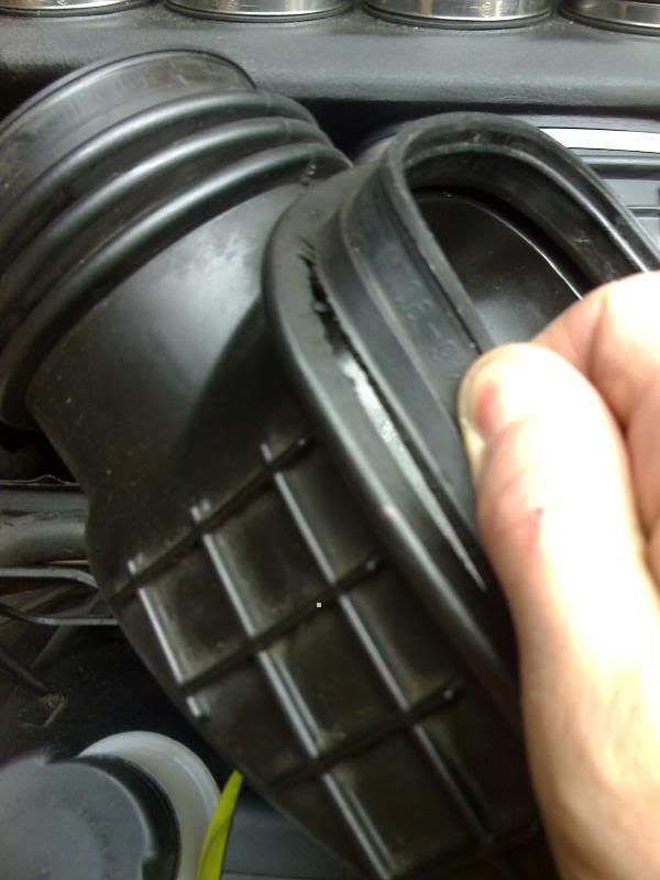

Had to change the intake boot on mine today as mine developed a crack.
Nice new one in place :

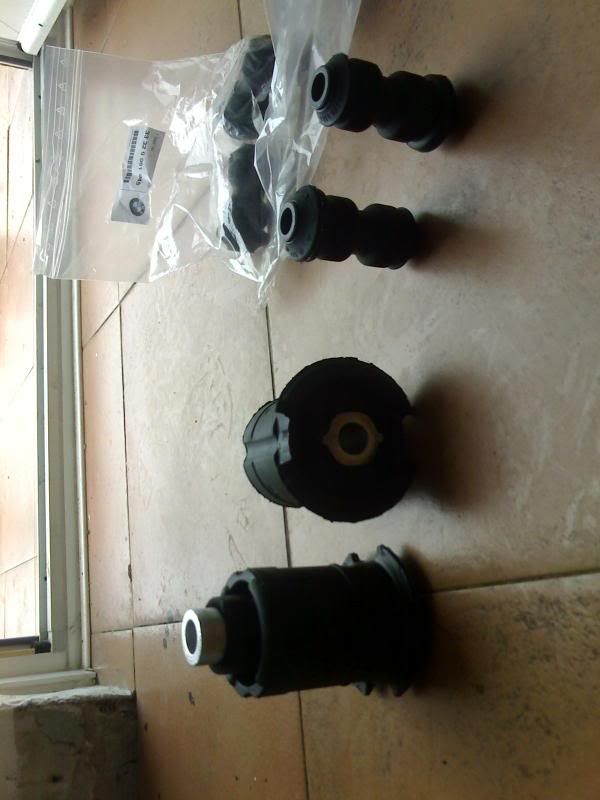

Bought some new bushes also for the subframe and trailing arms.

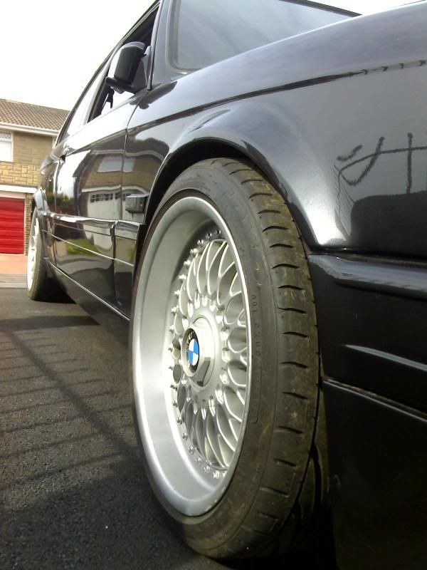

Post Sat May 05, 2007 4:58 pm
Right,heres a pic of it with the 5 stud rear on now !
Those 245 35 17's just clear !

Cheers guys,i would have responded sooner but im not receiving e-mail notifications for some reason :roll:
Wheels are 8j 17" et20 with 215 40 17,and rear is 9j (cant remember offset) with 245 35 17.
