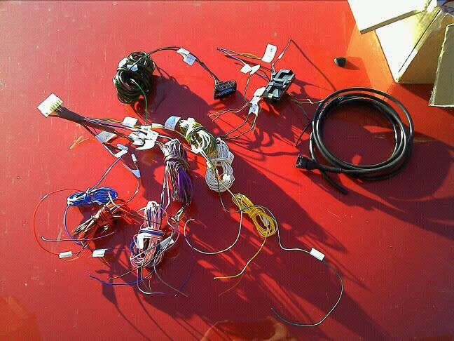

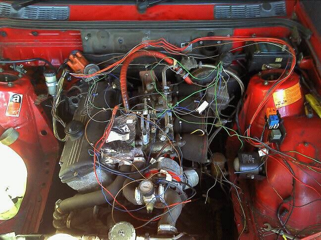

Ive got a MegaJolt mappable ignition kit which im wiring in.
Mess of wires waiting to be loomed once the igntion wires are run.
Ignition wiring made up and labelled ready for fitting on the car.

The ignition system is all in and working. Its tucked away in the garage for winter now but will be coming out for a full tune up in the new year.

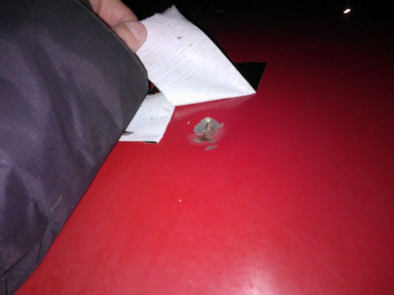

Heres a pic of the damage
its poked a whole right through. luckily the roof lining is already out as I've been looking at the sunroof rust. Thinking about going for a carbon roofskin.
