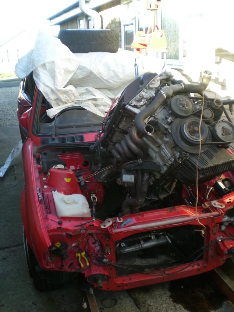

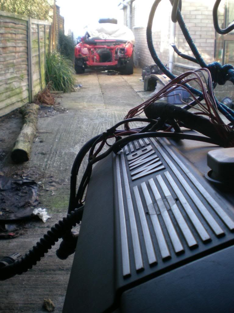

Well today with some dry weather I got my arse in gear and got the engine & box pulled, servo removed also. Got the passenger seat out but the driver seat is firmly wedged in there. I'm going to need a hydraulic ram to push the door & b post outwards. I tried kicking it out myself by lying across the front and pushing with my back on the passenger door but it ain't moving.
Numerous cuts to my hands from all the glass all over the place inside. Oh the joy
You can see my "massage" work on the corner of the bulkhead here for the S50 manifold

how did you find the s50 manifold worked, in terms of performance ?
good to see you're making progress

I've got no yardstick to measure the S50 manifold by Kos, I always had this fitted so can't say if any gains are there over a chopped up M52 manifold. The size of the primary holes in the flange are a fair bit bigger than the outlet ports on the head. It certainly made a good bark when under load.
It was a bit too loud with the sound proofing removed around the transmission tunnel and it really does give off some heat so I'm going to wrap the manifold I think.

Good plan mate I am doing my m52 one. I do like your manifold like and it did and will again make a lovely noise
- Posts: 16806
- Location: Norfolk
the only other possible problem with the S50 manifold is I honestly don't think I can get an E36 rack in there, which is a major downer as I really couldn't believe how slow E30 steering is

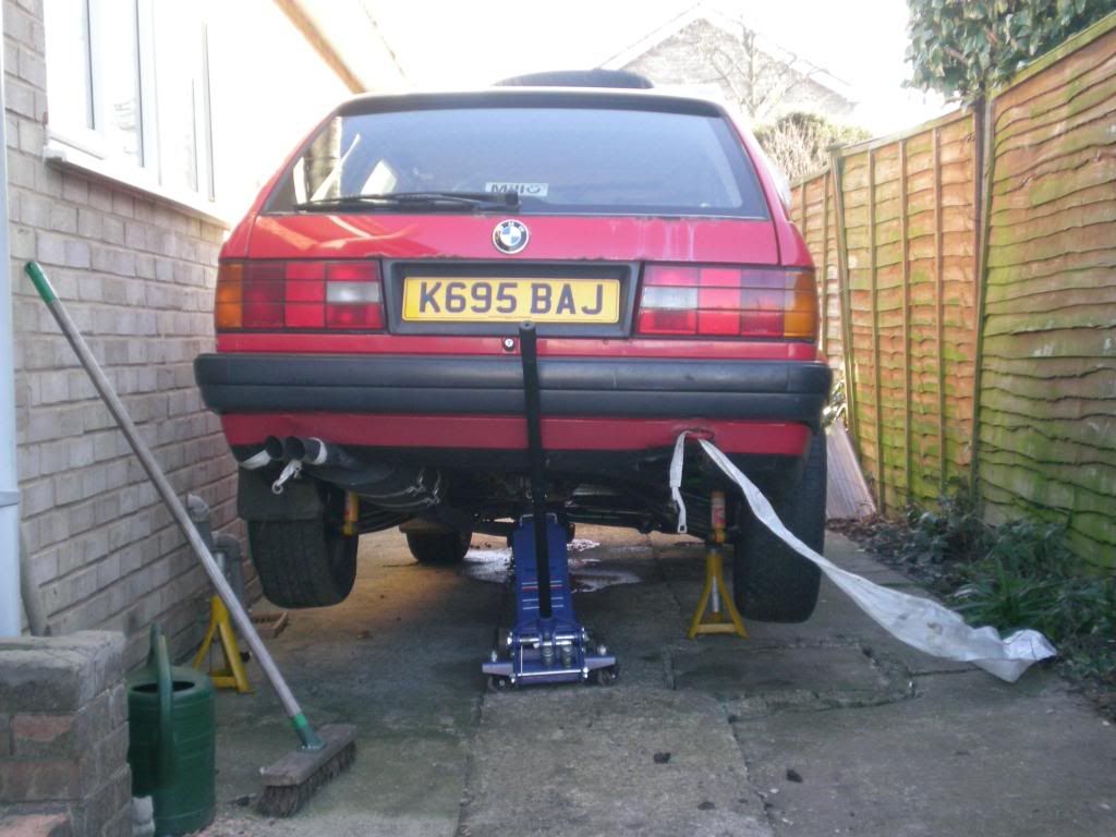

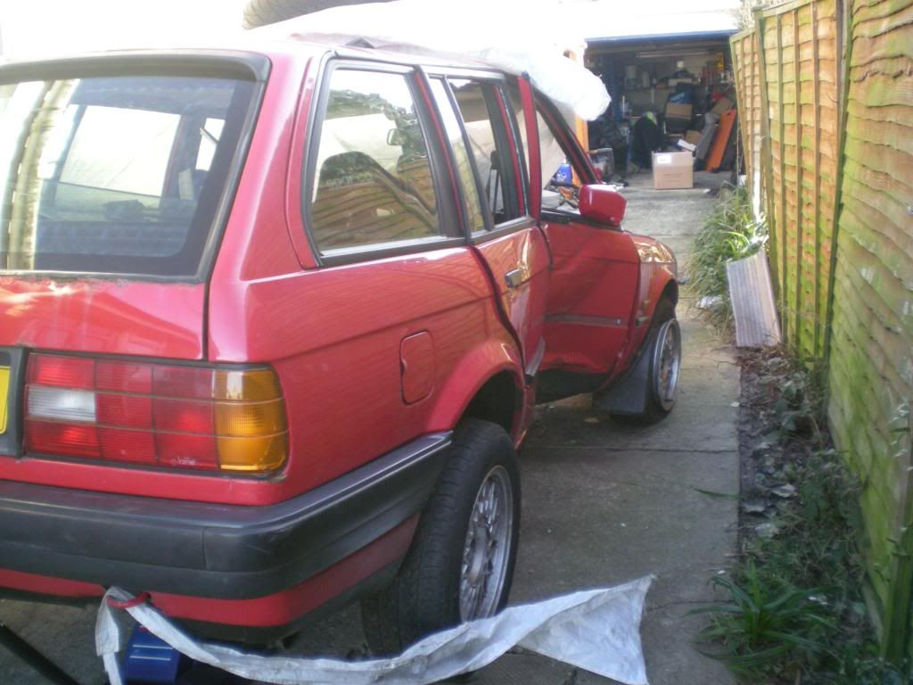

How are you going to rape suspention off the touring lee?
Are you going to just swap it straight over? Maybe just look for some 40mm rear spring and leave the fronts built up. If you put the chromie gear back on he touring least it's mobile?
Bet you feel better about it all now mate
Dan what is likely to have the right diff?
- Posts: 16806
- Location: Norfolk
I reckon it'll get winched onto a tilt bed or the hiab will drag it to it's death.
Gonna get another pair of axle stands so I can have both ends in the air, then once everything I need from it is stripped off, it'll get dragged along the driveway

from the rear shot, it doesnt look 'that' bad!
