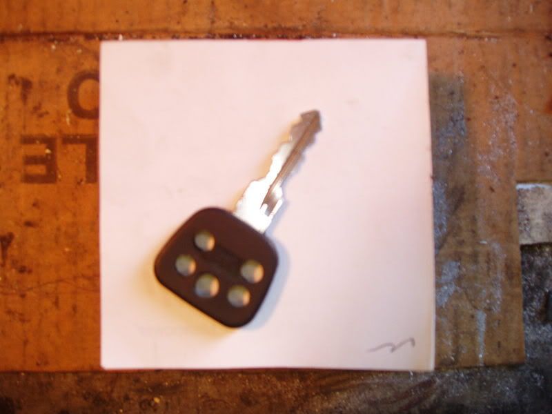

How's this for weight saving!?
Just like a 1970 Porsche 917 LeMans racing car!
