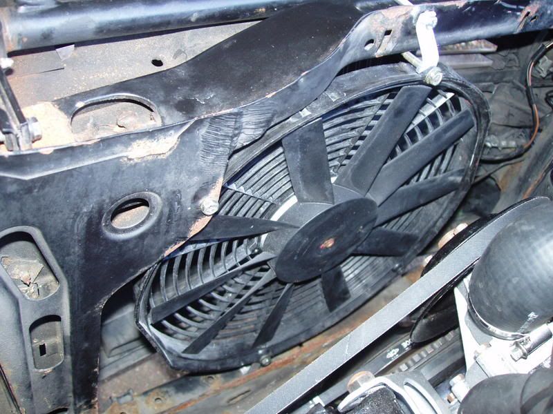

Made two more small aluminium brackets to support the electric fan, it was a pain with it cable tied to the radiator as there isn't room to remove them still fixed to each other!

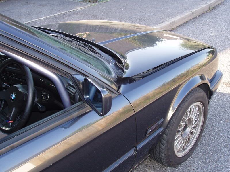

While I was thinking about cooling I was thinking of bonnet vents, then I thought of this -

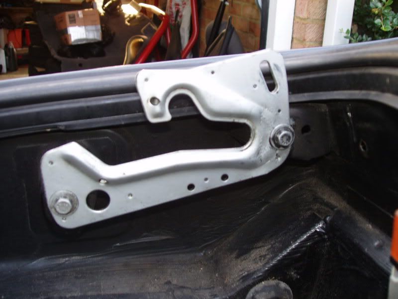

Just flattened a bit of the raised part and drilled another hole in each bonnet bracket thingy to achieve this -
Bonnet still locks into the catches at the front ok. I won't leave it like it but it takes two minutes to change the bolt holes so might do it for when I'm sitting in the queue for the strip at Sant Pod!

i like the bonnet mount mod. i thought of this and suggested it to toby_unna a while ago when he was having underbonnet heat issues and i reckon it looks well street-racer!
what fan is that you've got? fits well.... :D

The fan is a Spal 13". I used two small bits of thick aluminium and a hole that was already in the front panel - I think for the original plastic fan shroud. Minimalist, lightweight, easy, virtually free (a mate gave me a piece of ali) and effective!
I must admit I was quite chuffed with the bonnet mod - so simple and free! Haven't seen it done to an E30 before, bet it has been though!

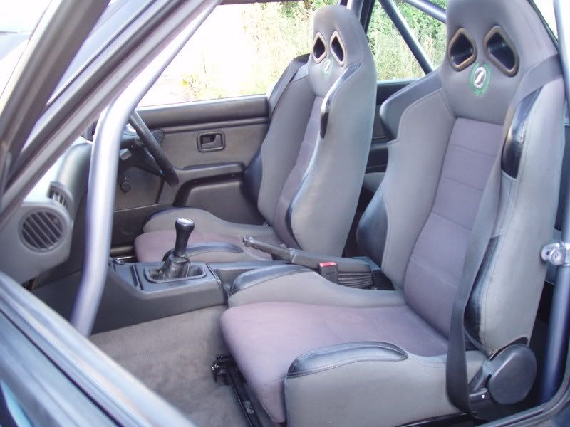

Got the Corbeaus in though.

did you get the sears from corbeau directly? until the other week, they were 2 doors down from my work.

Got the seats off Ebay months ago, they were in an E30 so subframes were already on them!
