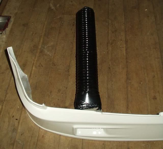

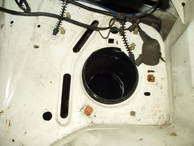

Got my cold air intake done today. I am running a Foam Unifilter Pod Filter so I have the best of both worlds - good flow and excellent filtration.
This is the tubing coming off my Alpina spoiler - I now have vented brakes so I am using the brake vent inlet off the spoiler.
And as I am not running air-con now I have been left with the perfect hole to pipe the cold air up into my cold air box - this is where the air-con dryer used to sit. I have a temporary cold air box which is a 20litre plastic drum cut down to fit into the space and shielded with aluminium heat shielding around it until I build my carbon fibre one.

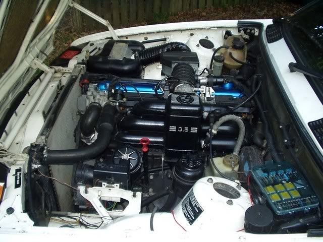

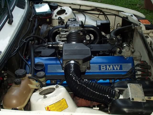

I wasnt going to post pictures of the under bonnet until I had totally finished it - but who knows how long that is going to take me now that I have heaps of around the house jobs to catch up on.
This is the from the drivers side. You can see that the heat off the exhaust has distorted the intake tubing. I bought a heavy duty one today and will make a heat shield to put under it. I am also going to get my exhaust manifolds ceramic coated. You can see my dodgy temp cold air box - but it is doing the job until I finish my carbon fibre one.
And this is from the passengers side.

Have you thought about using the M30 air box ?
gareth
- Posts: 11005
my M30 (e32) airbox fits a treat. i cut out a lump of the plastic trim from behind the headlights and poked the original E32 air inlet hose out through the front so it gets a cold air feed. this airbox also has an integral heatshield and looks totally factory installed!
there are aftermarket panel filters available from GSF for about Ԛ£28 too
